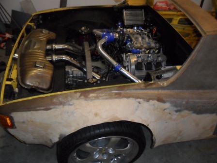

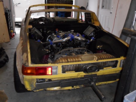

engine

Hard to tell from the pics... Audi 2.7 w/ 6speed gearbox and boxster suspension?
What are those monster tires you have on it? Looks like you need more fender (IMG:style_emoticons/default/biggrin.gif)

Looks like an Audi unit to me. Not sure which one, but the oil filter placement and oil pan kinda gives it away.

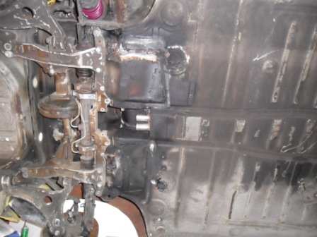

964 front suspension and fuel cell

-Engine is the 2.7 tt from an audi s4 with a stand alone ecu.
-Trans is a 5 speed boxster trans (audi 012) with boxster cable shifters
-Muffler is from a boxster S and chopped up
-The front and rear suspension are off of a 993 w/H&R springs
-Fuel tank is from a 964
-The Sc flares had to be cut off to accomodate the new stance and we have 930 flare to replace them.
-Car is a roller and the engine has been running in the chassis. Still working on completing all of the plumbing. I will post some updates on a thread in the future as work and family is slowing progress.

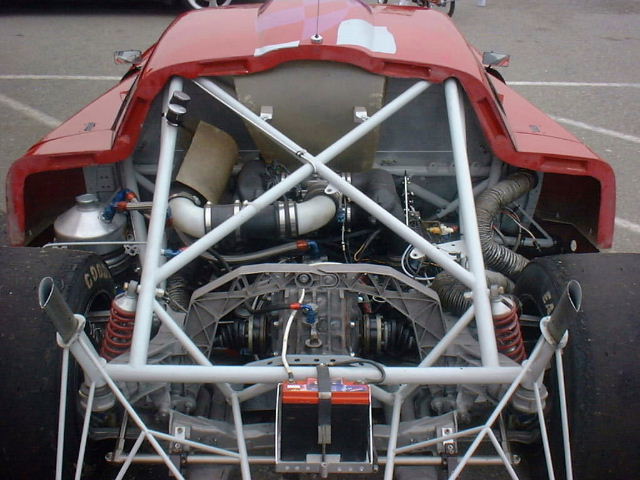

Here is the Mistak rear

It is pretty cool how well that 993 suspension fits.

excellent work!! true, that 993 suspension fit's extremely well!

I have seen photos of the Mistak car before. It is a nice race car.
My car is going to be a grocery getter and sunday driver. I think that it will be a very refined driver with the modern engine, suspension, power steering and power brakes.
