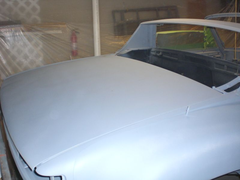

been working on my project for awhile now,, read a long time!!!!..latest update..she's not naked any longer...2 years of bare metal and now I started spraying...... First time.. I'm handling the primer on my own.. (IMG:style_emoticons/default/wacko.gif)
Bigkat is traveling for work or some lame excuse!! (IMG:style_emoticons/default/beer.gif)
He will be handling the final hot rod black..

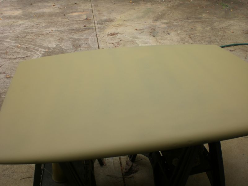

acid etch primer and the gray primer

primed, sanded, bondo'd, trial fit the rockers, primed and I'll probably sand some more...I think Im slowly getting this body work thing..
The rockers are close.. I need to trim a little more metal and a second pair of hands would help with final placement of the flares..
