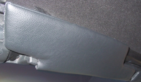

I like mine with the seamless look (IMG:style_emoticons/default/biggrin.gif)

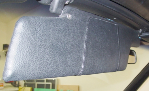

I'll try to get a picture of the other side tonight.
