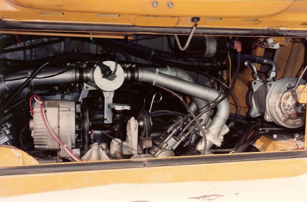

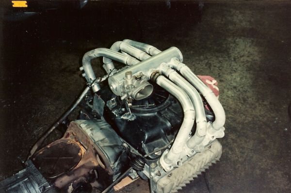

Let us pontificate on the future of a CIS system on this mill. In my research I have found at least one other individual that had attempted, futilely, to put both a Corvair engine and CIS into his bus. This resulted in no improvement, crappy running and decreased, abysmal fuel mileage.

Why do you think this set up didnt work?

Hard to say from those photos but where is the fuel distributor? Biggest issue with CIS as I see it is fuel pressure and learning how to set it at the WUR. It took me years (really) to figure out why mine was all over the map. Vaccum is also an issue.
REfresh me on what parts you are using for your CIS. 911 stuff?
I never worked on CIS before my Alien build. There are three guys in town that have CIS experience. Two of them are the exclusive Volvo guys. The other guy is a Volvo, Ferrari and VW guy. I couldn't even pay these guys with an open check book to help me or take the car in to tune it. If I can help you I will. CIS is easy once you get the fuel pressure set.
PS: don't bother messing with the adjustment at the fuel distributor. It is for fine tuning only not for fuel pressure. Every CIS guy here in town came out to the car with a long allen wrench and dicked with the dizzy adjustment only to foul it up more than it was when I brought it to them.

Thanks for the call, Rick. I have considered that the guy whose engine is pictured above did not know exactly what he was doing.
My intentions are to make a plenum that is closer to the fan, and shorter down tubes. I am not sure where the injectors are going, yet, but this guy may have them too far away from the valve which would cause a rich running condition.
Things that I considered with this guys report, if all pressures and plumbing were correct:
- Injector location
- Plenum and down tube volume (his look large). Too large and response is slow, too small and response is erratic.
- System used. I am not sure what he got his CIS out of.

Problem #1 :
he used a 924/audi t.b. that was designed for a 2.0 liter 4 cylinder
Problem # 2 :
The runners a REALLY long for a 3.0+ engine thus creating more top end h.p. than low end that a bus really needs
Problem # 3 :
The T.B. is effectivey at a 180* bend to the runners thus creating an extremely awkward flow into an already lenghty runner
Problem # 4:
In my experiecne most people DO NOT know hw CIS works and DO NOT know how to set it up and " tune it "

Sheeze! That's what me and Doc were talking about today. (IMG:style_emoticons/default/laugh.gif) That plemium is too small and the throttle body is in a very weird place. The 928 is directly under a very large plenium aith a direct connection to the fuel dizzy.

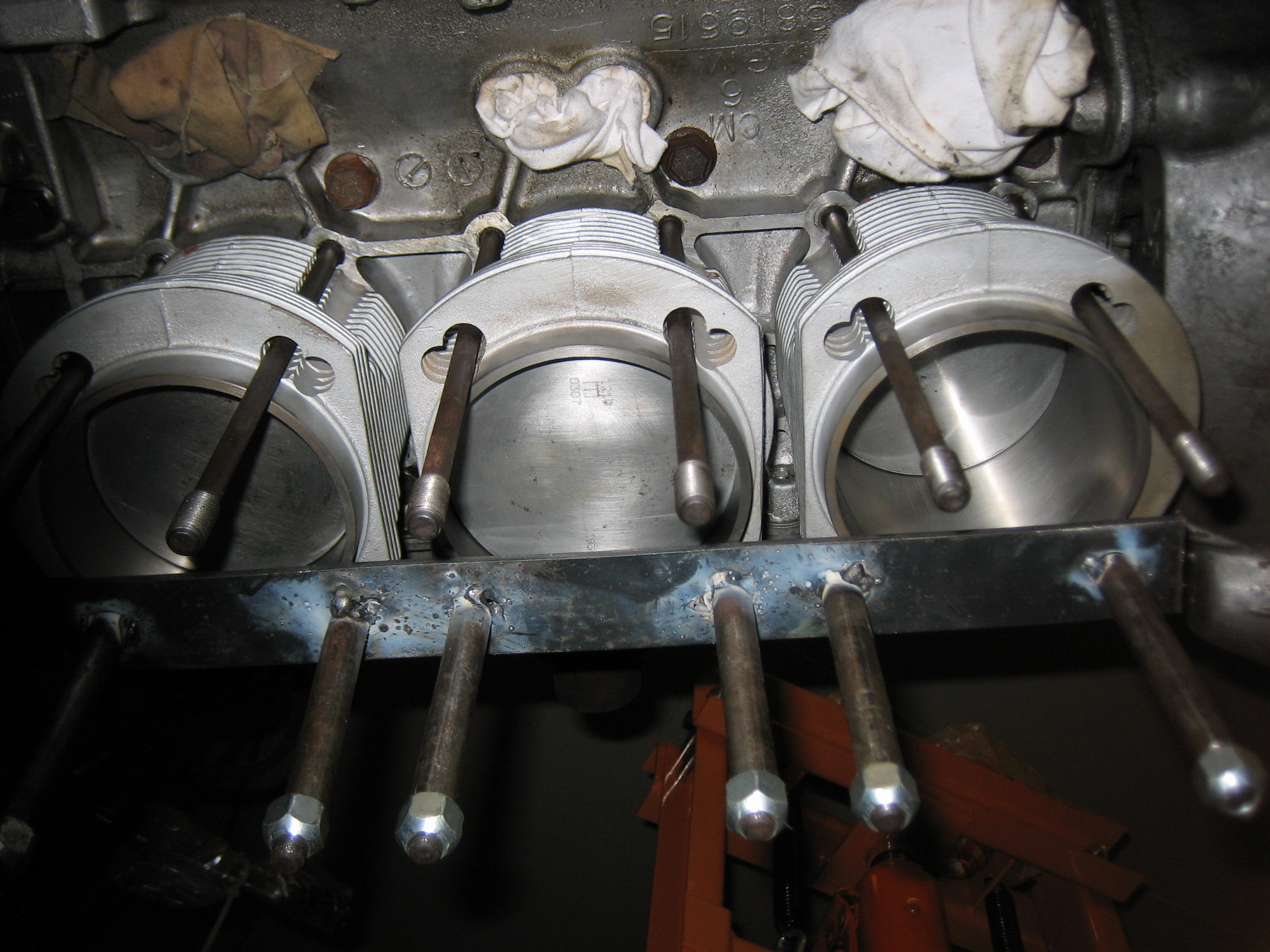

Every time you let a project linger, you loose things (IMG:style_emoticons/default/dry.gif) I did some work today on the engine, sort of. I made a fixture to hold the barrels in place today so I can work on the other side while I await the return of my other head.
I got the other 3 pistons cleaned up and then I could not find the damn clips for the rod pins (IMG:style_emoticons/default/dry.gif) Looks like I will have to source some more (IMG:style_emoticons/default/headbang.gif)

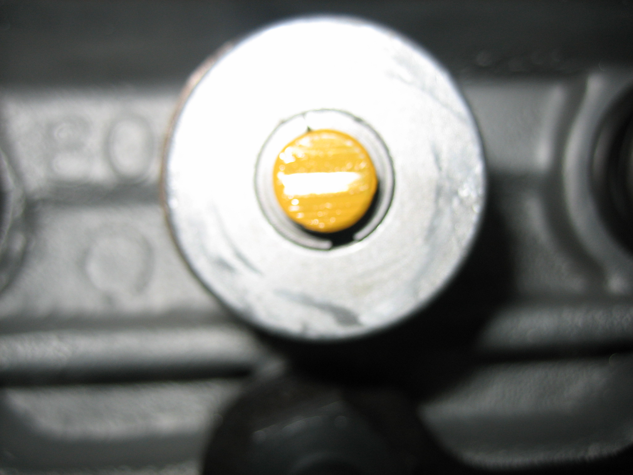

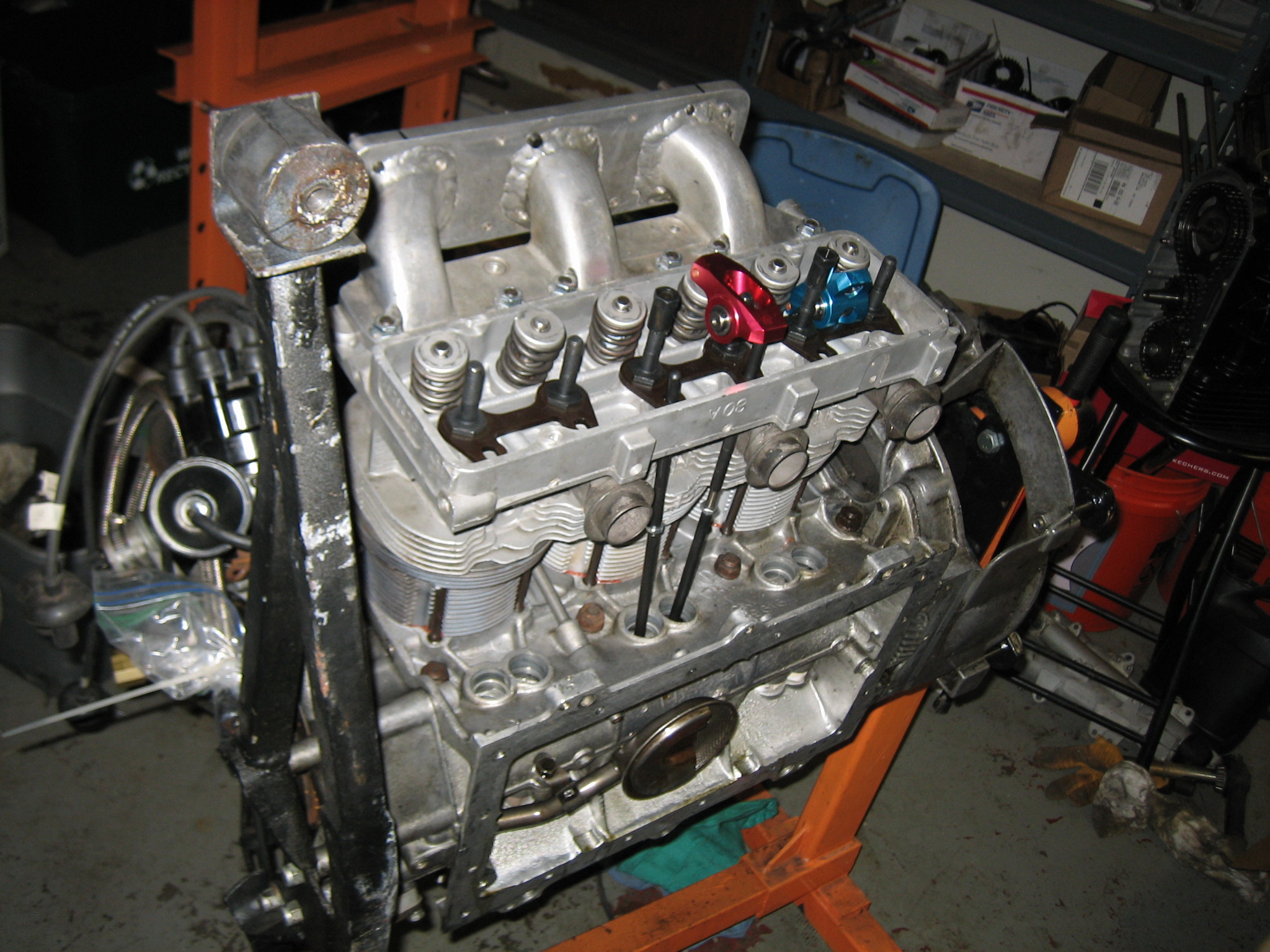

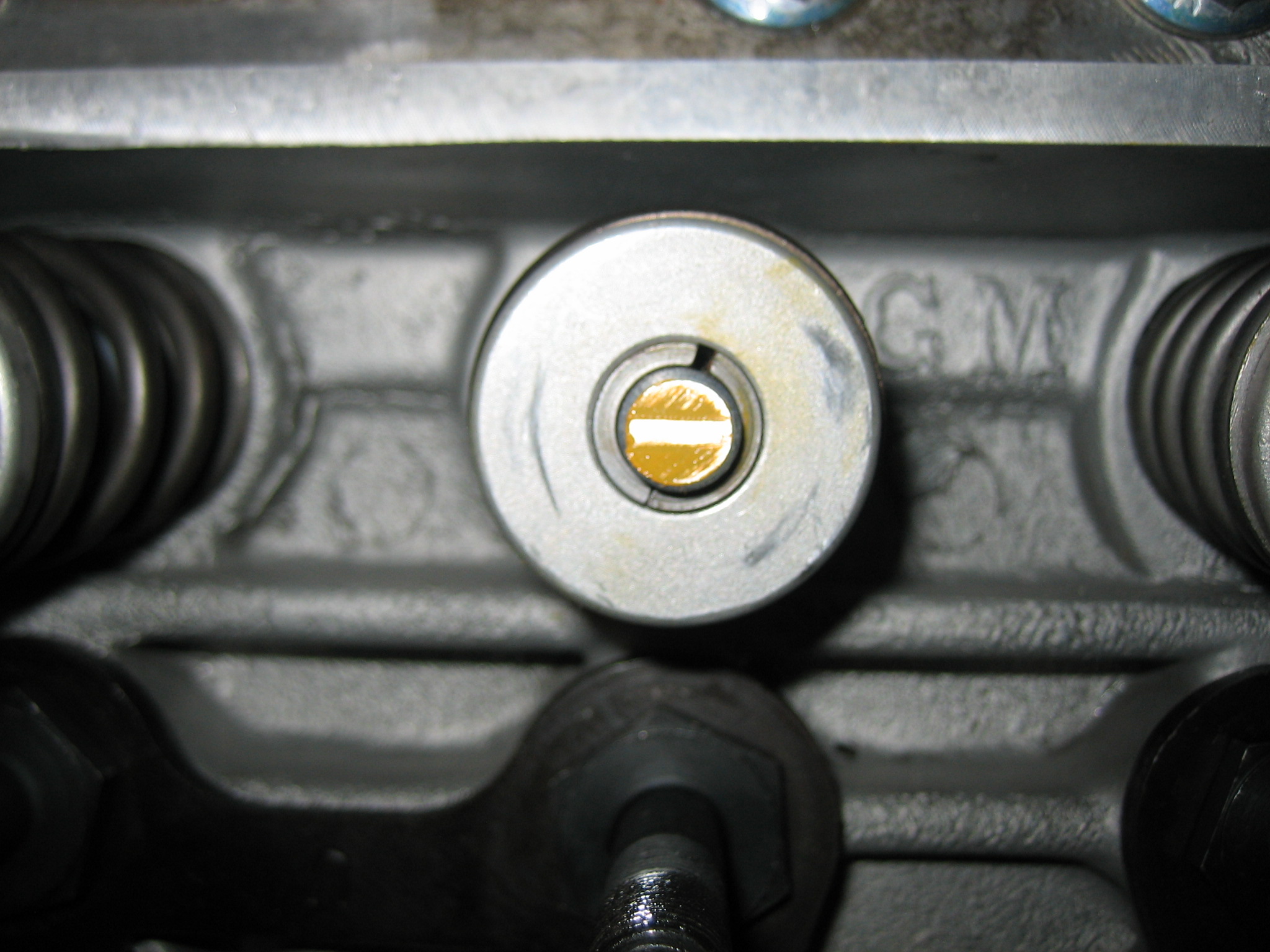

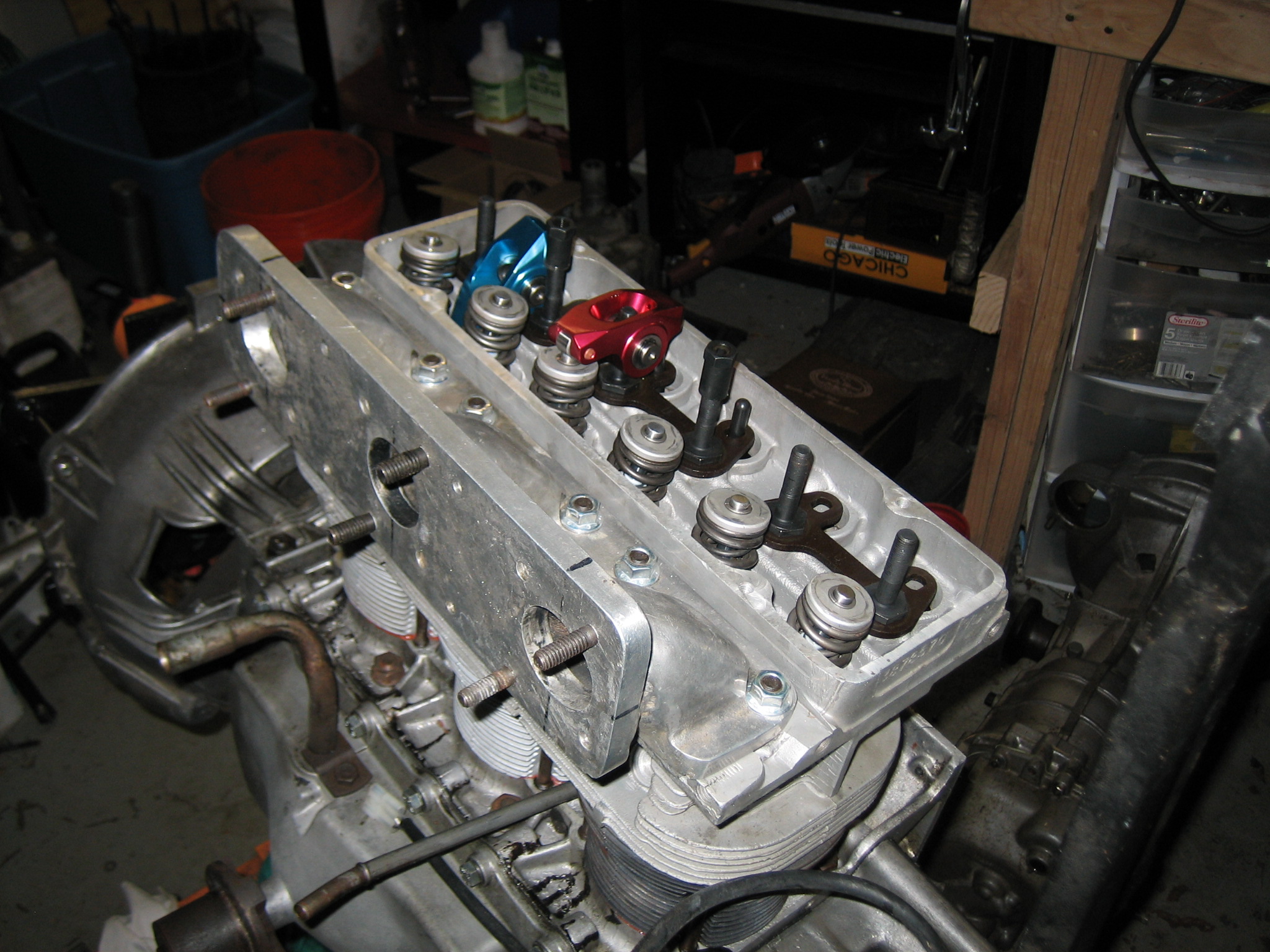

I found my clips for the pistons so I installed the P/C. I checked the new deck height and it is 0.063". I rechecked a chamber on the head and it was 50cc. I installed the head and began working the rocker geometry out (IMG:style_emoticons/default/smile.gif)
Dr Evil
post Jan 31 2012, 06:00 PM
Post #1118
Send me your transmission!
Posts: 23,044
Joined: 21-November 03
From: Loveland, OH 45140
Member No.: 1,372
After very little trial and error, the pattern was perfect and the rod length locked in (IMG:style_emoticons/default/smile.gif) Now I need to wait for the other head to come back, and to send these rods off to be measured and matched. They are longer than stock by a bit.
