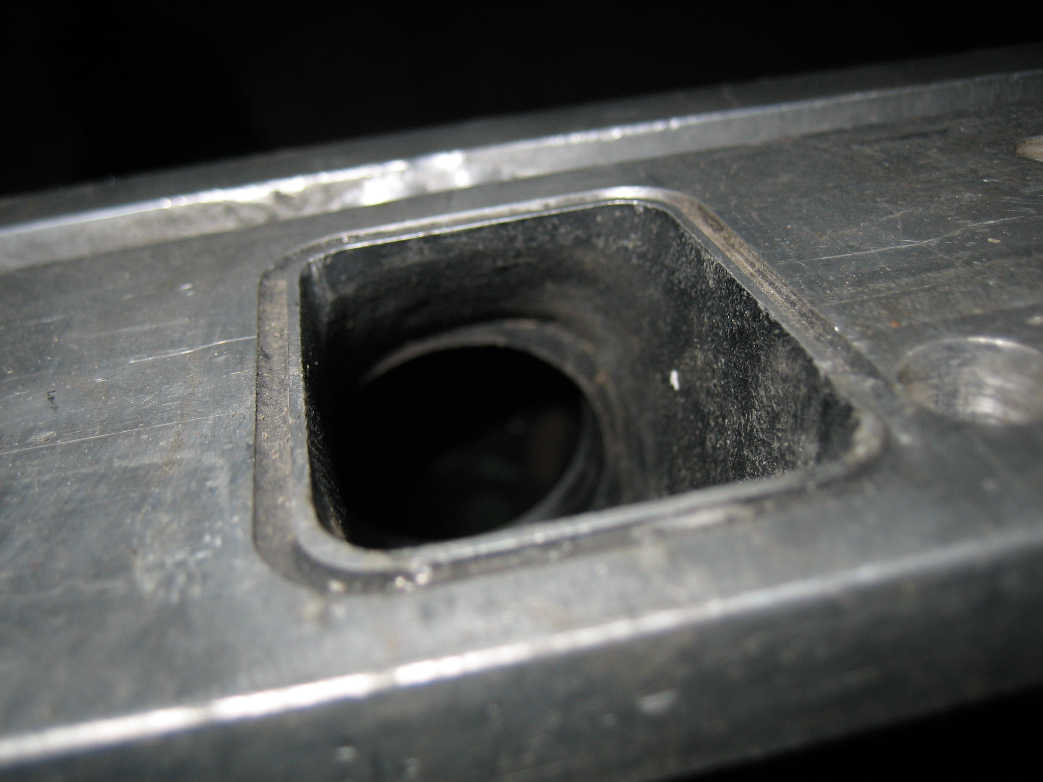

this? how does it mate to the plenum?

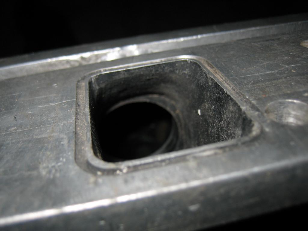

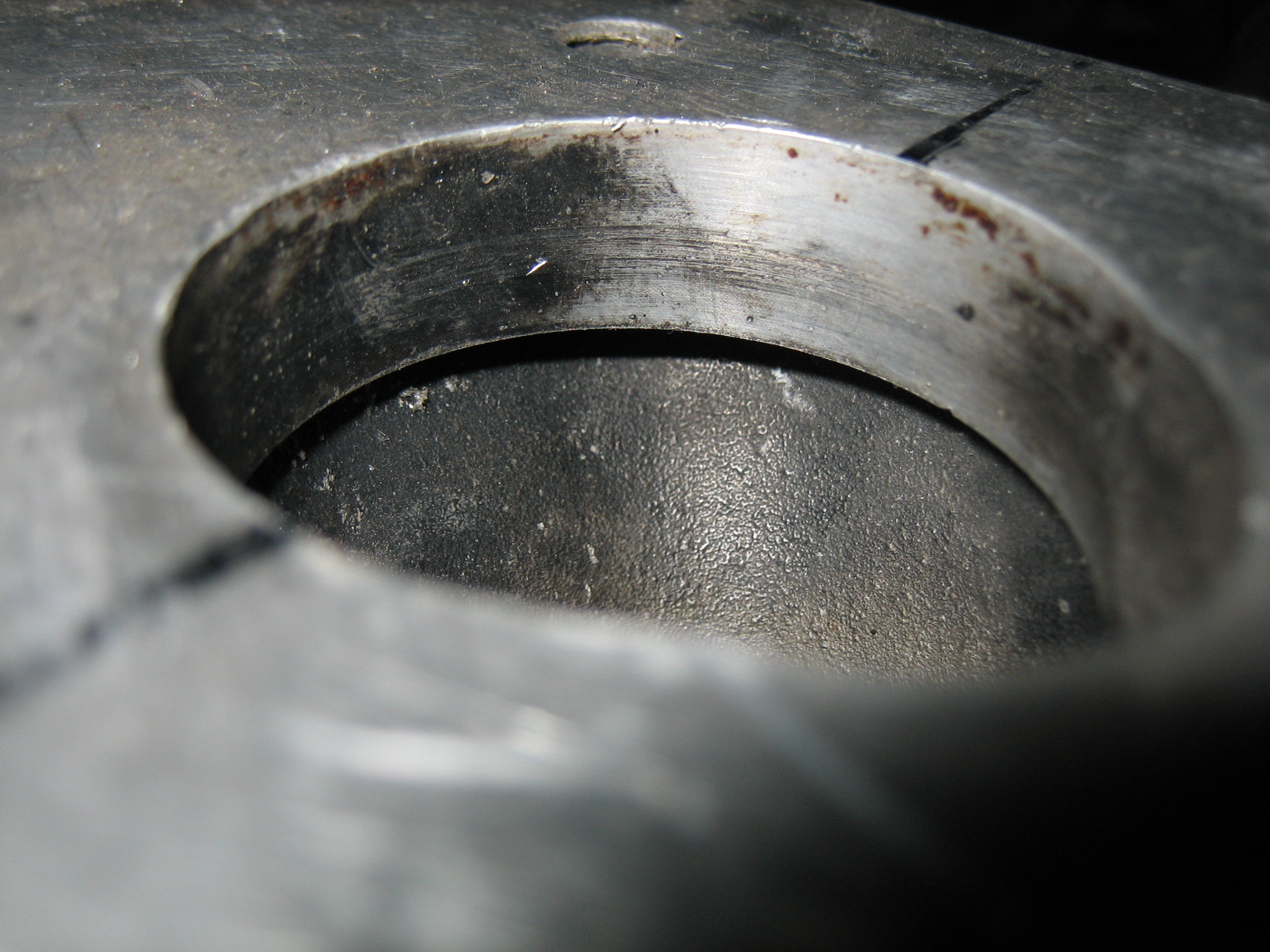

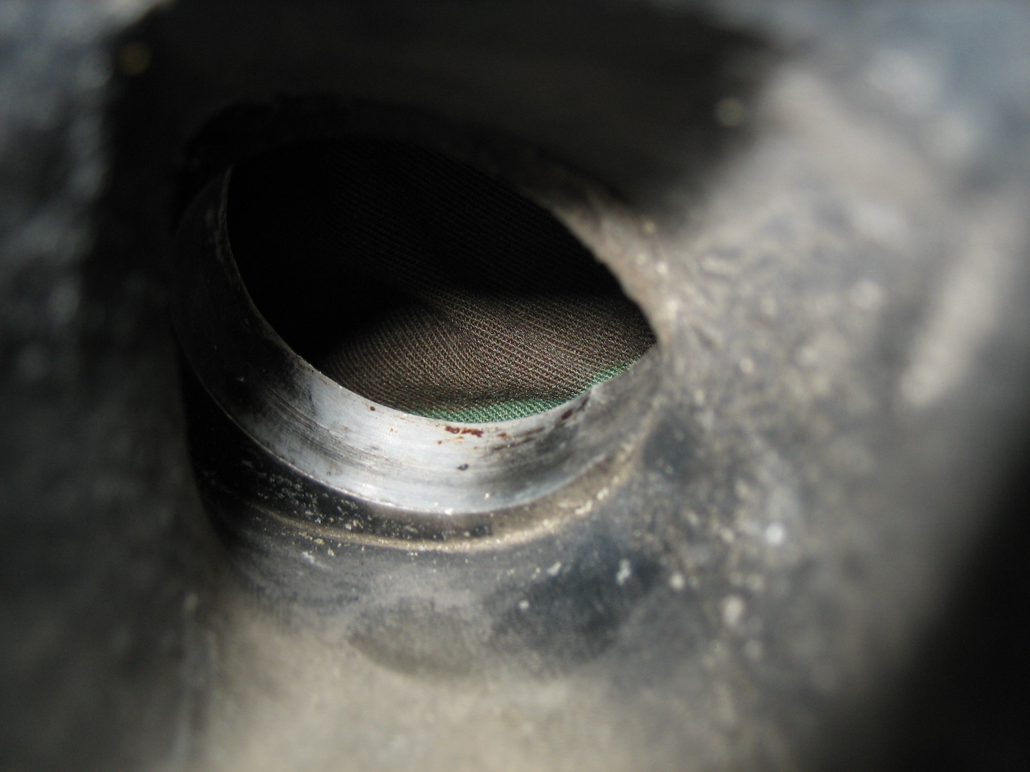

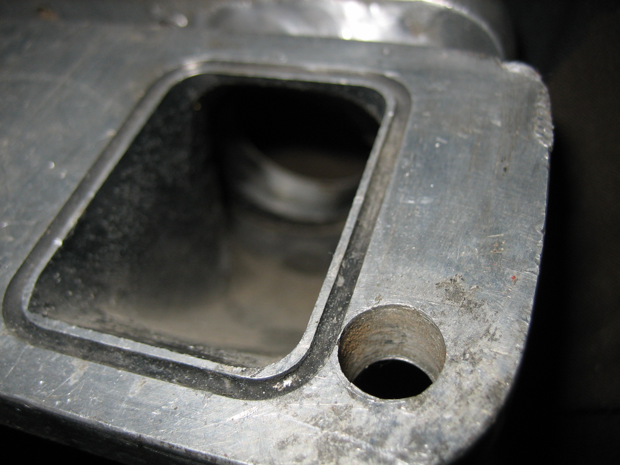

Here are some close ups of the intake adapter. Basically, there is a plate welded onto the top with round holes that transition immediately into square.
I also took a close up of the mating surface to the head. It shows that you can used square O-rings, but I dont know where to get such things. I will likely just cut out gaskets from gasket paper.
Note, this adapter is not the one used in the other guys failed attempt. His were welded in pipes so had a smoother transition.

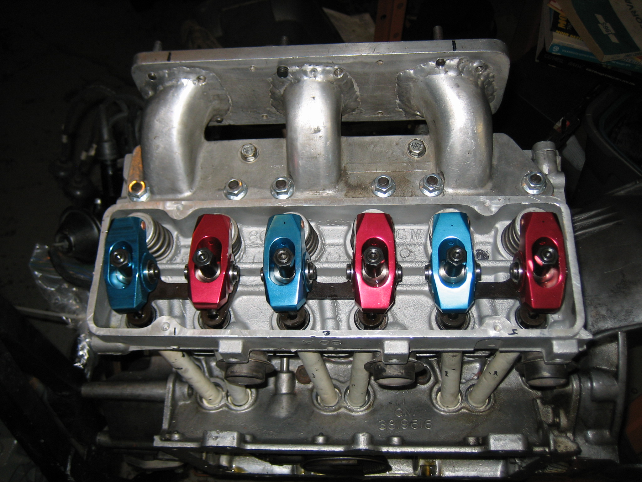

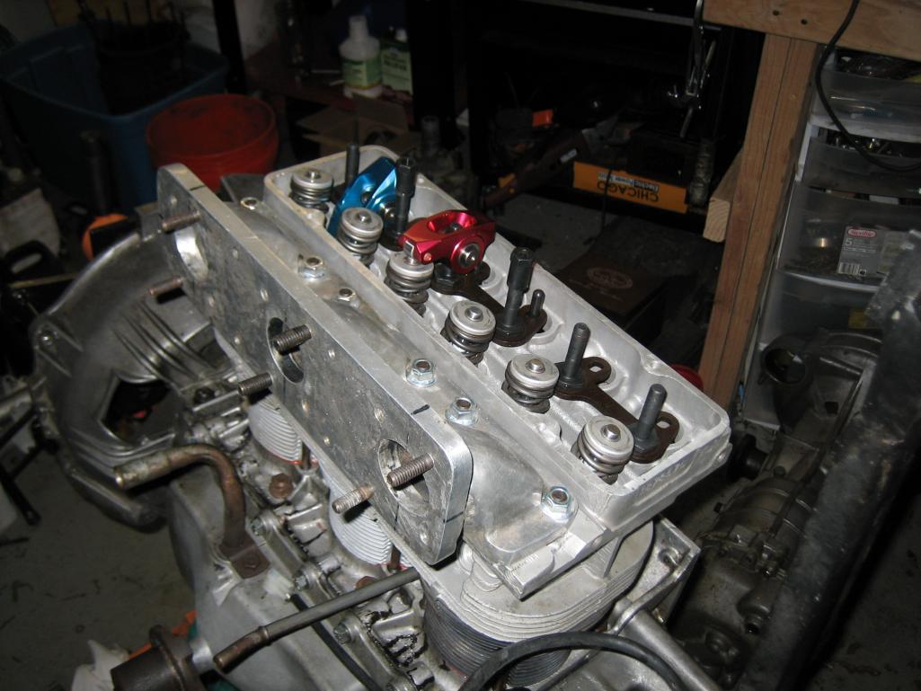

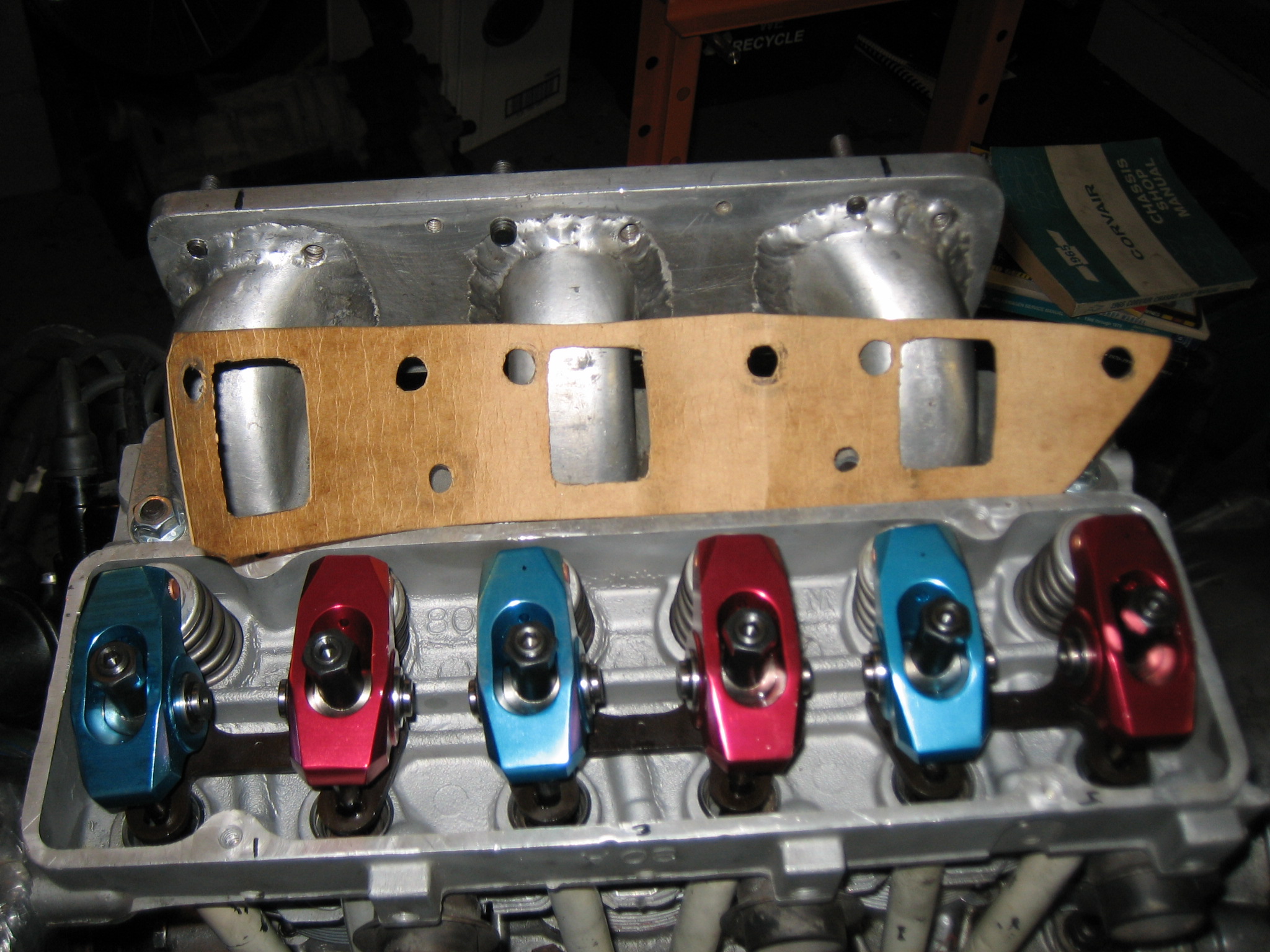

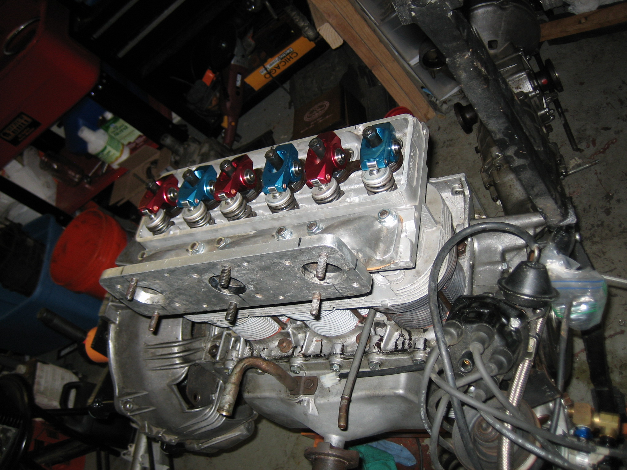

Today finds me with half of an engine done (IMG:style_emoticons/default/biggrin.gif) (IMG:style_emoticons/default/dry.gif) I am mixed about this (IMG:style_emoticons/default/wink.gif)
I love these roller rockers (IMG:style_emoticons/default/smilie_pokal.gif) I got them because they are cool, and they should cut down on heat and valve-train wear. . (IMG:style_emoticons/default/cool_shades.gif)
I also made my own gaskets for the intake manifolds out of a roll of gasket paper I had. Came out pretty nice (IMG:style_emoticons/default/smile.gif)
