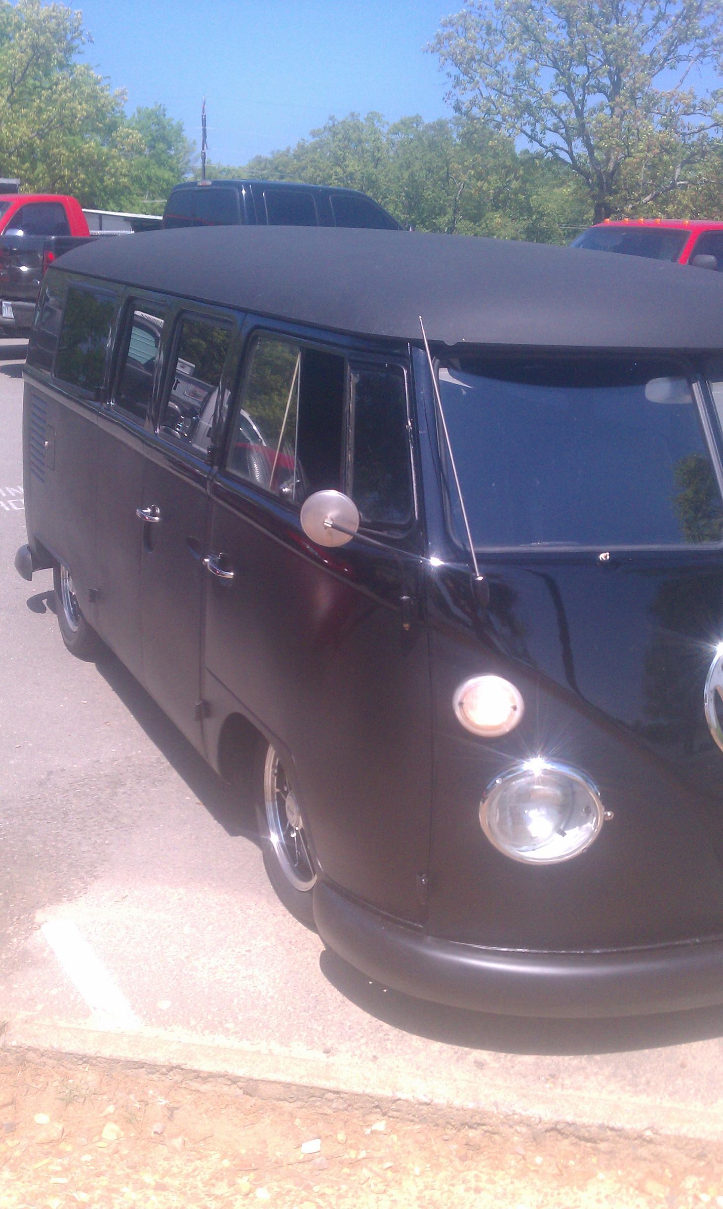

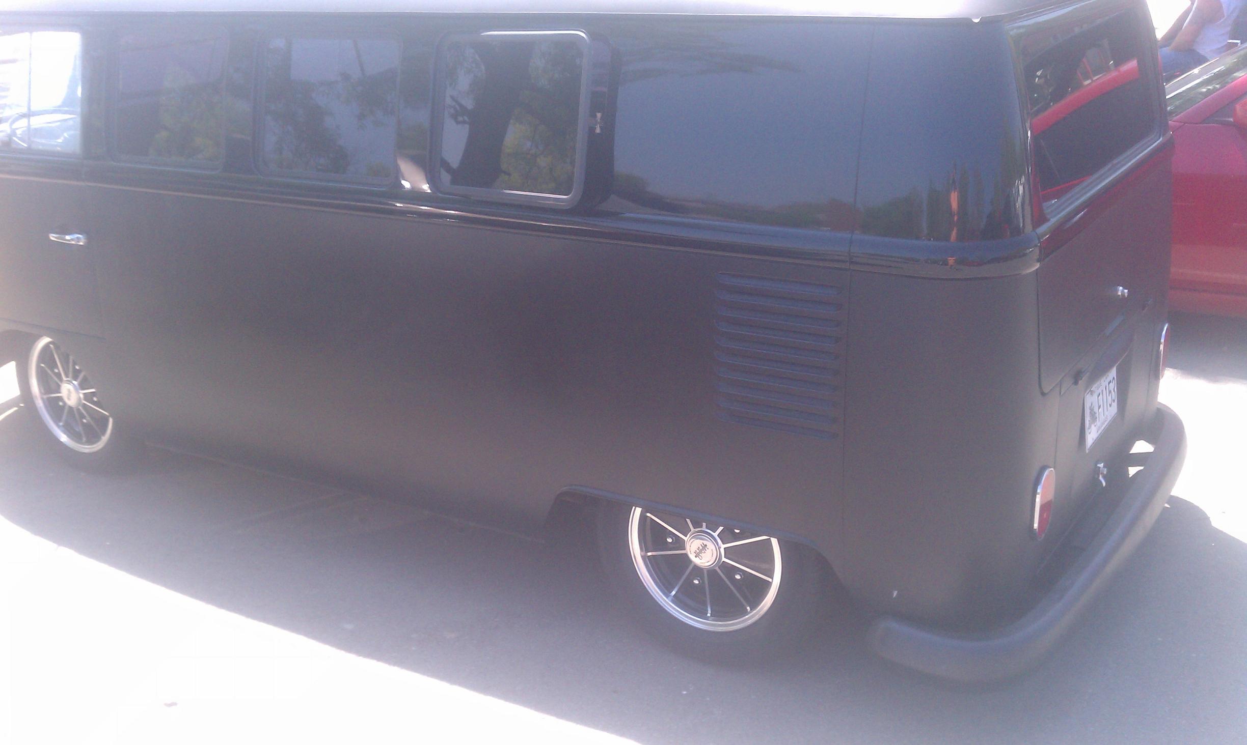

Well, after Mike cut his unit off and almost his finger too, I felt sorry for him and went in to work on his bus after he passed out from the tequila and pain meds. I hope he isn't pissed when he comes too but here is what I left him with.
Sure hope he likes it. (IMG:style_emoticons/default/shades.gif)

OWWWWW I just severd my hand while working on my Agave green with brick red interior 356 Carrera roadster. What to do what to do. Oh me oh my. Hard to type wif face. I'll probably have to sell my.....my.....my paint guns.......... CRAP it hurtz. Oh cral payn neds kikin im. Go beddee by...............

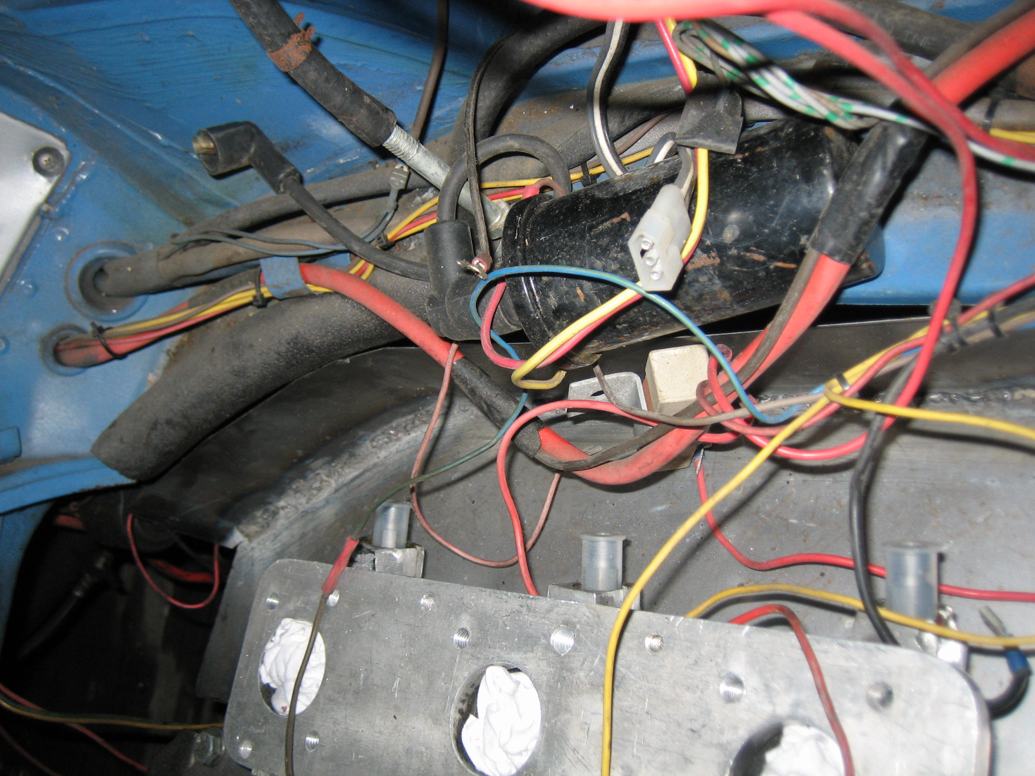

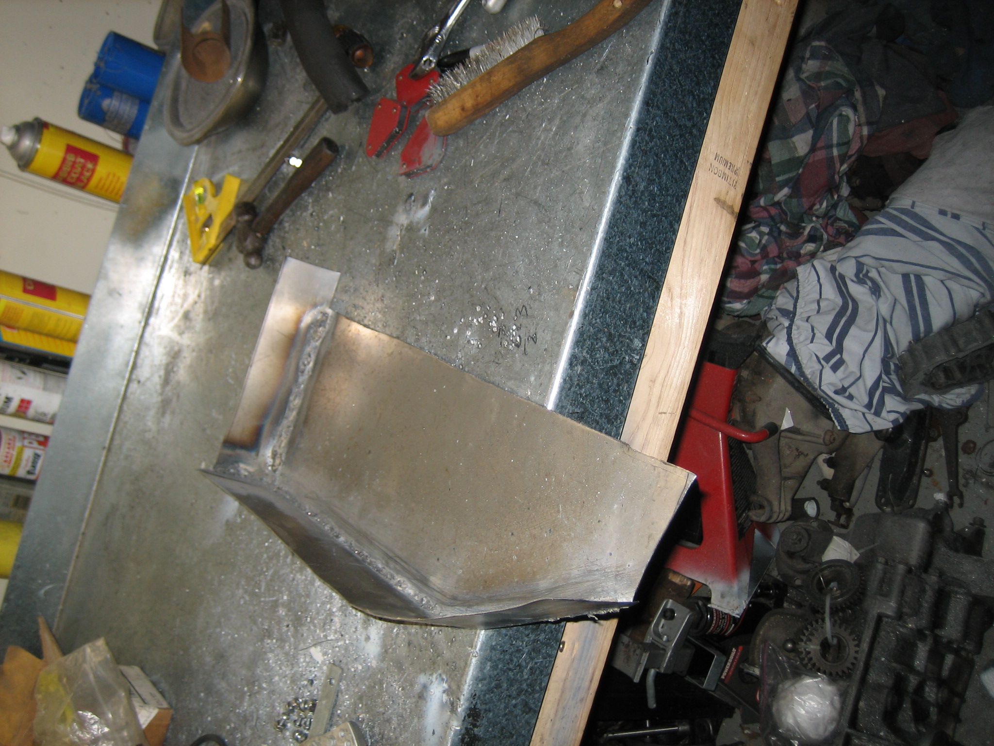

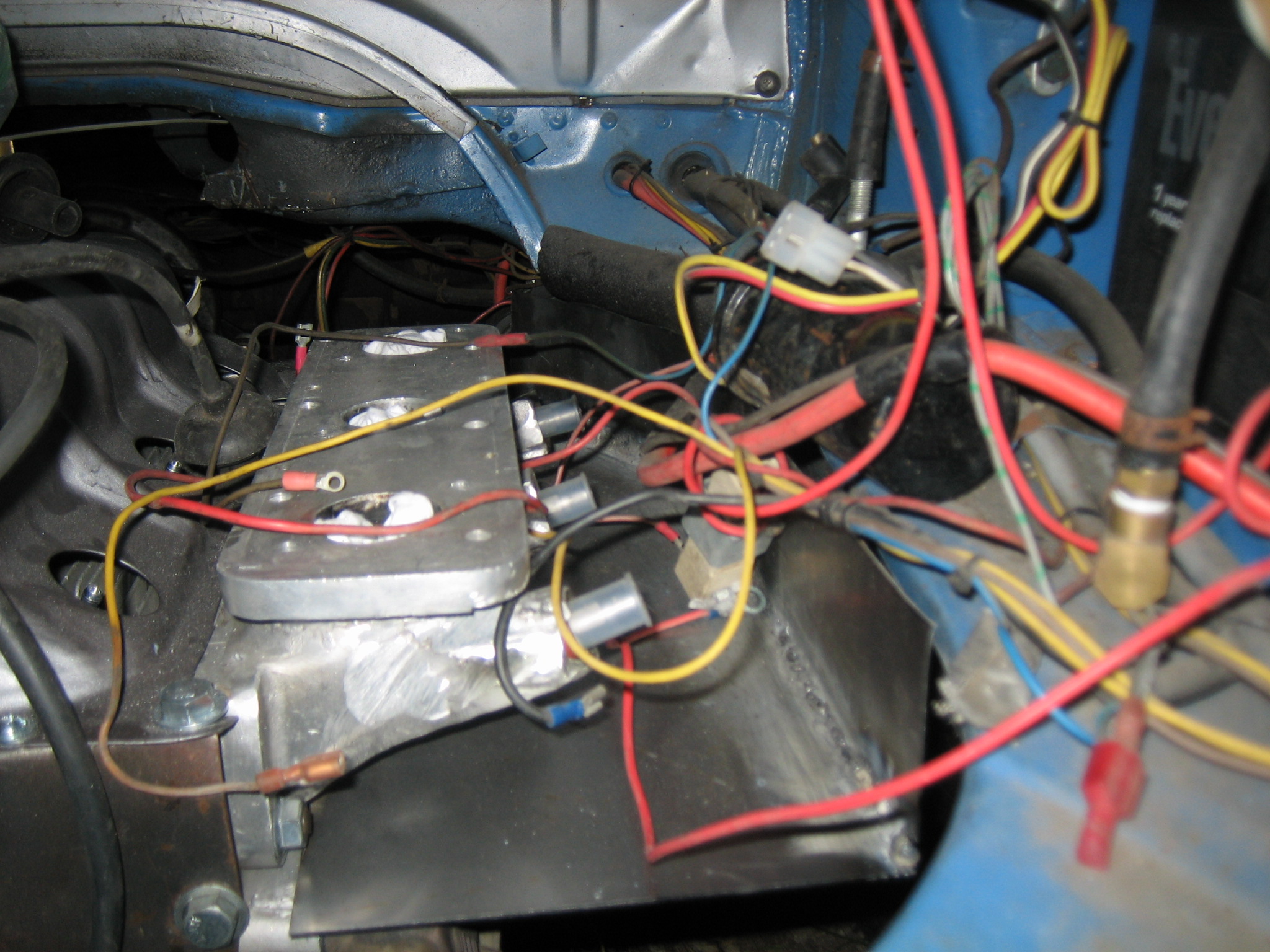

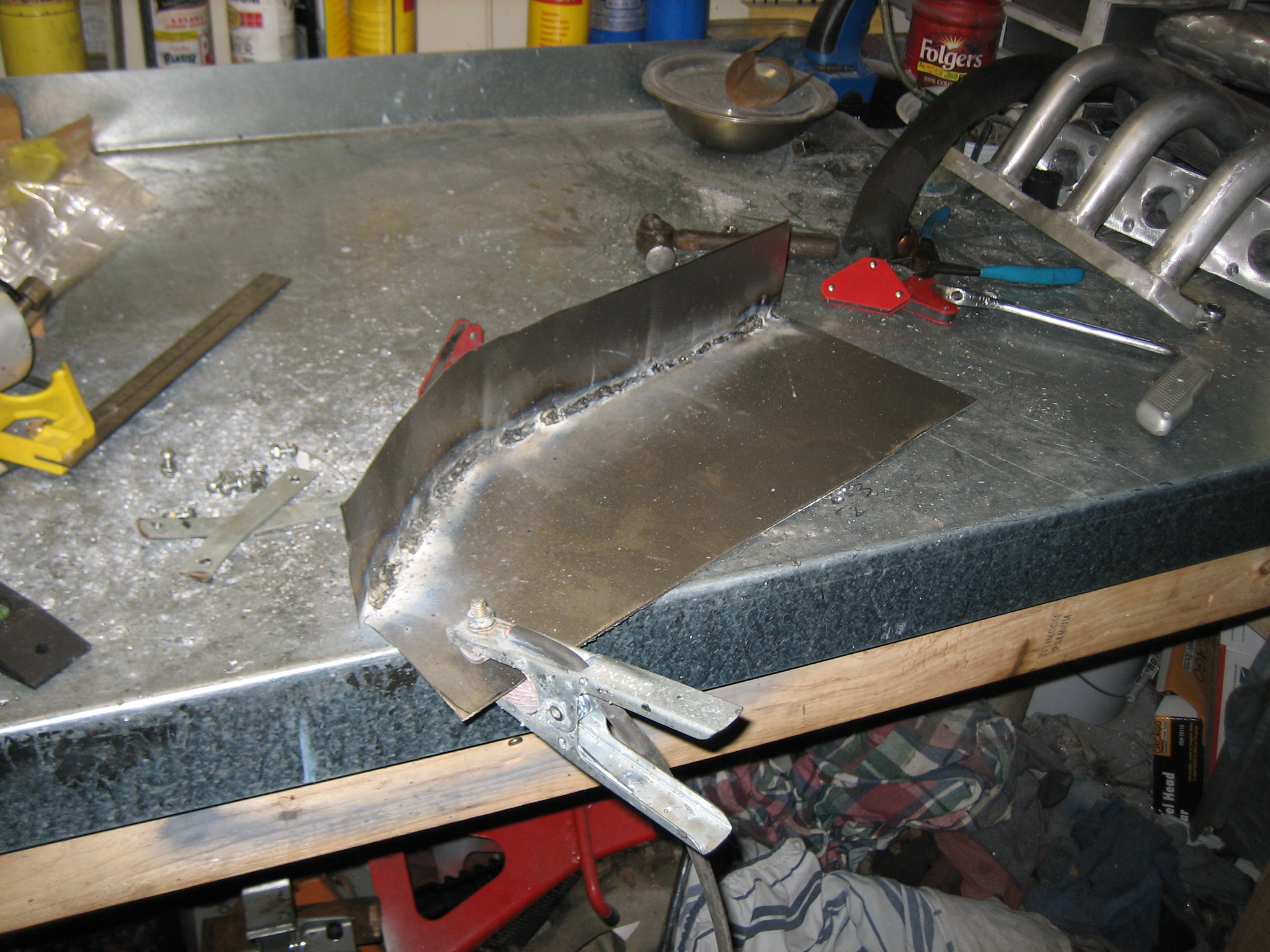

I got some work done on the tin tonight. The good news is that the front and rear parts can be used as is with little to no modification. I did have to make new side ones as the new heads changed the layout completely. Here are the pics of the "easy" side (no AAR or WUR mounts to work around). The base is 16Ga for rigidity since there is no place to bolt that part on, the sides are 22ga and burn through very easy (IMG:style_emoticons/default/rolleyes.gif) I keep telling myself, "its just s prototype".

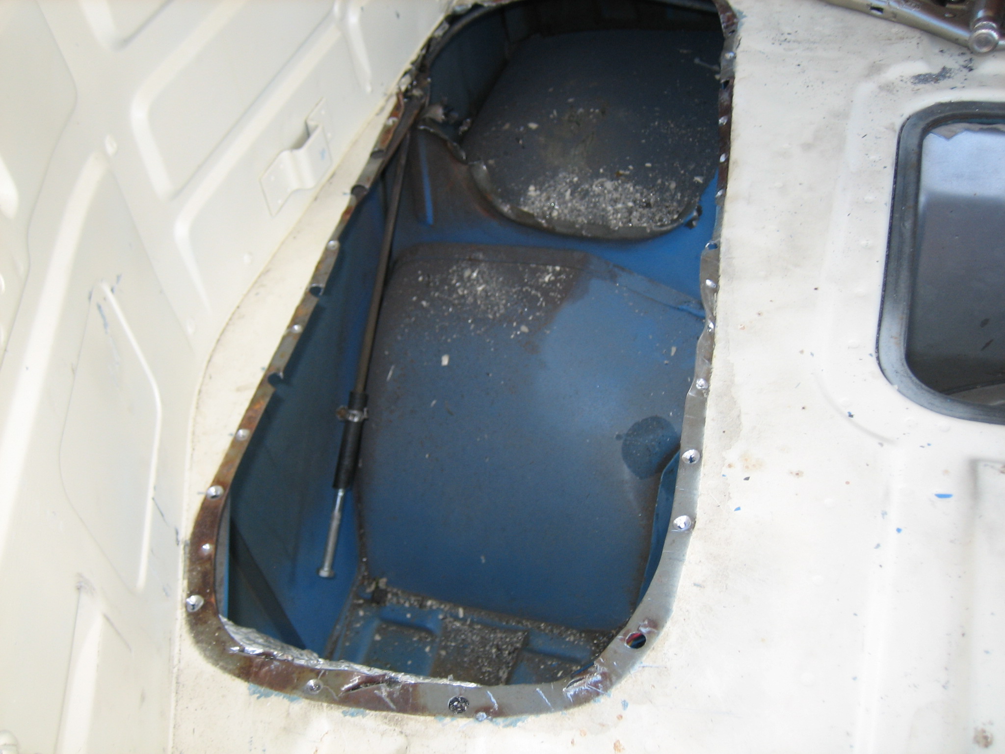

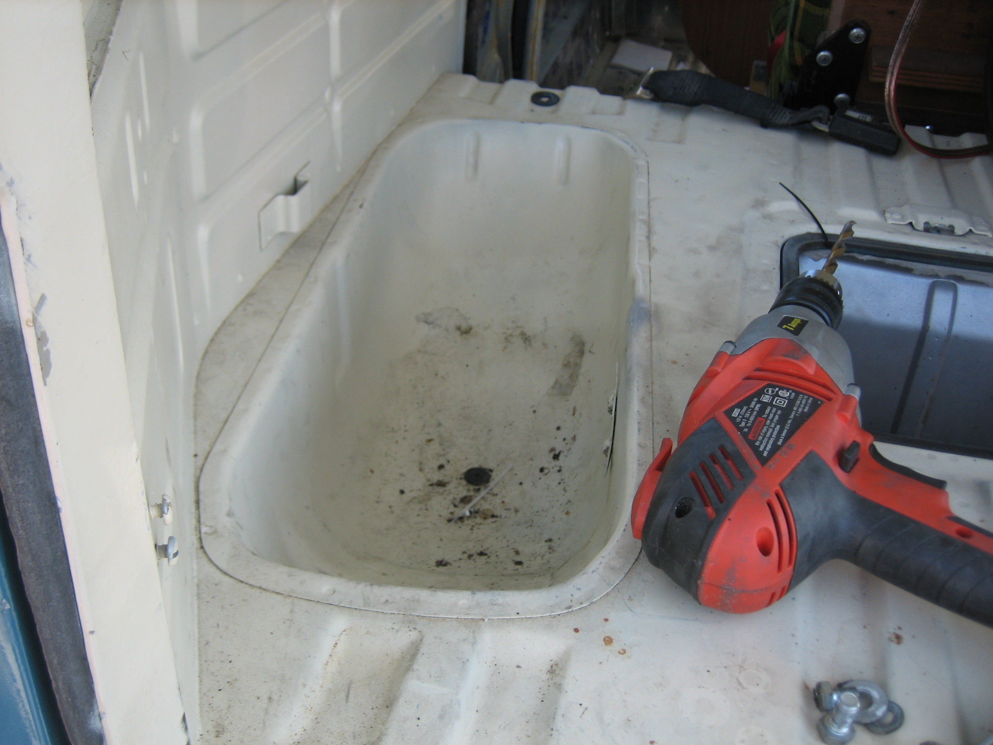

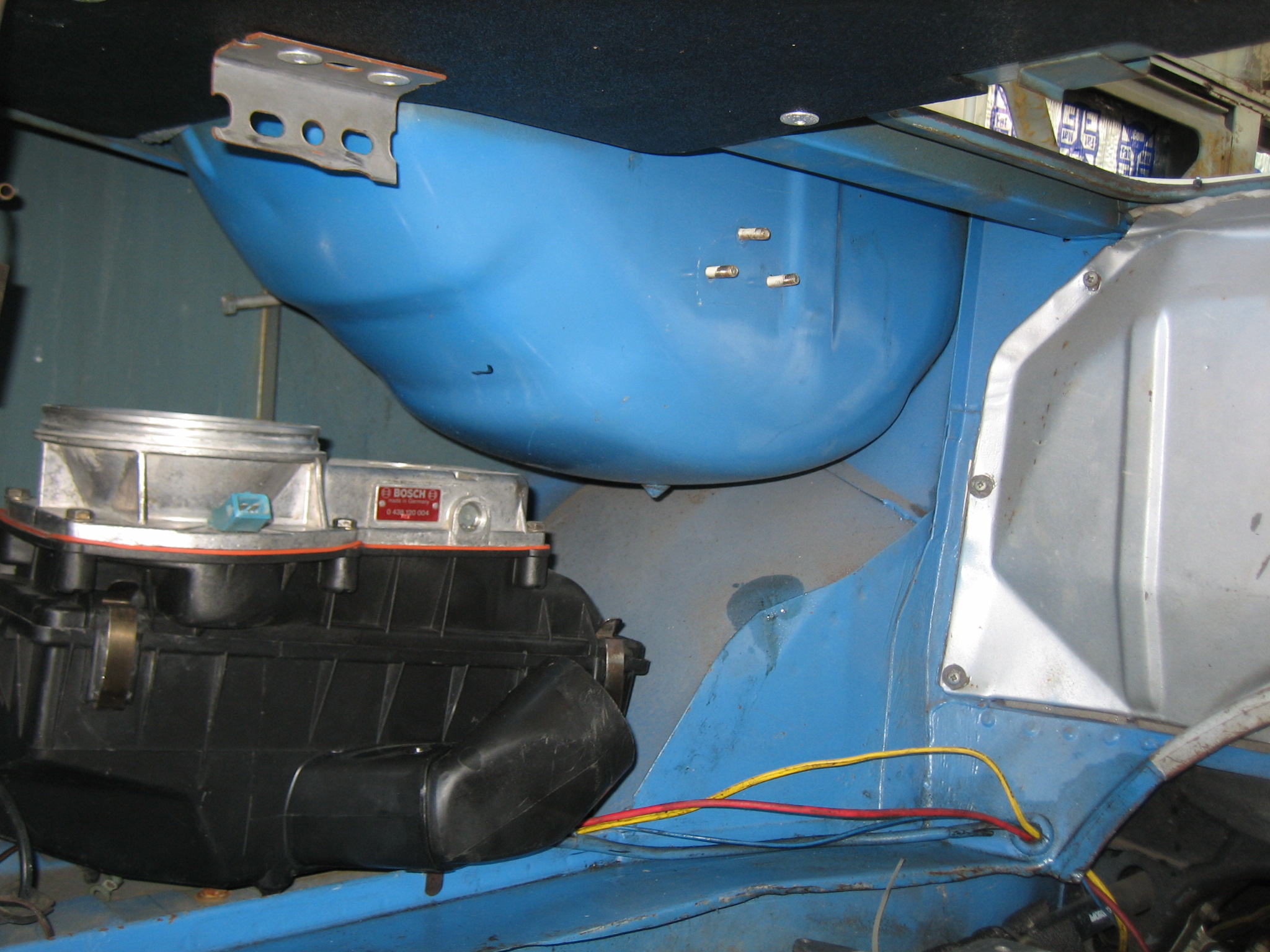

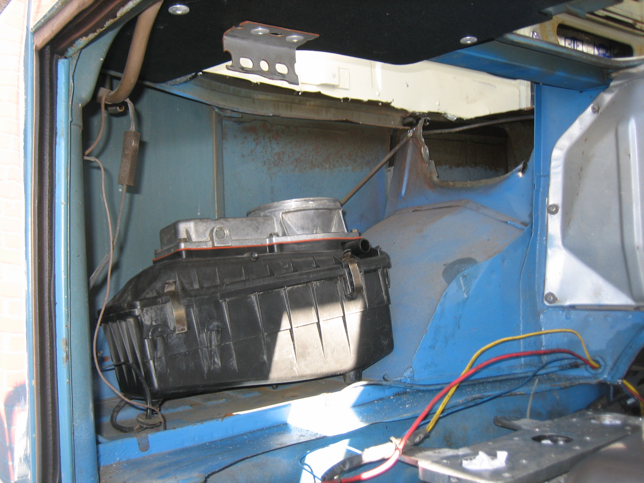

So, mocking up the CIS system and found a few obstacles that need removing/engineering around.
1) That damn tire well is in the way. Well, it was...
2) The TB with the shallow hose on top is too tall for the engine bay, so I will need to tilt the TB assembly and thus make the pipe from the air box with the distributor to the TB have a twist in it....this should be easy (IMG:style_emoticons/default/rolleyes.gif)
