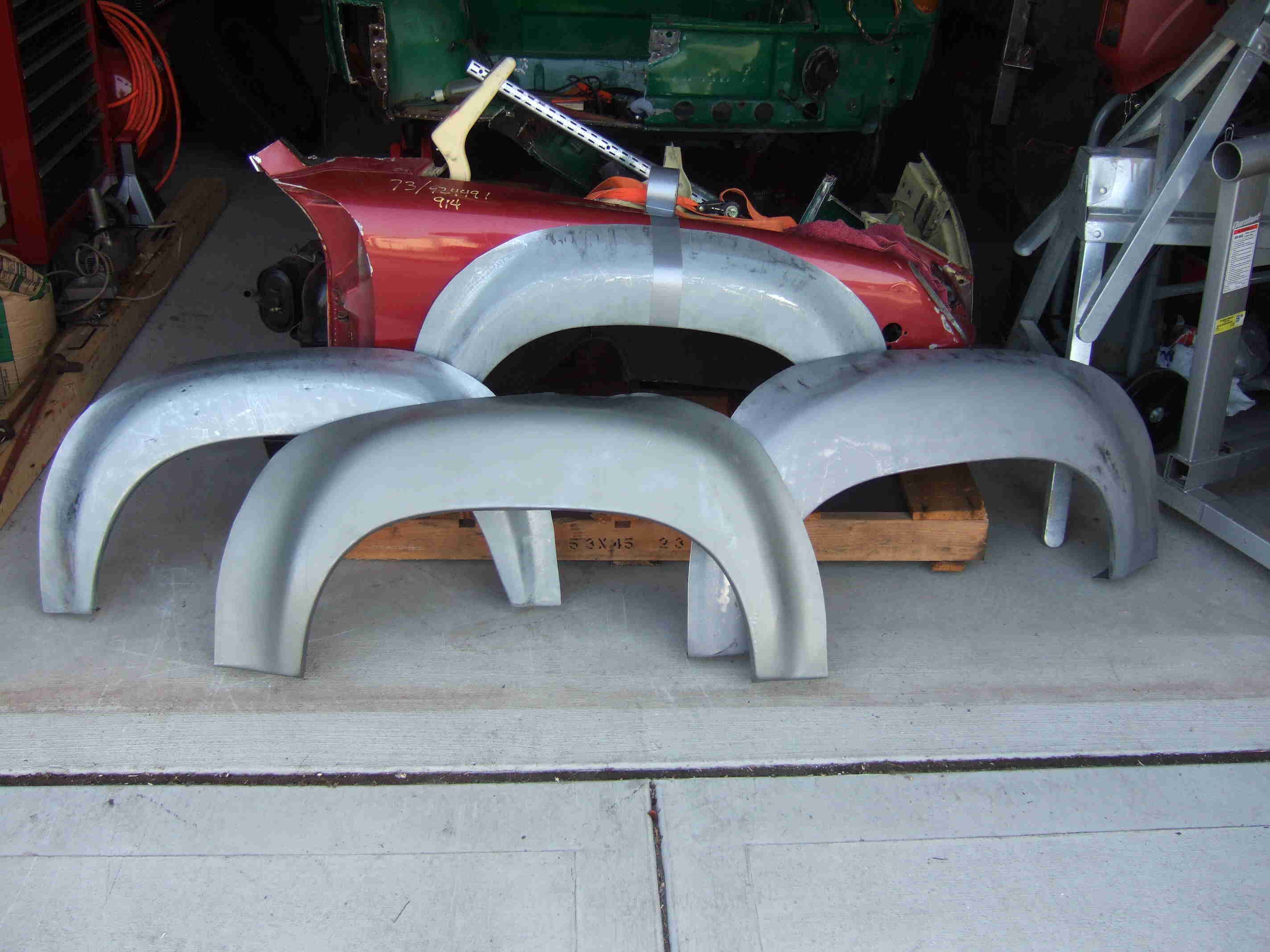

They showed up today. (IMG:style_emoticons/default/piratenanner.gif)

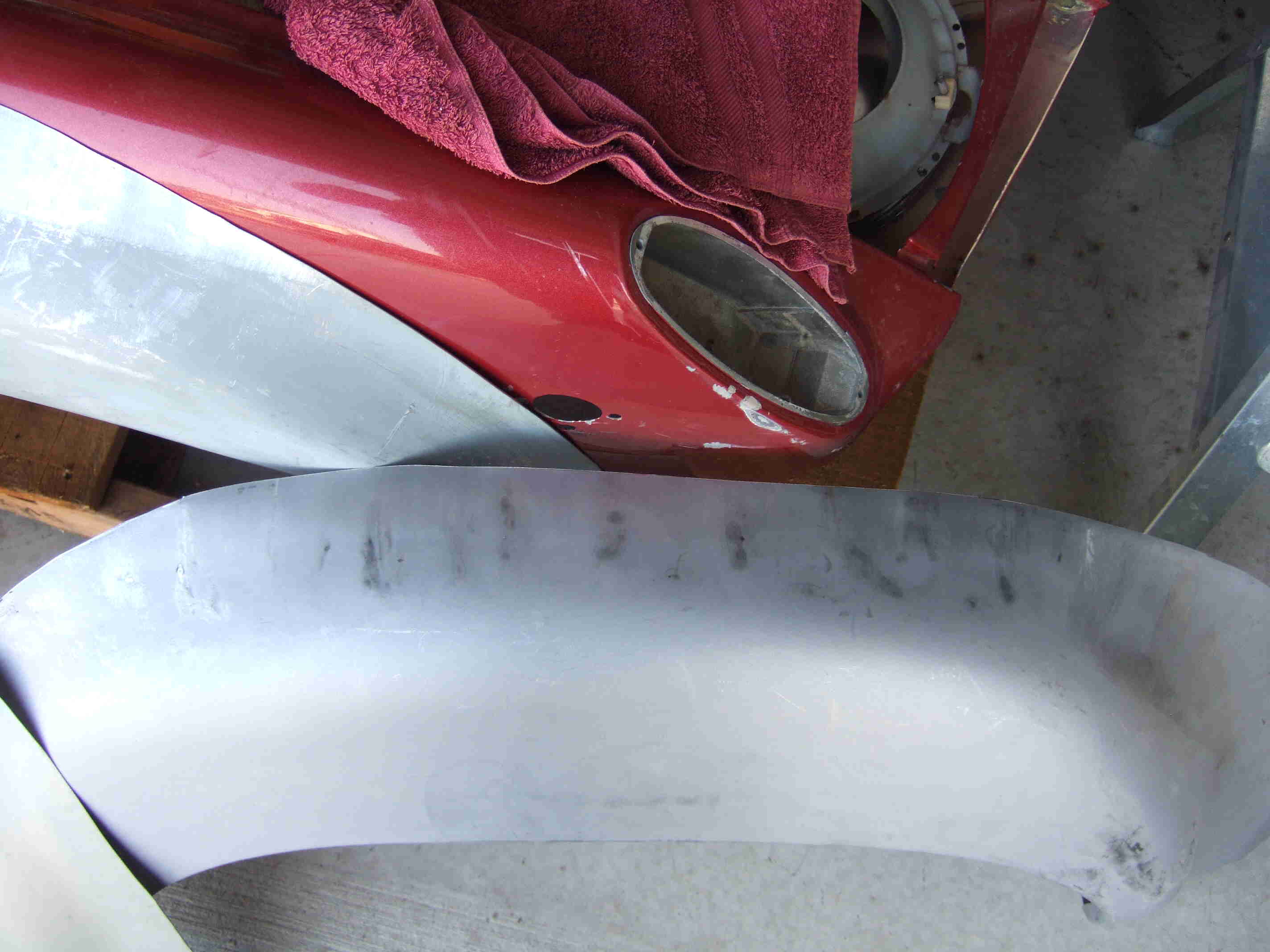

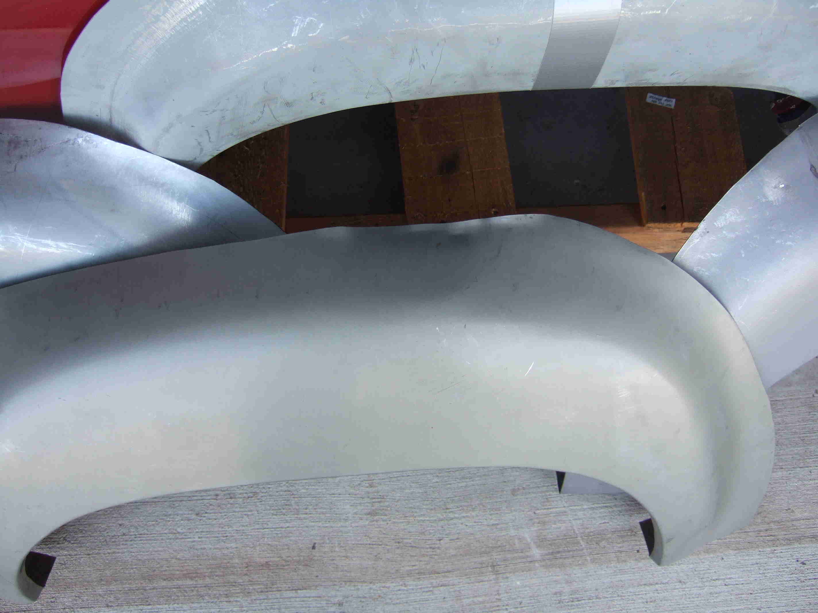

The question I have is are they all somewhat wavy on the top? I know the stock flares are more twisted than the ending of "The Crying Game" but I was hoping they wouldn't require a dolly block right out of the gate. It looks like the FedEx guys were a little rough on the rears. I'll have a little extra bodywork involved in the install.

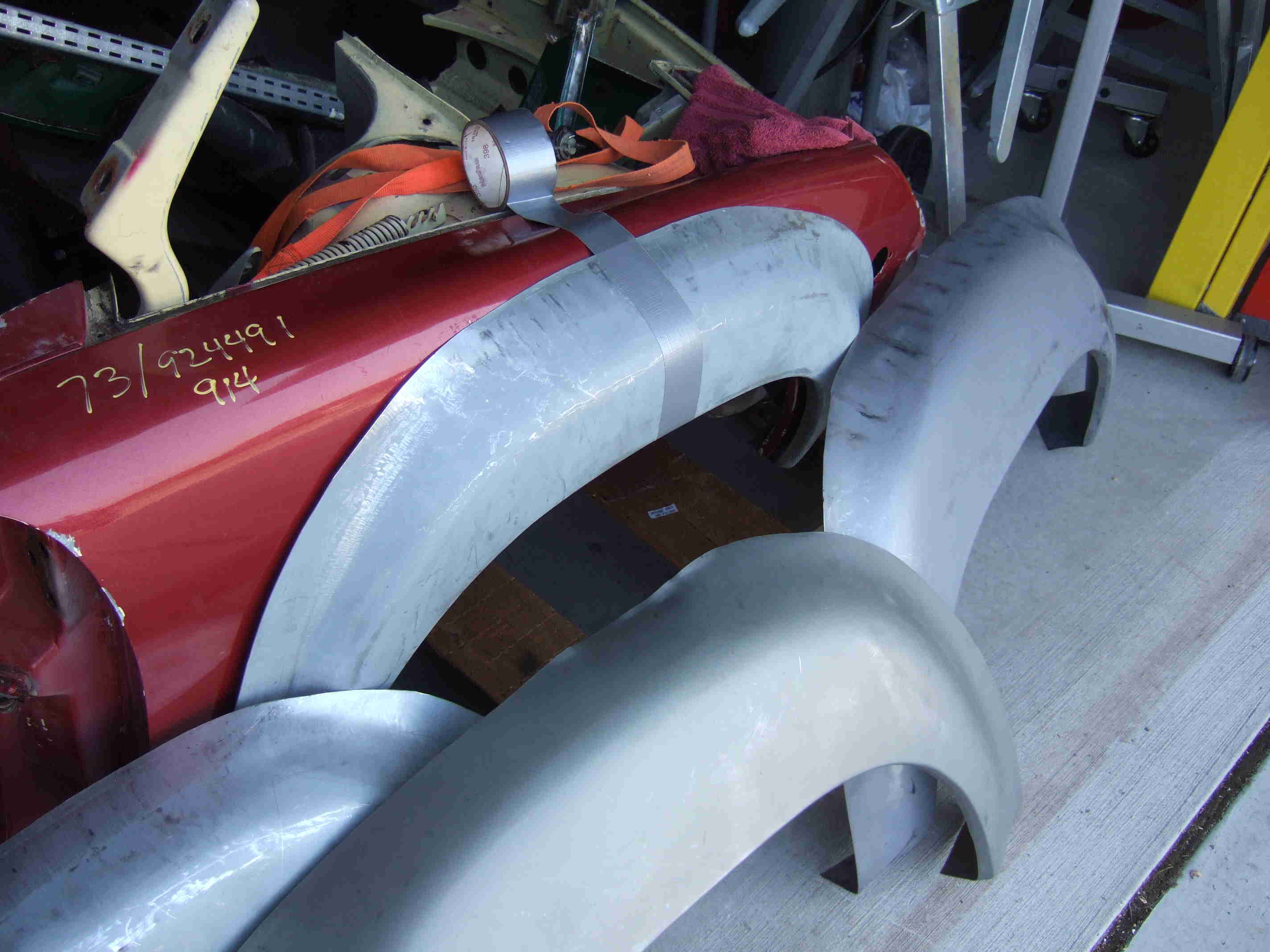

jmill
post Sep 23 2008, 08:00 PM
Green Hornet
Posts: 2,449
Joined: 9-May 08
From: Racine, Wisconsin
Member No.: 9,038
another
scotty b
post Sep 23 2008, 08:04 PM
rust free you say ?
Posts: 16,375
Joined: 7-January 05
From: richmond, Va.
Member No.: 3,419
doesn't llok centerd to me. Move the rear up some and the whole,thing forward a bit. Mine fit surprisingly well
jmill
post Sep 23 2008, 08:14 PM
Green Hornet
Posts: 2,449
Joined: 9-May 08
Member No.: 9,038
The tape slipped some. Your right Scotty they fit real well besides the passenger rear which needs a bit of massaging. I was talking more about the waves where the metal needed to shrink. All in all I'm happy. I can beat it to fit and paint to match. (IMG:style_emoticons/default/smash.gif)
plymouth37
post Sep 23 2008, 08:55 PM
Posts: 1,825
Joined: 24-May 05
From: Snoqualmie, WA
Member No.: 4,138
Mine were a little wavy on top, not as bad as yours but definitely there. With as far as that metal on the top is streched in the stamping process I am suprised it's not worse.

The slight wavy around the edges is normal for the production process used. We should consider ourselves lucky to have repo METAL flares to buy. These go on like butter. I've done a few sets now and love them.

I'd like to see is if the others in the group buy have waves similar to mine. When you guys get them please post some pics. From the looks of things I think mine are worse than most. If they are all like this I wont make an issue of it. If not, getting a new set would save me hours of unnecessary work.

Mine were wavy as well. When Dana installed mine, he tacked them on then cut with a grinder all the way through the wavy portion and the cars fender. Once that was done he butt welded the flare to the car.

I was at AA yesterday. In ATL for work I stopped by. They gave me the grand tour of the place, and I did see some of the flairs in the warehouse. They didn't look wavy at all.
I would assume there is going to be some work to get them to fit right. Those kinds of things always are some work.

All the ones I have seen are wavy. It's the production process. (IMG:style_emoticons/default/agree.gif) I'm just glad they're available. If I have to work them a bit of use a bit of filler, so be it.

QUOTE(jmill @ Sep 23 2008, 07:00 PM) *
another
looks like someone roughed them up. Maybe their name was FED EX

We are talking about an exact laser assisted copy of 30+ year old parts that was corrected as even the originals were not the same left to right... Add this to the fact that our 914's have suffered any number of sins over 30+ years and you have a bit of a challenged fit. Believe me, it is much better than fiberglass...
