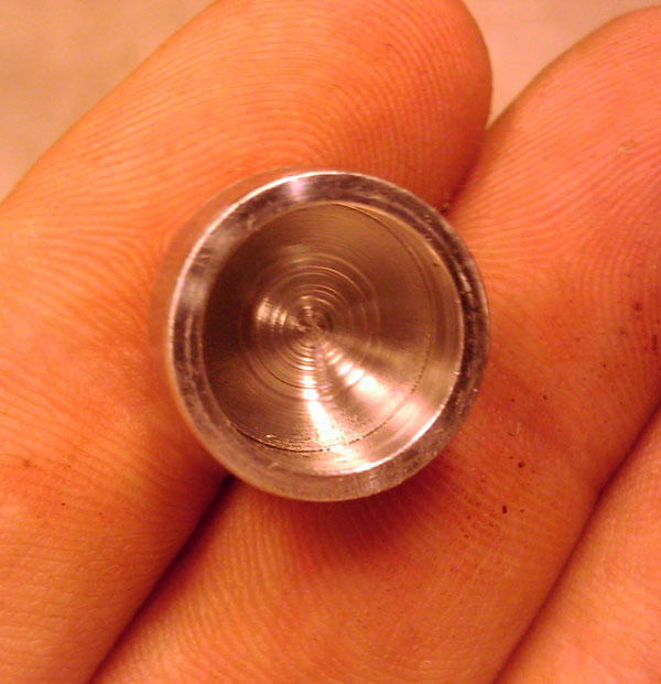

I walked in the garage and immediately knew I had a problem. Here's another clue. Can you identify this little part?

Galley Plug?

Ding ding ding! I think we have a winner.
My car had been sitting parked in the garage the past couple weeks, haven't even started it. Today when I walk in the door there is oil all over, coming from under the car.
But hey, I'm damn glad it fell out while sitting there instead of while driving!! Go figure.

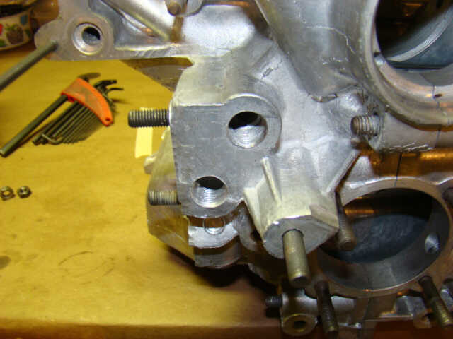

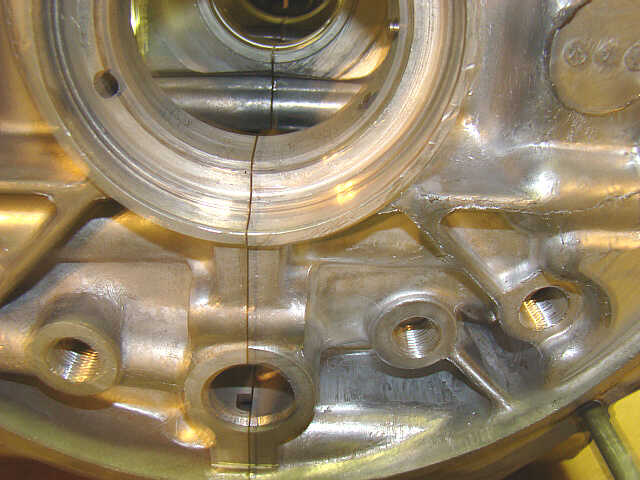

I think you're going to need to drop it. Here's pics

Seems so strange to me it would just fall out while sitting there, having been undisturbed for many days prior. I consider myself really lucky it happened this way and didn't damage the motor.
I'm concerned about repairing this while the motor is together.... I'm not sure just greasing a tap would give me the confidence some shavings aren't going to get inside. Anyone done this? Comments please.
Well, I suppose now's the time to start my engine swap. I'm ready to sell this motor and buy some conversion parts.

I have a very comprehensive article on this topic posted on my forums and lots of pics are in that thread.
I have installed a threaded galley plug into an assembled engine when this has occurred. Be very careful and use grease on the tap to attract the debris during tapping, then use a shop vac to pull vacuum on the work area, removing most of the stray chips before they get into the oil galleys. If ONE CHIP enters the galleys it's game over for the engine.
These plugs have been installed into the engine for over 30 years, they become dislodged mostly in the winter when oil pressures are higher due to colder, thicker oil. When starting your car in the winter after it fires up don't rev it at all! Also stick your head under the car and ensure you don't have a stream of oil pouring from a dislodged galley plug....
...and at rebuild time ALWAYS replace these problematic plugs with thread in plugs, per my article to ensure that you NEVER have to worry about this again.

Grease the tap and clean/re-grease often, use a shopvac and clean up with cue tips and such soaked in brake cleaner. Go slow and it will be fine.
If a front galley you can pull the pump, relief plunger and filter stand if you want.
Where is the oil coming from?
My guess is one of the galleys plugs in the top (front) pic, as it was on the floor.
Although a pisser I'd say you're lucky it happened when it did.
