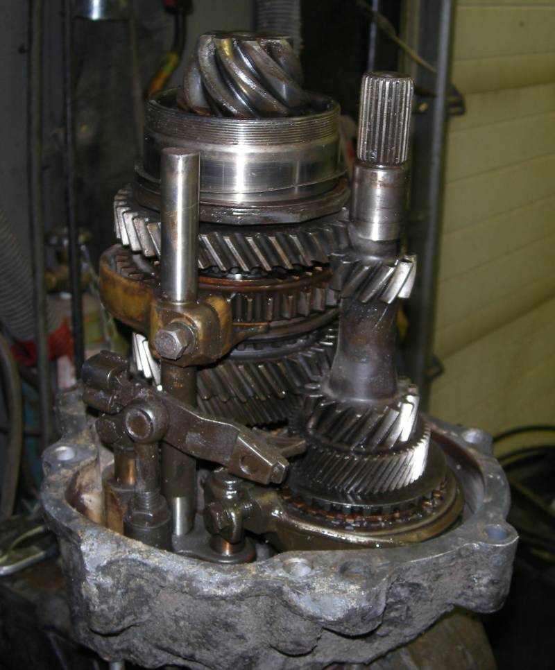

In one weekend the Doc totally demistfied the 901 transmission and manual transmissions in general.
Because the only transmission I've ever taken a peek at was the aircooled VW, I've been scared of tranny's like a little girly-man.
I'm not an expert yet, but I hope Mike would say I'm compitaint.
I have 2 transmissions built from the clinic, plus enough spares to build a another 901 if I had another core.
In this pic, if you look at top 1/3, center, you can see (on the pegboard hook) dog teeth, 1st sliders, sider and a few bands. Nice score.
2nd pic is the 911 901 that the Doc built as a demonstrator, same thing as a 914, just a bit different on the nose cone and selector.

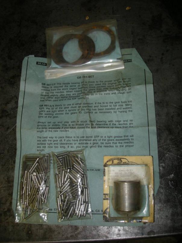

This is my new undertaking. Ooooooohhhhh.....that bad and scary Type 1 transmission!!!!!!
First I was always told this is one of the hardest transmissions to learn on.
I should have taken that to heart and tried a easier transmission (like the 901) to learn on.
Now at least I know what the fuching thing is doing! I've been reading (a lot) and it makes sense now.
The VW is harder than the 901 and it requires a few more tools, plus a small press.

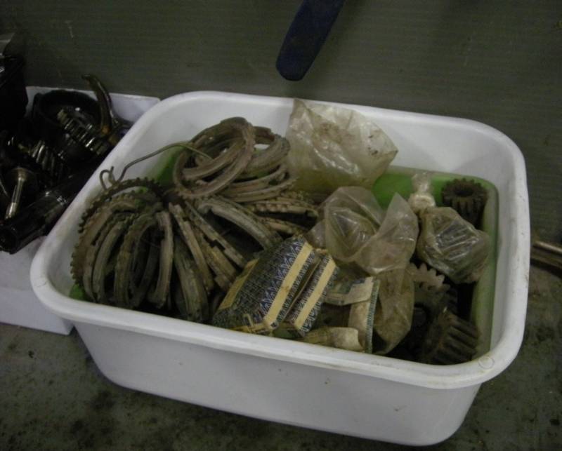

Man do I have spares in my stash, this is going to sound sick but syncro's are only like $15- $20 each, but I have over 30 NOS sets. Plus many new gears and hubs.
Doc found an NOS 901 first gear slider in this mess, Then told me I have horseshoes up my orifice.
I've been sitting on this shit for 20 years!

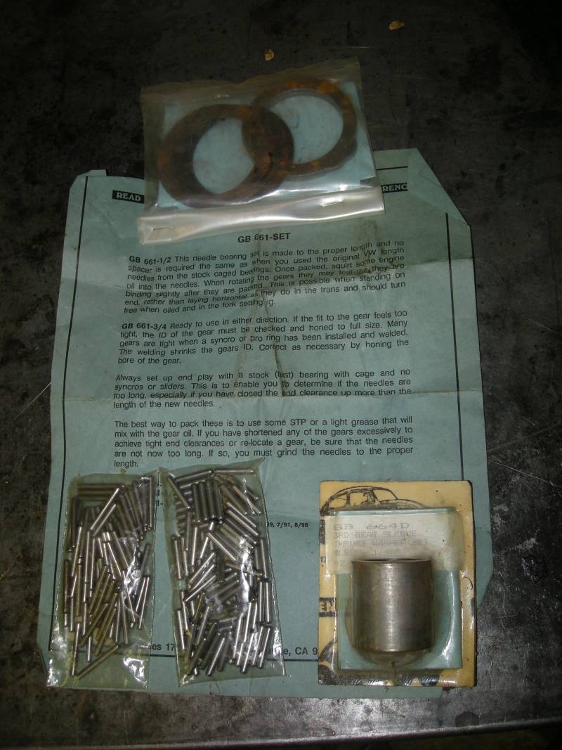

This stuff I had (before I grew a pair) bearings for the stack, a solid 4th gear spacer and a swing axle poor man posi kit, all high performance goodies from Gene Berg
I'm also soon going to tear into a swingaxle, because my bus tranny sounds like it's getting loose and needs some beefing. The 2.0 Berg engine is a bit hard on it.
I have a 091 bus core as well.......

You need 2 cores to make one. (unless you have to have new....and Ben Dover)
Dog teeth and bands from 3/4/5 can be used. If you get lucky you'll have enough good sliders. Ist gear slider is super expensive as is everything else, the more good used you find the better.

One slider for 2/3 and one for 4/5, same part on both. The kick in the nuts is if you don't have a good 1st gear slider.

is that a Nickie just sitting on the shelf in the first picture?
degreeoff
post Oct 7 2009, 05:05 PM
I like big butts and I can not lie!
Posts: 1,622
Joined: 9-February 03
From: Booowieeee MD (near DC)
Member No.: 275
QUOTE(crash914 @ Oct 7 2009, 02:20 PM) *
Thats a 911 or T-1 I believe

Its a Nickie
