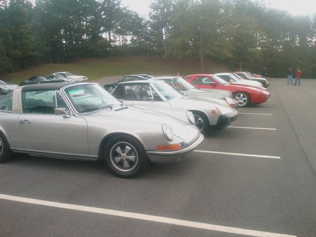

The door was fine but I was trying to keep up with the 911s and (944s with V8s) at the 1st Annual PCA Alabama Region Fall Festal. There were only two 914s and we both had four cylinder 2.0s but it was fun anyway.
I received two more awards today, one for most road rash and one for longest restoration. (IMG:style_emoticons/default/smilie_pokal.gif) (IMG:style_emoticons/default/smilie_pokal.gif)
I have got to get some painting and body work done before I get any more awards like this! (IMG:style_emoticons/default/wacko.gif)
Here are a couple more pics from the Fall Festival.

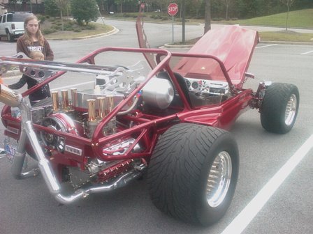

Good riddance. Lose the trim and go with a black rubber seal. (IMG:style_emoticons/default/smile.gif)
I love that last pic of the rail with a six. I'm just trying to figure out where he can use it, especially with those tires? And no air cleaners.... guess it's just for show.

HA! There is no way that "sand" rail ever gets driven. That shiny engine would be trashed with a quickness. It does look cool though.

That Rail looks like a Wheelie machine
