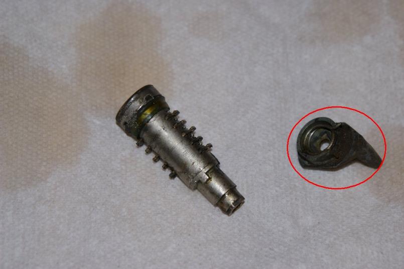

First make sure the lock tunblers are really clean, You will need to take the handle off and remove the lock mechanism from the handle. Clean it and also really clean the spring (circled in red) so that it move freely. Spray it with CLP and see if that helps.

Just did mine...took the lock cylinder all the way out and even removed the tumblers and springs (keep them in order)...hand cleaned each one and the cylinder itself. Removed the door handle and cleaned every part. Works like any 2010 car out there. Before, I thought I had the been given the wrong key by the PO (wouldn't turn at all), and had to shoulder the door from inside to get out.

I had the same problem. As several folks have already said, clean, clean, clean...that's step one.
When you have it apart, as in the photo above where the piece with the actuator arm is off (the one circled in red), you'll notice there is a square machined out of the inside, and on the end of the tumbler is a corresponding square that sticks out and fits neatly inside it.
On my lock, part of the square on the end of the tumbler had broken off, so it had some grip to turn right, but not enough to move the actuator left. I ended up removing what was left on the end of the tumblre, fabricating a small metal sware to take it's place, and supergluing the whole mess together with a new screw and pressure washer. It has worked great ever since...but I do unlock the door gingerly! (IMG:style_emoticons/default/biggrin.gif)

i'm not clear if you can turn the key both ways. if you can turn both ways and it locks but does not unlock then:
QUOTE(Jerry75914 @ Oct 31 2009, 07:08 PM) *
i had this problem too. i converted to the "square" on the end type. my early 73' had 2 pins instead (1 had sheared off). i assume the pin type end is early and suare is late. make sure the screw in the end of the tumbler is tight.
p.s. make sure the key return spring is installed in the notches right when you put the end peice back on
