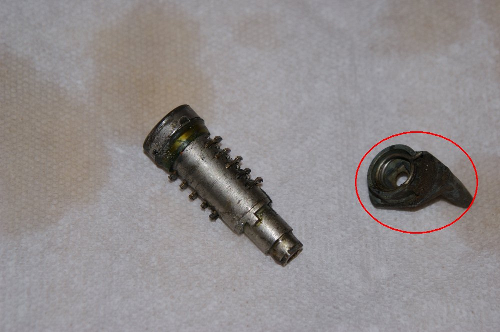

First make sure the lock tunblers are really clean, You will need to take the handle off and remove the lock mechanism from the handle. Clean it and also really clean the spring (circled in red) so that it move freely. Spray it with CLP and see if that helps.

I had the same problem. As several folks have already said, clean, clean, clean...that's step one.
When you have it apart, as in the photo above where the piece with the actuator arm is off (the one circled in red), you'll notice there is a square machined out of the inside, and on the end of the tumbler is a corresponding square that sticks out and fits neatly inside it.
On my lock, part of the square on the end of the tumbler had broken off, so it had some grip to turn right, but not enough to move the actuator left. I ended up removing what was left on the end of the tumblre, fabricating a small metal sware to take it's place, and supergluing the whole mess together with a new screw and pressure washer. It has worked great ever since...but I do unlock the door gingerly!
