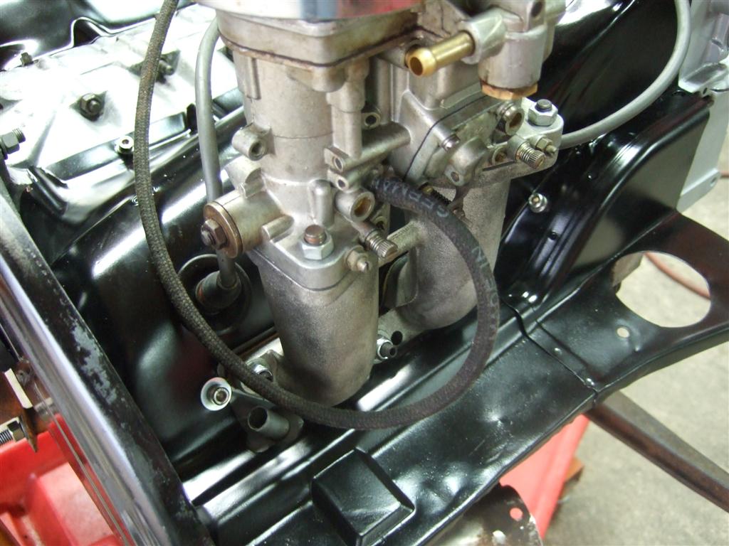

found a pic of the carb, specifially the back that I'm talking about...
it's different than the others I've seen, but maybe ACE can fix them

Um... have you taken off that nut and looked behind that round washer? You'll find the shaft bearing there.

.........YEP.........take off the nutand washer......and there she-be....AND It looks like you have an adjustable acc.pump .....the thing between both bores, has a rod with a spring behind it, attached to the cover in the middle of carb....this means ....YOU DO NOT HAVE the oldest design weber., and yours should be able to repaired easily.....I too understand ACE...does quality work, and has parts.

I will take it off one side when I get home, and report my findings... does it take a special shop/tool to replace these? I was told these were
pre-bearings... on the front there is not the springed piece as shown on the other carb... it's basically the same except it has a throttle stop, idle screw and throttle ear.
should these be repairable by moi? or just send them to Ace?

ok, well, here's the deal, ACE may not be cost effective in this scenario, but maybe I'll send them in for the final estimate, by the approximation given, it would be about $50-70 cheaper per carb than Empi HPMX carbs.. if that estimate is accurate, perhaps new carbs or good-used ones are in order... but that price was for EVERYTHING they do, they do NOT do bushings, bearings only.... I'll inspect the bearings and post pics. if it's the bushings, then new carbs are the only solution.
