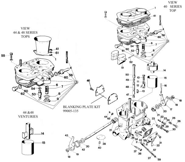

On my 44s, the bearing pops right out when you drive the shaft out...
You mean #21 on this diagram?
IPB Image
tat2dphreak

using this picture as an example:

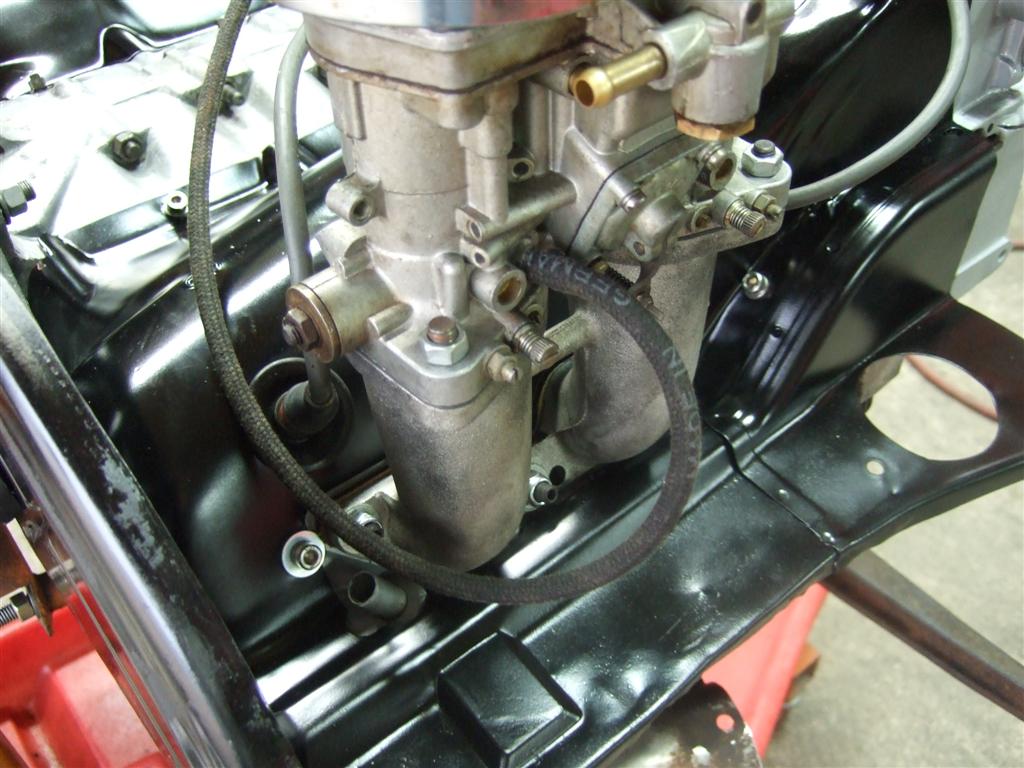

found a pic of the carb, specifially the back that I'm talking about...
it's different than the others I've seen, but maybe ACE can fix them

Um... have you taken off that nut and looked behind that round washer? You'll find the shaft bearing there.
ME733
.........YEP.........take off the nutand washer......and there she-be....AND It looks like you have an adjustable acc.pump .....the thing between both bores, has a rod with a spring behind it, attached to the cover in the middle of carb....this means ....YOU DO NOT HAVE the oldest design weber., and yours should be able to repaired easily.....I too understand ACE...does quality work, and has parts.

What number (in that diagram I posted earlier) are these bushings you're talking about. I have to confess, I don't know what you mean.

where did you get the screws (diagram #40)for your butterflys when you reinstalled them were they steel or brass?.
I used steel ones (with an allen head, not a sloted head). I also used loctite on them.

When you put the butterflies back in, slide both into the shaft (they only go in 1 direction - on my 44s, the stamping (78 degrees) is visible from the bottom (if I recall). it'll be obvious if it's not right, because the screw holes won't line up. Anyhow, put the screws in loosely, make sure you "close" the throttle so the butterflies are seated properly in the bores, then tighten the screws. It might take a few tries - so be patient. When you get it right, they close with a most satisfying "snap"! Also, you can't see any light around the edges when you hold it up to the light and try to look through.
