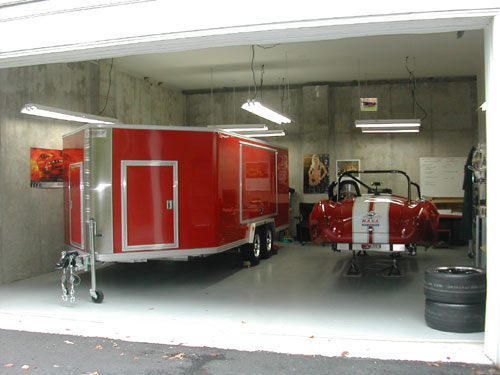

QUOTE(Van914 @ Apr 27 2010, 06:24 PM) *
My friends red cobra race car is pictured in their ad. He uses a Chevy avalanche with a big v8 to tow. Not only to handle the weight (car is only 1500lbs) but to keep in control when wind gusts from side. Not going to be able to pull a trailer like that with a subie wagon.

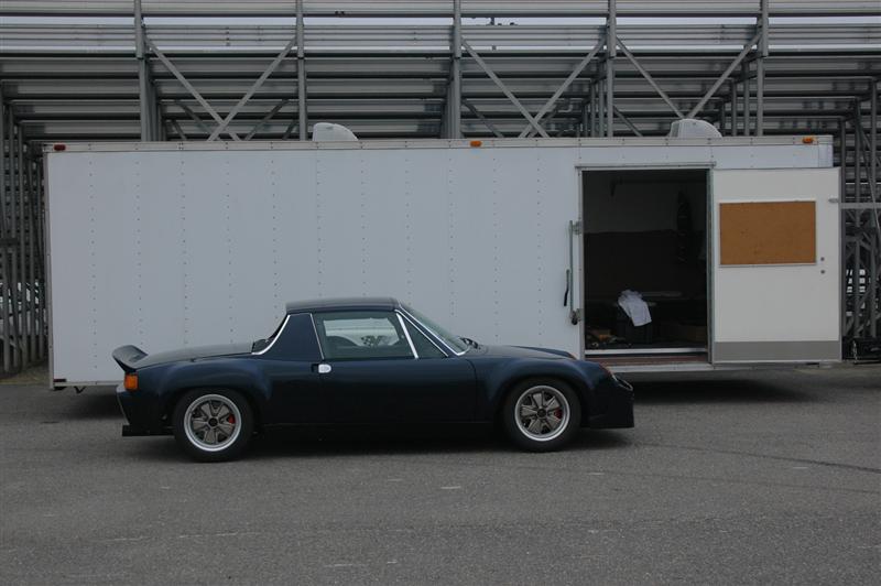

I love my 24 foot inclosed,and so does my car ..not only does it keep rock chips and bird poop off the car ,but also the UV damaging rays and the rain,The car pretty much stays in the trailer when i`m not using it and that leaves my shop open for other toys.....trailEX makes a real nice low profile covered trailer with a big side door for getting in and out....and would be well within your MDX` towing capacity.......Paper towels will scratch the paint! just say`n...

QUOTE(6freak @ Apr 29 2010, 08:24 AM) *
Not to mention prying eyes and vandals while at motels overnight and rain encountered along the way..... (IMG:style_emoticons/default/biggrin.gif)
