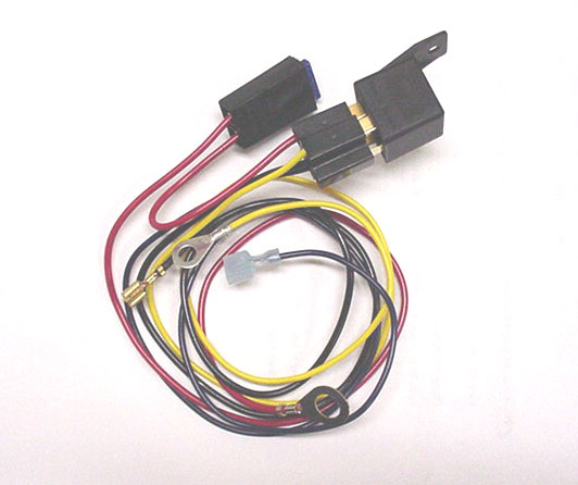

my dad bought me some kind of Bosch low voltage relay thing but I haven't had a chance to look at it to much. I will take a picture of it tomorrow. It goes on the starter but i'm not sure what it does. I have an extra starter here I can swap out. but I am curious to see what this Bosch thing is supposed to do? Does anyone know what I am talking about?
silverteener
post May 18 2010, 08:58 PM
Posts: 214
Joined: 9-August 05
From: East Moline, IL
Member No.: 4,566
I found what I have on the bird.
Hot Start Relay Kit
914 1.7/1.8/2.0 (1970-76), 914-6 (1970-72), Each
You guys think I should put this on?
underthetire
post May 18 2010, 09:01 PM
Posts: 5,062
Joined: 7-October 08
From: Brentwood
Member No.: 9,623
Thats a relay to help with hot start problems. My car had something like it on it when I got it. Basically it takes the high current load off the ignition switch for the starter solenoid. Kind of a band aid I think, but they do work. Mine was removed when I put the new starter(s) in and have not had a problem.

Well I still have this problem. I haven't put the other starter on yet but it's not in the best shape so I'm not sure it will work. I've driven the car the past couple days and it has started with no problems. I just went out to go somewhere and it won't start again. It sat for about an hour since I got here to work. I felt the selonoid and it does not feel hot. I guess I'll try putting on the hot start harness and see if that will help. I don't have the money for a new starter right now. I guess I'll have to jump the starter today huh.
Drums66
post May 28 2010, 01:02 PM
914 Rudiments
Posts: 5,321
Joined: 15-January 03
From: Coronado,Cali
Member No.: 151
QUOTE(underthetire @ May 18 2010, 08:01 PM) *
Call it what you want? but.........I have'nt had an issue since I put 1 on!
( been many many moons)
P.S. even after long periods of sitting!)
SLITS
post May 28 2010, 01:06 PM
"This Utah shit is HARSH!"
Posts: 13,602
Joined: 22-February 04
From: SoCal Mountains ...
Member No.: 1,696
QUOTE(silverteener @ May 28 2010, 07:24 AM) *
It's not so much the solenoid getting overheated, it's the contacts inside that get burned and do not make good contact. Try whacking it with a hammer (or other suitable tool). On old Chevys we would take the solenoid apart and filp the copper contact disk inside ... wella, a new starter (almost).
Oh, and for a hot start relay, I use a cheap ass Ford solenoid ($6). Doesn't come with the wires, but comes with instructions. Anybody need one or some?
