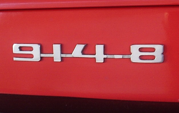

Here's mine, from another source, that I've had for about 5 years. I think I'll be picking up one from you as a spare or for the interior. I half expect someone to pry this one off at some point.

You might try a small radius at the sharp corners of the letters/numbers (top-right for example of the polished "2") & add a bit more of an eased top edge all around, as you can see in the "914-8" one in the pic above. The factory ones "fall-off" a bit at the edges like that one does, rather than being flat with a small smoothing on yours.
