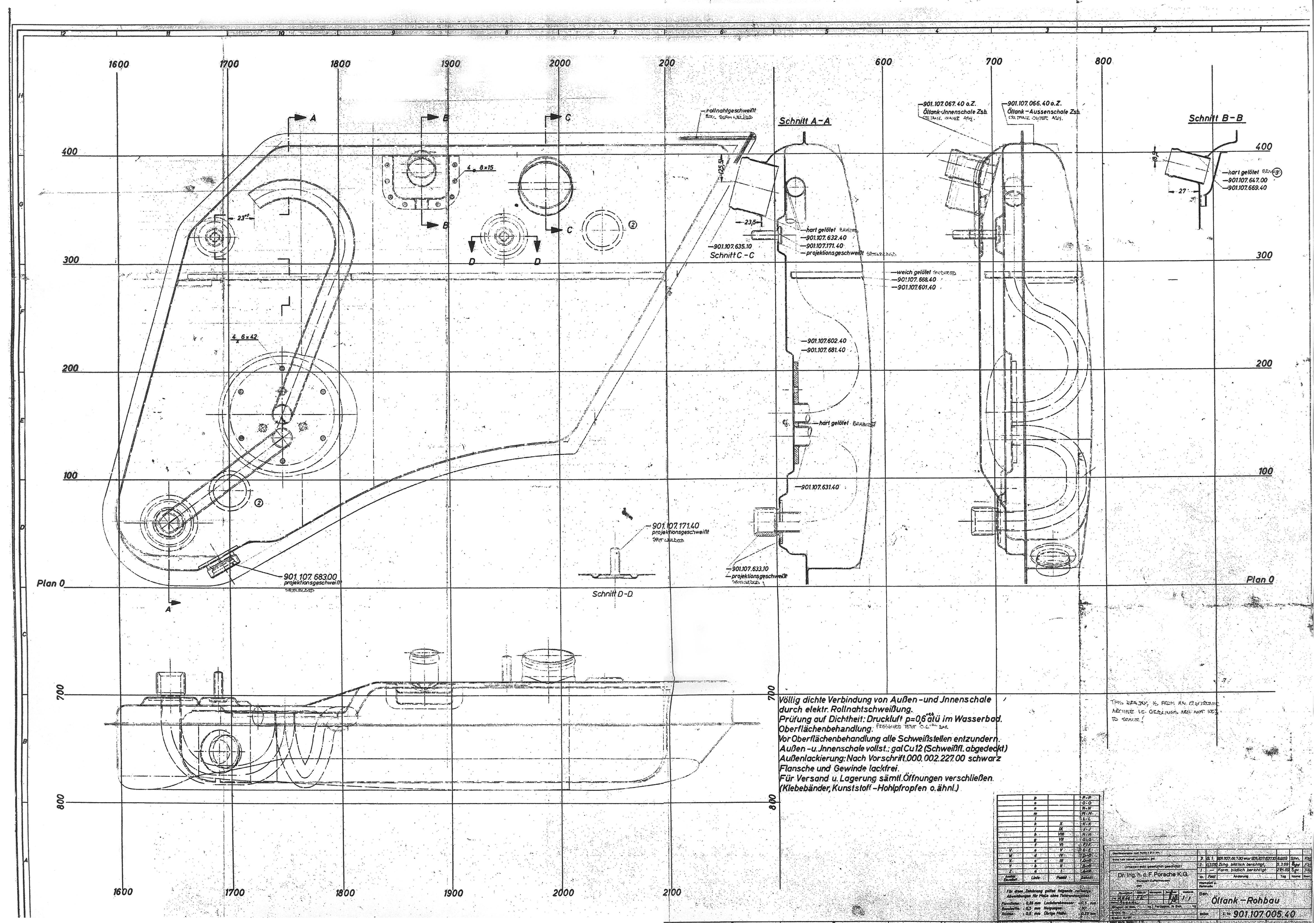

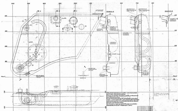

Drawings found on this thread!!! Does anyone still have the large original?
http://www.914world.com/bbs2/index.php?sho...c=45335&hl=

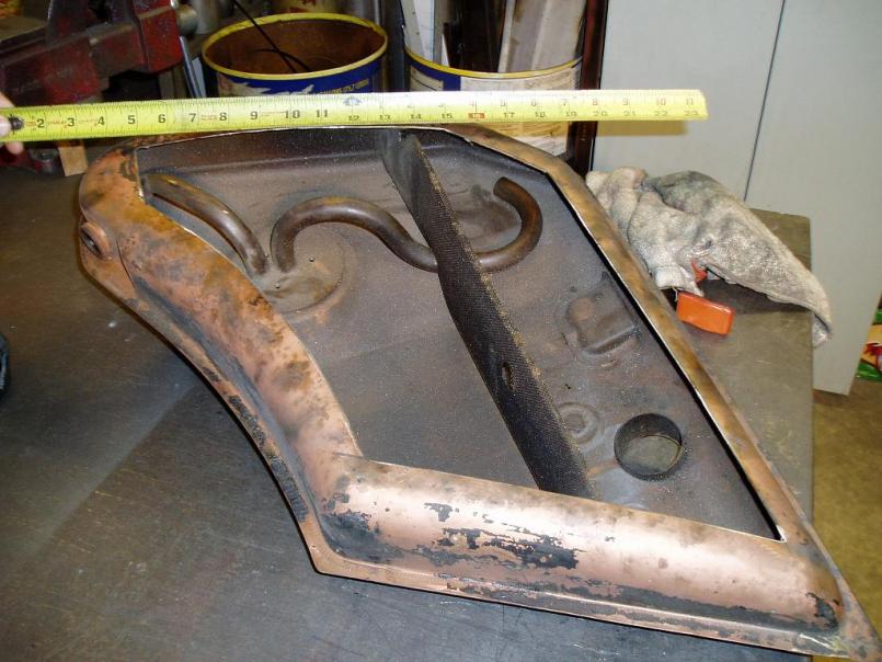

I boosted these photos from someplace... (IMG:style_emoticons/default/confused24.gif) (IMG:style_emoticons/default/biggrin.gif)
rick 918-S
post Aug 4 2010, 07:28 PM
Hey nice rack! -Celette
Posts: 21,239
From: Now in Superior WI
Member No.: 43
How much do the filter consoles and filler necks cost and where can you purchase them? BTW: The screen is knocks the air out of the falling return oil. The one in the aluminum tank looks like it have quite large holes compared to factory tank. This is the key to building a good tank IMHO.

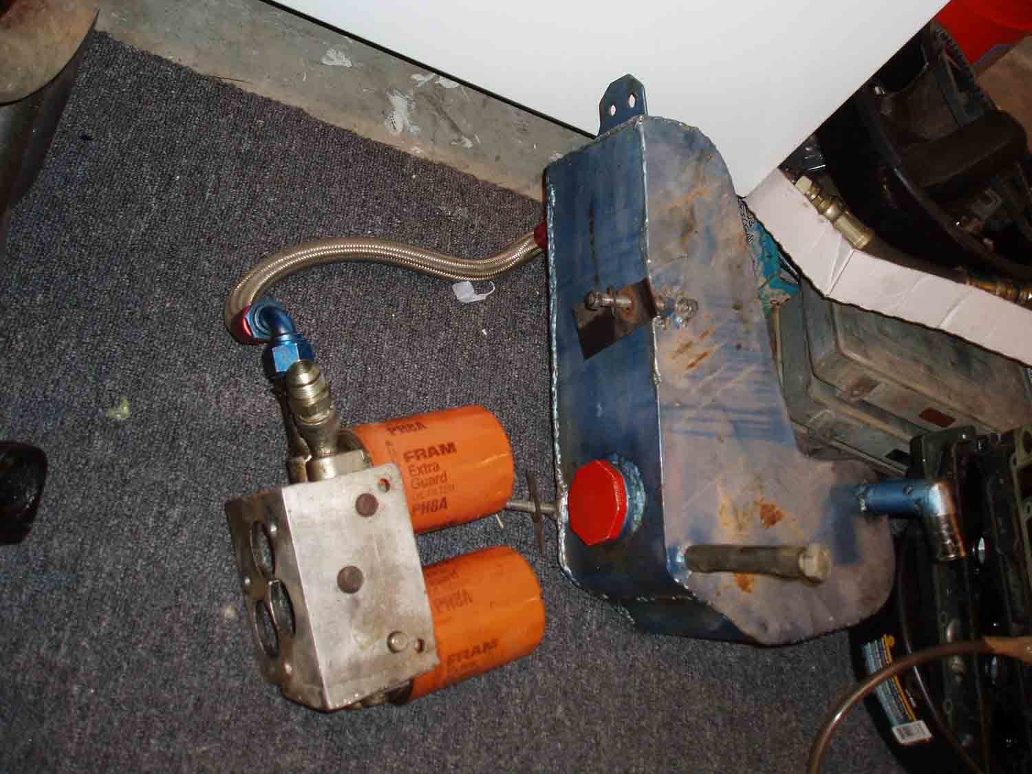

If you are building your own, why not simplify it and place the filter vertically, and remotely? Make the tank a tank, oil in the top, out the bottom. No?

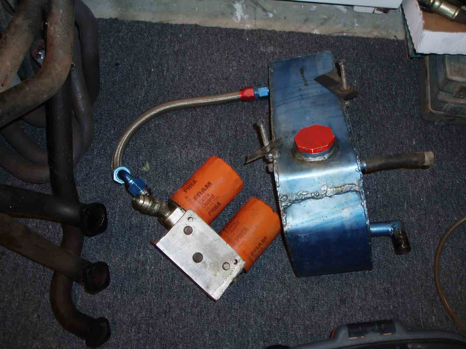

Since we have two threads going here is the photo of what I have to get rid of!!

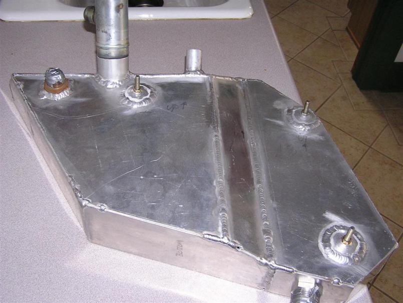

another

Sir Andy, links are dead. Do you still have this info floating around in cyberspace? Mike's looking to see if he still has them also. I'm hoping you can just fix the links so I don't have to worry about email size limits.
Thanks
QUOTE(michel richard @ Jan 31 2006, 11:09 PM) *
With SirAndy's help, I have uploaded a couple of versions of the factory drawings for the /6 oil tank.
I have a copy that was made by the factory from a database of digitized drawings. The copy that I have is pretty big, not in front of me, but something like 3 feet by 4 feet. It shows the tank full size.
I had it scanned, and I got three files, two of which I uploaded: a 22meg pdf and a 7 meg (approx) Jpeg.
Here's the pdf link:
http://www.914world.com/videos/plan.pdf
and the Jpeg:
http://www.914world.com/videos/plan.jpg
Big files of course. If someone is able to reduce one of them to make it easier for those who don't have the latest connections, please do so.
The third file is a .psd extension. Dunno what that is, but it's 48 meg !
Michel Richard

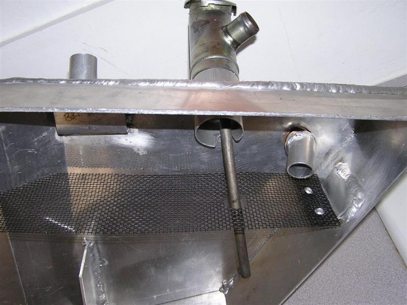

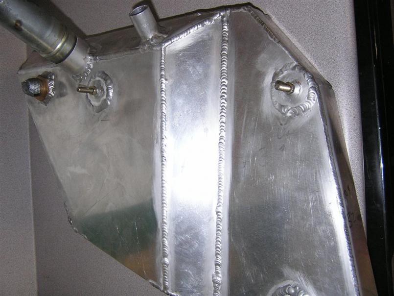

The aluminum tank is mine. I built it as a welding class project. It does fit in the stock location. There really isn't any plumbing inside of it. There is an inlet that directs the "fall" of oil over hte screen. There also is a breather that has a baffle partially covering it to keep oil slosh from directly exiting. I also baffled the bottom of the tank to potentially improve corning oil over stock.
but it really doesn't have any plumbing in it. The stock or nice repro tanks have tubing so that returning oil is forced through the filter prior to dropping into the pool below.
I skipped that for better mounting flexibility and am going to use a remote oil filter.
With the stock filler neck and dipstick, this tank has about 175$ in supplies alone. If someone was paying for labour, professional welding, and the costs of tooling, I don't think the prices of aftermarket tanks are making anyone rich.
