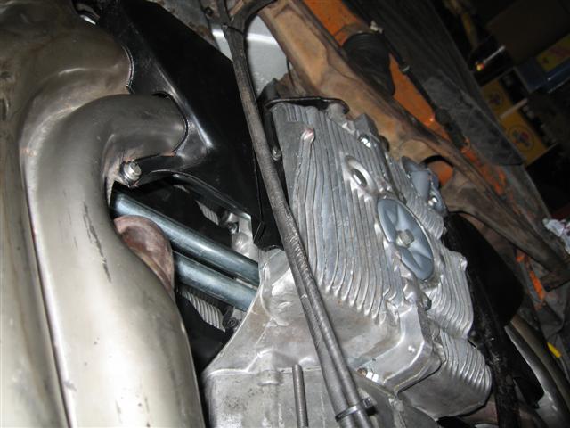

QUOTE(ppetion @ Oct 27 2010, 07:42 AM) *
YES IT HAS A BOLT AND AT FIRST I DID IT REAL TIGHT WITH A WRENCH, THEN AFTER HEARING THE NOISE, I TOOK IT OFF AND PUT IT BACK. i TIGHTEN IT WITH A WRENCH BUT NOT TOO TIGHT.
Can this round plate shown in this picture cause my issue. what is the function of this plate and how tight it has to be?Attached Image

If you overtightened the bolt, you could have cracked the boss it goes into ... very bad ..... but I can't see a "squeal" coming from it. Plate does nothing but cover a big hole in the case, and hold the oil strainer in place.
It is possible that the starter solenoid could be questionable and not pulling the Bendix gear back into position and it is hitting the fly wheel, but I don't think that would make a squealing sound ... more of a grinding sound in my estimation.
If from the starter, the squeal could be the bearing/bushings in the starter motor are getting ready to take a crap.
Can't see why unplugging the coil would make a difference.
Next guess would be the impeller/ alternator belt hitting the engine tin due to loose/missing fastners, very loose belt or a worn belt.
Last guess would be the rear main seal. I had an engine that would chirp like a bird when running. Lips on rear main seal blew outward from internal pressure in the case (blowby).
Next .......................
The answer to the first part of the question is maybe (notice maybe, other things need checking first). That nut screws onto a the oil pickup tube and tightens the sump plate up. Unfortunately, VW's design was in my opinion kind of weak since an eye on the top of the oil pick up tube is capture by 8mm case bolt. The problem with tightening it more that the 9.6 ft/lbs of torque is that it can break the boss for that case bolt and that boss is integral with the center camshaft journal. It may be that the cam bore is not true now.
There are probably a bunch of other possible cause to pursue first. I can think of 2 I would start with, checking the area near the fan for something loose, checking the tension on the alternator belt to see if it is slipping.
