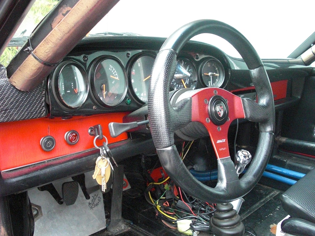

I used the early style from a '73 911. I'm happy with the result ... (IMG:style_emoticons/default/smile.gif)
http://www.914world.com/bbs2/index.php?showtopic=82045
(IMG:http://www.914world.com/bbs2/uploads/post-179-1255287369.jpg)
(IMG:http://www.914world.com/bbs2/uploads/post-179-1255289824.jpg)

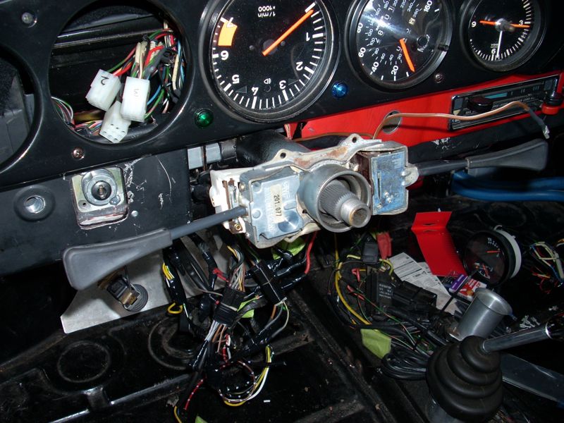

late model
early
early

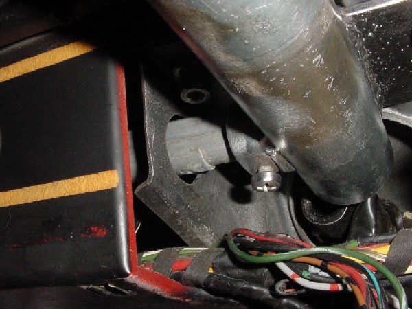

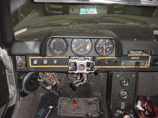

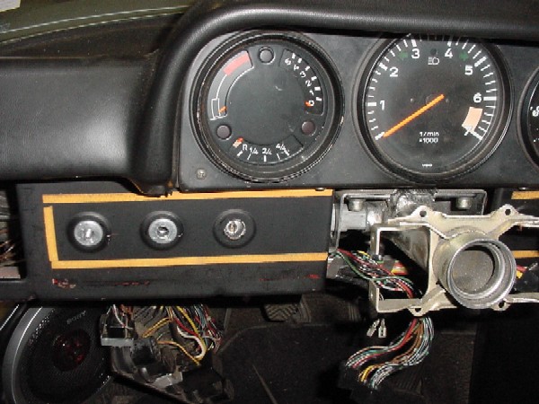

Dash mod....

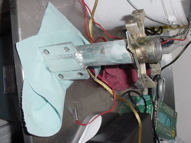

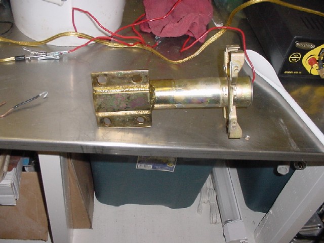

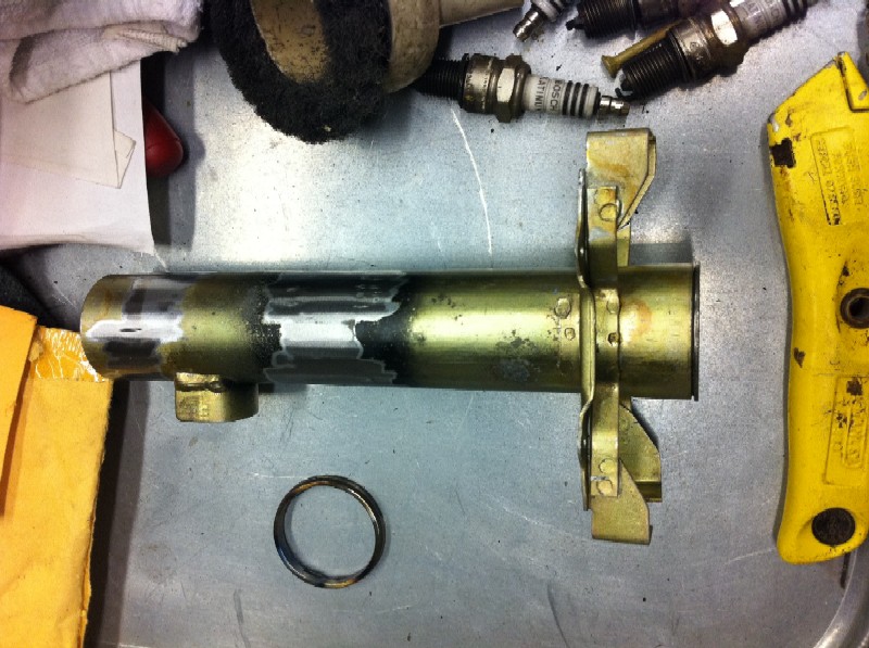

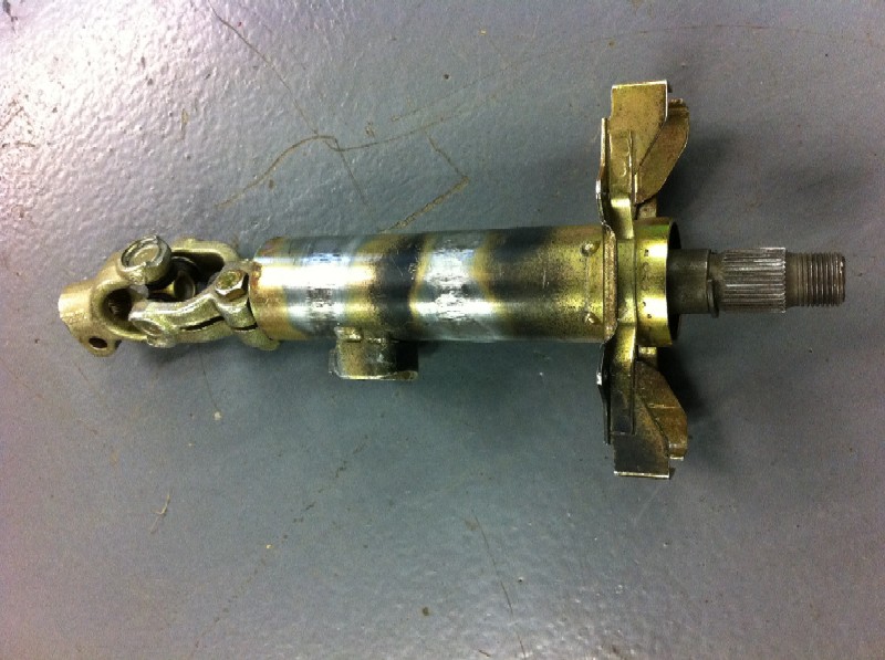

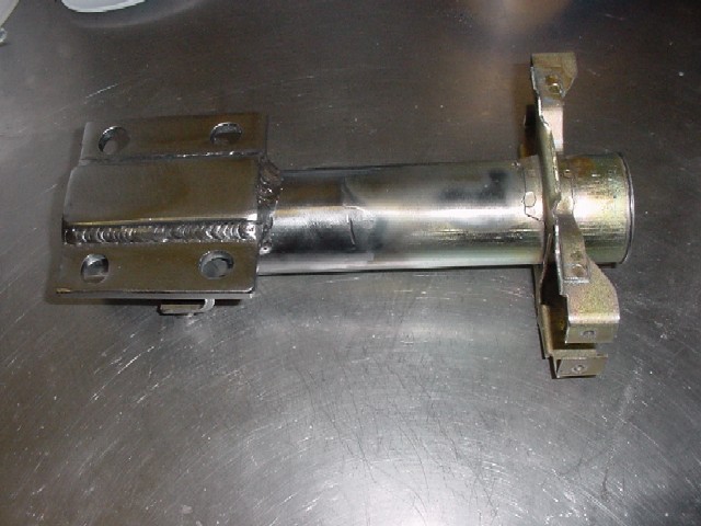

I re-did the mount plate lowering it down a bit.
Ready for Plating
Zinc Plated
Yellow Chromate

QUOTE(John @ Jan 21 2011, 04:01 PM) *
Dash mod....
(IMG:style_emoticons/default/thumb3d.gif)
I used the attachment piece from a 911 dash and left some metal around it to mate it to the 914 dash.
It's not a perfect fit as the angle is off just a bit compared to the 914 dash sub-frame.
Yours looks nicer ... (IMG:style_emoticons/default/biggrin.gif)

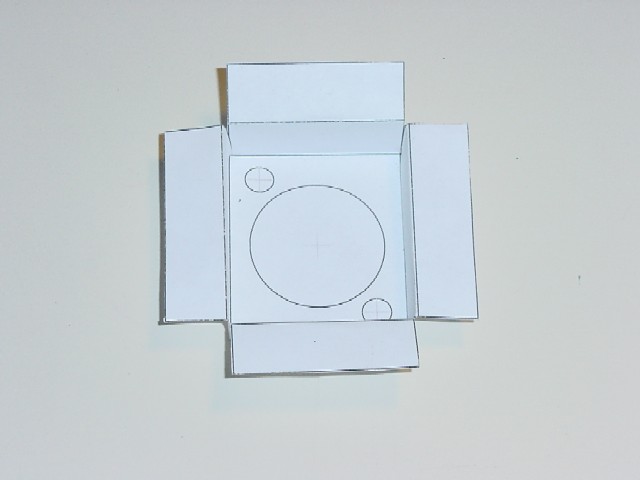

QUOTE(SirAndy @ Jan 24 2011, 10:00 AM) *
Dash mod....

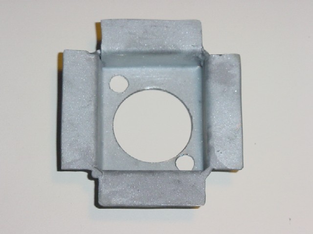

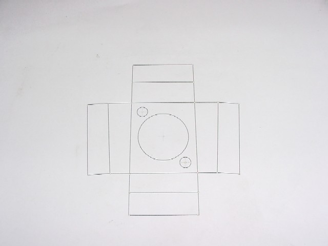

I didn't have the 911 dash piece. I carefully determined the angle from the stock 914 steering column and the dash face and built the box for the key lock. I made a 1:1 drawing, cut it out, verified my dimensions and made one out of sheet metal.
I'll pop rivet it into the dash when I get to that point.
I turned down a 911 rose because in true CSOB fashion, I didn't want to buy one when I could use my lathe instead.
More pics as I progress.

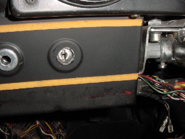

Here's mine mounted, like i said, yours looks nicer ... (IMG:style_emoticons/default/biggrin.gif)

'73. The best one i could find, and yes, the switches still look pretty good. But I do need new decals for the faceplate.
Btw. in my picture it looks like the dash plate for the lock is just hanging there with a large gap, but in fact the 911 sheetmetal i used forms a "cup" just like the one you made. It's not quite as ugly in real life as it looks in the pic. And yes, i did rivet that piece as well.

post Jan 25 2011, 10:06 PM
member? what's a member?
Posts: 3,393
Joined: 30-January 04
From: Evansville, IN (SIRPCA)
Member No.: 1,615
So Andy, since you have done this, I have a question that I have been debating with myself for a while.
Let me explain. The 4-cyl stalk had a momentary contact to "toggle" the dimmer relay to switch between high beams and low beams. The 911 stalk has both a momentary contact as well as a two position switch. As it is wired in a 911, the two positions are for high and low beams. The momentary contact allows the headlights to flash low beams. Since the 914 headlights are hidden, it makes no sense to be able to flash the low beams.
My question is: Did you eliminate the headlight dimmer relay and utilize the two position contact on the stalk or did you utilize the momentary contact and wire that to the headlight dimmer relay? I know yours was once a 4-cyl steering column before thieves tore it all up.
I'm strongly considering only using the momentary contact to drive the dimmer relay. I already have a fog light flash relay that will continue to operate if I do this. It may not work exactly like it should, but it would work.

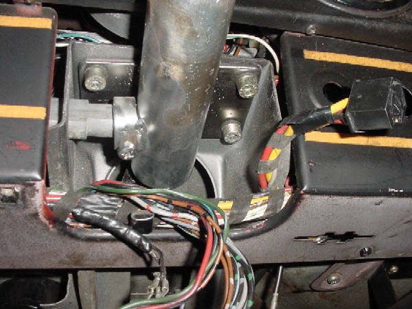

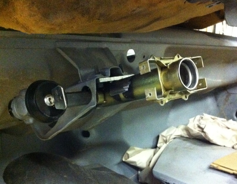

Minor setback.
I made my bracket fit my 71 unit body, but this is going in my 74. Who knew the bolt patterns changed between years?
Gotta re-make my bracket.....

QUOTE(John @ Feb 5 2011, 06:57 PM) *
Yepp, early and late have different bolt patterns.
I found that out a few years back when i replaced the main wiring harness in my '70 with that from a '74 and i went to install the '74 steering column.
Ooops ...

Setbacks.
Oh well, it's just cutting welding and grinding....
It's amazing that the ignition switch almost lines up with the existing Emergency Flasher switch hole.
I'm moving the fog light switch to the other side (only 3 wires to extend).
