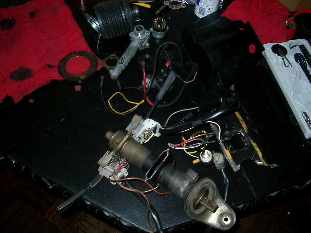

finally made some progress with this ...
the column itself is from a '73 911, i also got the correct year momo steering wheel adapter, a '74 ignition switch assembly (supposed to be better than the pre '74) and the sheetmetal from the 911 dash with the mounting recess ...
here's a picture of the lot:
first order of business, rekeying the ignition lock. this is a major pain in the butt as the lock can only be removed by drilling out a rollpin. (IMG:style_emoticons/default/headbang.gif)
there's a good tech article on pelican on how to do this:
http://forums.pelicanparts.com/showthread.php?t=348306
i've finished the ignition rekeying and now i'll be spending the rest of the day cleaning off the 35 year old grime off all the parts

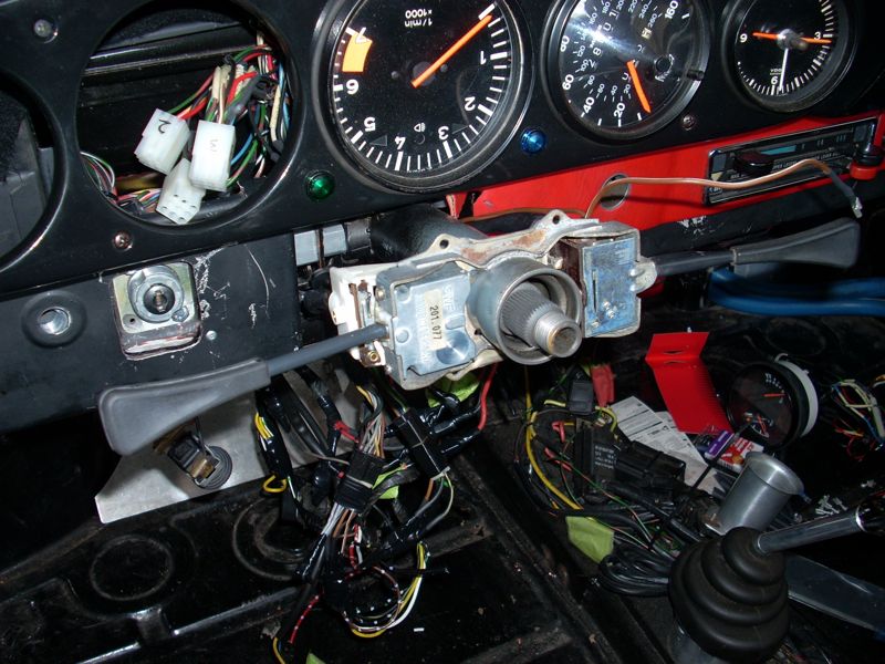

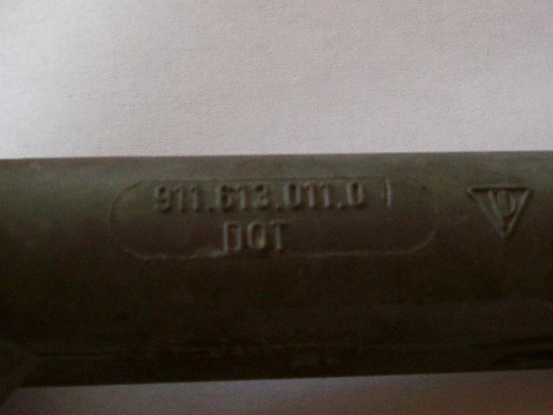

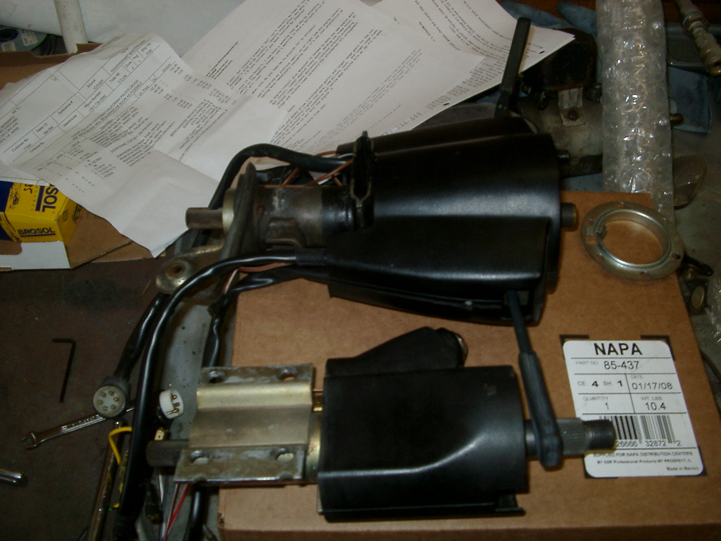

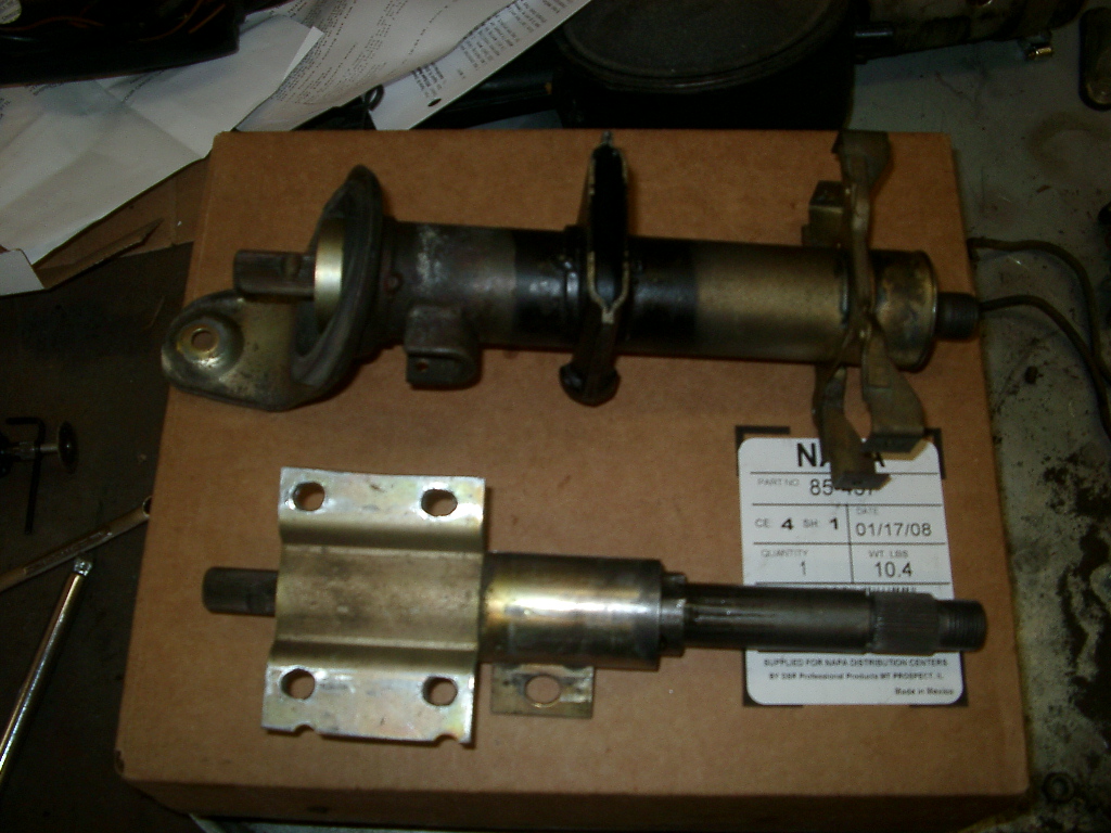

post Oct 11 2009, 12:39 PM
Resident German
Posts: 42,517
Joined: 21-January 03
From: Oakland, Kalifornia
Member No.: 179

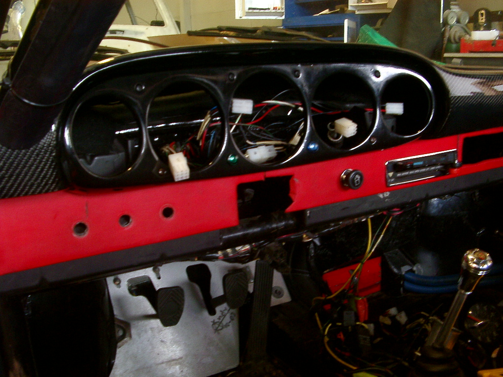

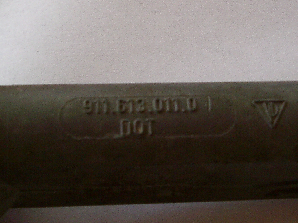

Alright, let's finish this thread off with some more pix! (IMG:style_emoticons/default/biggrin.gif)
911 Ignition Switch #911.613.011.0
911 column and 914/4 column side by side:
My dash before the operation:

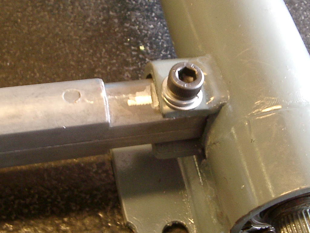

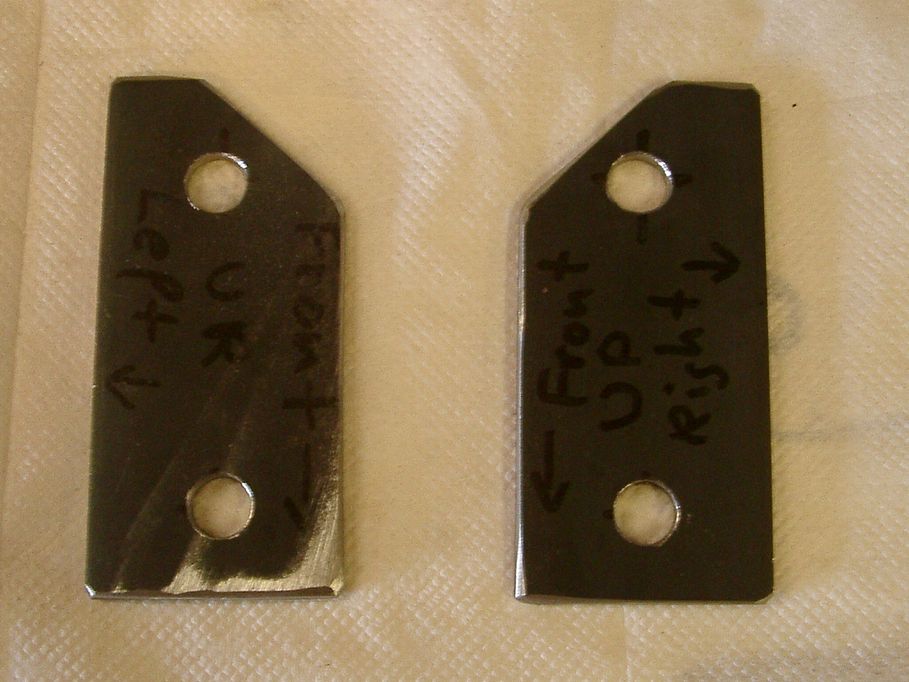

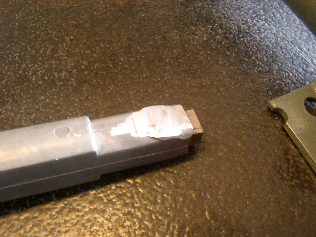

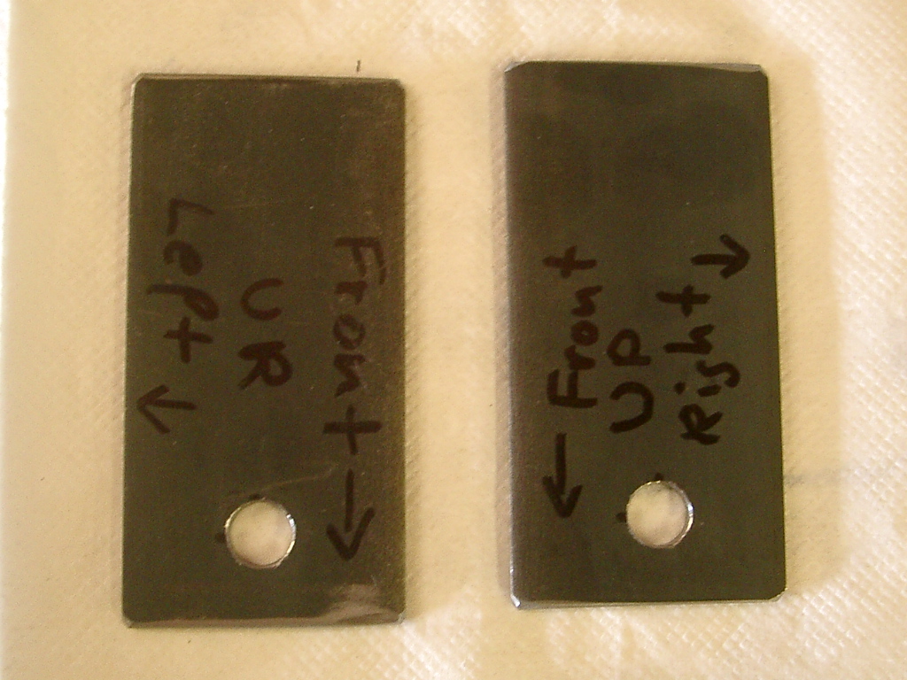

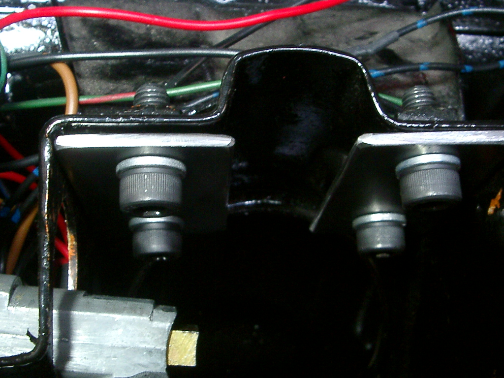

We then removed the original mount and the end bracket from the 911 column and added our own mounting tabs.
The location of the mounting tabs was determined by aligning the 911 column and switch with the dash and then marking the spots on the column.
Mounting Tabs before and after fitting:
Testfitting the tabs:

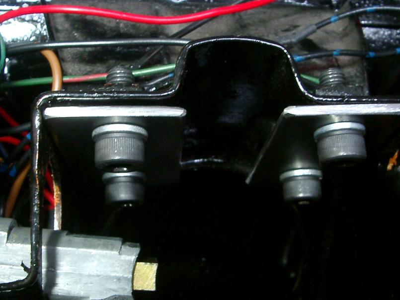

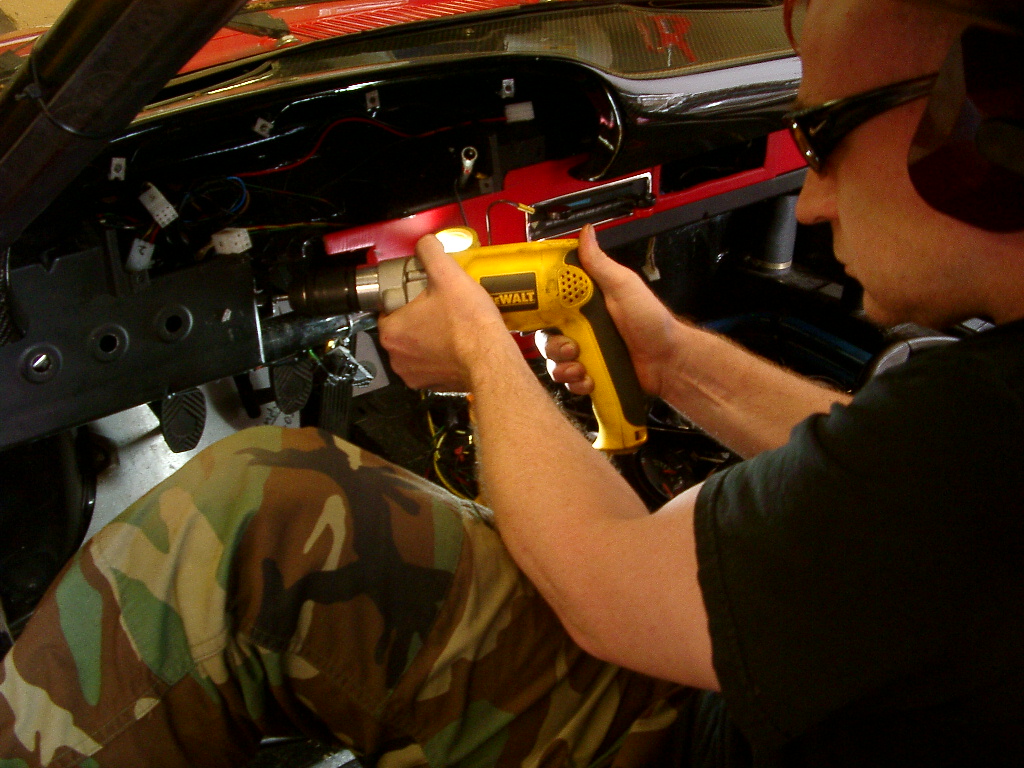

The hole where the 911 switch passes through to meet with the column had to be enlarged a bit as i'm using a later model switch on an early column.
For the same reason, the lock part of the switch needed a little "adjusting" to work correctly with the column.
post Oct 11 2009, 12:53 PM
Resident German
Posts: 42,517
Member No.: 179
Testfitting the assembly:
Note that i used a piece of the original 911 dash to fab a mount for the 911 switch where it meets the 914 dash face.
I riveted the sheetmetal mount to the 914 dash and secured the switch with two bolts. Worked great.
