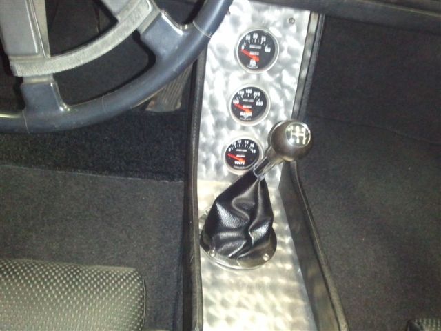

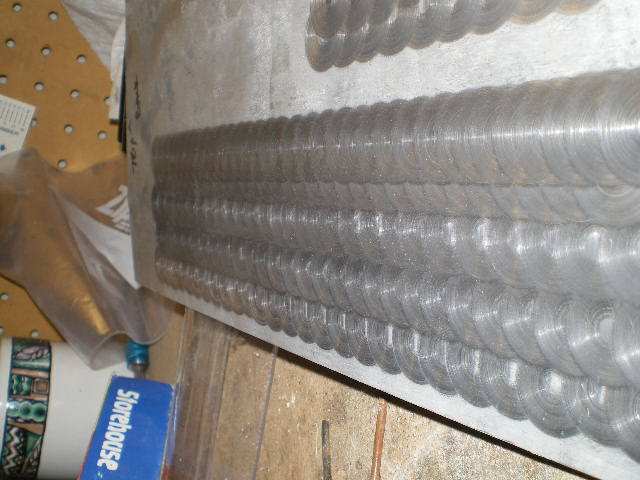

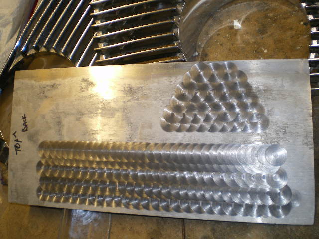

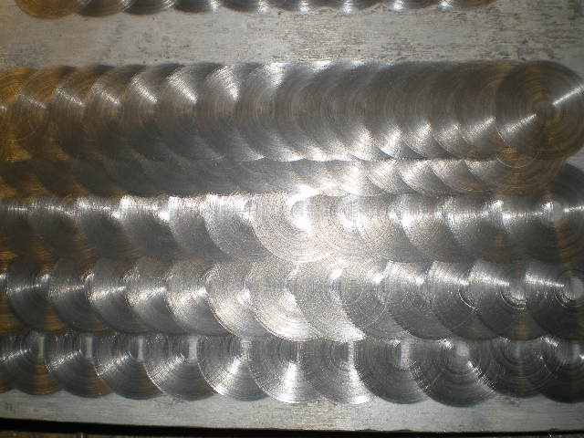

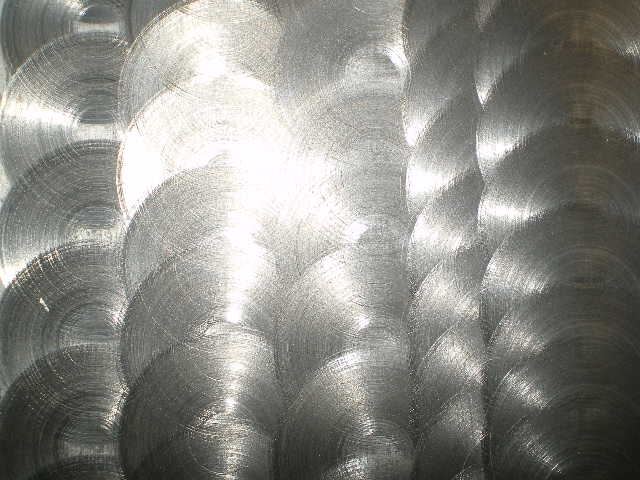

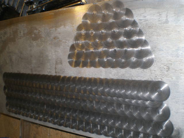

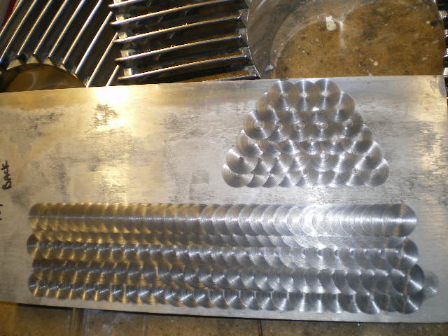

I might give this a shot on this '73 that I'm hacking on. I've got a console that I wanted to get creative with so I grabbed some .032 aluminum and cut a few pieces to play with for gages or maybe an engine monitoring system? Dash? The idea is to do this on the home bench press and to K.I.S.S. I've realized that 5/8" circles aren't my choice. I'll probably use 1.5" or 1.25. The final blank will be polished before the circles are set, to maintain uniformity. I might play with a black die to tinge it before a clear coat as an after thought. In two of the pics I think you can see that I staggered the spacing. It makes a neat visual effect where the two meet. BTW, this was free hand on one plane. Currently at the "Farting around in the garage, again" stage. (IMG:style_emoticons/default/smash.gif) (IMG:style_emoticons/default/sawzall-smiley.gif) Or maybe my cam will come early and I'll say "Screw this nonsense; I'm putting my engine together." (IMG:style_emoticons/default/lol-2.gif)

Looks good! What did you use for a tool?

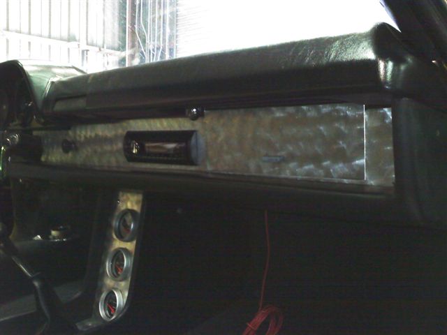

I used the same thing recenlty on my dash, center console and radiator shroud. It gives it a different look. I will get used to the interior but I may change to polish aluminum.

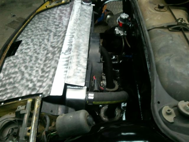

Hard to see but I did that to my adapter plate

I think it's an interesting look. Very aircraft....
If it were me, I would order a sheet or two of professionally done aluminum. On those plates all the circles are evenly spaced.

QUOTE(jasons @ Mar 25 2011, 06:37 AM) *
http://www.averytools.com/prodinfo.asp?number=201 You can purchase these pieces individually. OT: If you hate cheap drill bits, buy some of Avery's cobalts bits. They stay sharp longer than any bit I've ever used. But then again I'm not a machinist and privy to the best. This is a very professional small Mom & Pop company.

QUOTE(McMark @ Mar 25 2011, 02:53 PM) *
Yeah, I can see it on the adapter plate. I love it!! Are those aluminum heads?
(IMG:style_emoticons/default/agree.gif) It's absolutely imperative that the spacing be exact. I noticed that early on. I'll probably use something like a set of dominoe's or leggo's to use a guaging blocks. If I end up with something that I feel is presentable and doable I'll do a quick threead or video on it. BTW Mark, I didn't know how to source this material, either. Who sells it?
