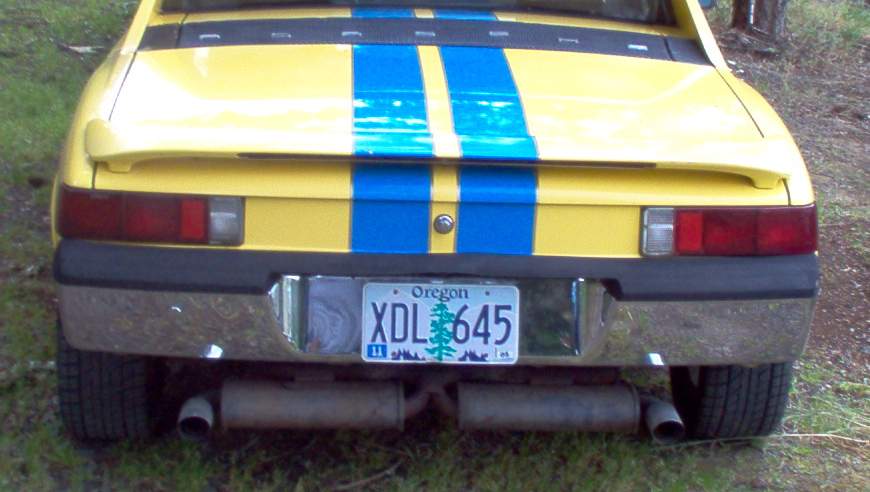

i really like the look of mine. it's a more or less standard spoiler, but it was cut (in the middle) to fit the decklid and DON"T overlap onto the fenders, then molded in.

SirAndy,
Nice Car! Very nice use of the spoiler. Di you customize it, or find it like that? Also, I am looking to add the same sort of flares to the front and back fenders. Can you give me some insight into doing so? For example, where do you get the parts, how much does it cost, etc.?

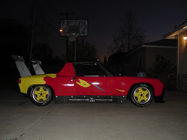

Do you want a spoiler or a wing?

andy, that spoiler seems taller than most ive seen, and is exactly what im going to do. can you list the specifics on where it was bought etc. also, i love the look of it not overlapping onto the fenders-much cleaner IMHO! also, how hard was it to cut and finish glassing it in?

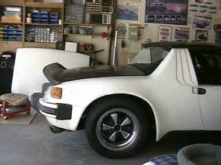

Here's a pic of mine. Its a one piece fiberglass deck lid and spoiler.

QUOTE(acox914 @ May 26 2004, 10:28 PM)
a much interested admirer (IMG:style_emoticons/default/biggrin.gif)
well, as much as i'd like to take credit, this was done by the PO ...
what you can't see in the picture is the amount of FG and Rasin and Bondo he used. (IMG:style_emoticons/default/wink.gif)
j/k, actually, it's not too bad.
the spoiler was cut in the middle, then glued to the hood.
then a layer of FG-Cloth and Rasin over the top and around the edges.
he also went as far as about half the width of the hood forward.
this gives it a lot of strength and prevents it from cracking.
i can literally put all my weight on the spoiler (with the hood closed, duh!) and it won't budge.
