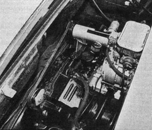

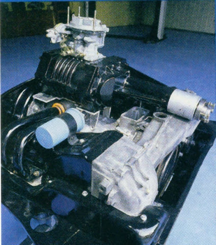

Back in the early-mid '90s there was a shop in the Port Orange/South Daytona area that did it a few times. The intake runners from the stock injection where used with a 66CID roots style blower & a big carb. IIRC, the blower made ~6lbs of boost and the engine put out maybe ~175hp. It's a pretty low tech setup when you consider the hotrod parts, engine managment systems, and information that we have access to now, but this was super badass back in the day. One of the supercharged cars this shop built made it into a VW & Porsche magazine. I have a scan of the article I can post if anyone wants to see it.

Here you go. My current project car is one of the supercharged cars that came from this shop. The motor in mine was blown up and is long gone, tho. I've seen 2 more of the cars recently that are still on the road. Anyway, here is the article.

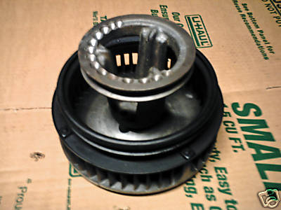

You could use the crank pulley for the smog pump to drive the SC

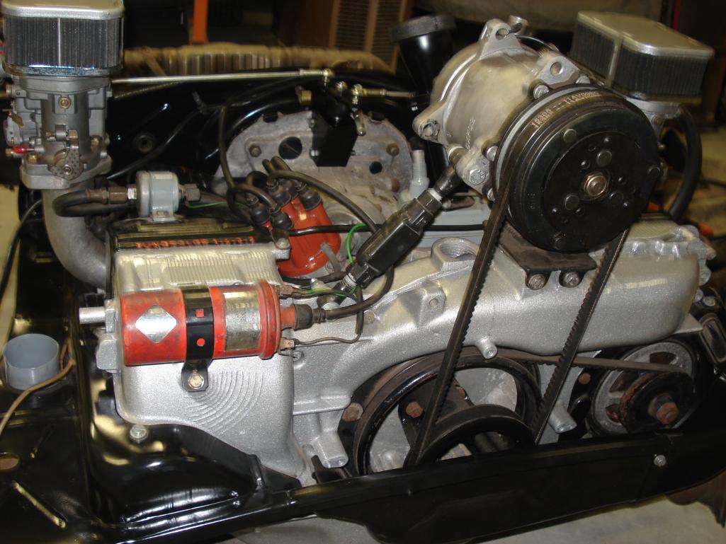

Use a pulley like the one I am using on my A/C setup. I believer they were for bus / type 4 engines.

Problem solved. Nice setup.
