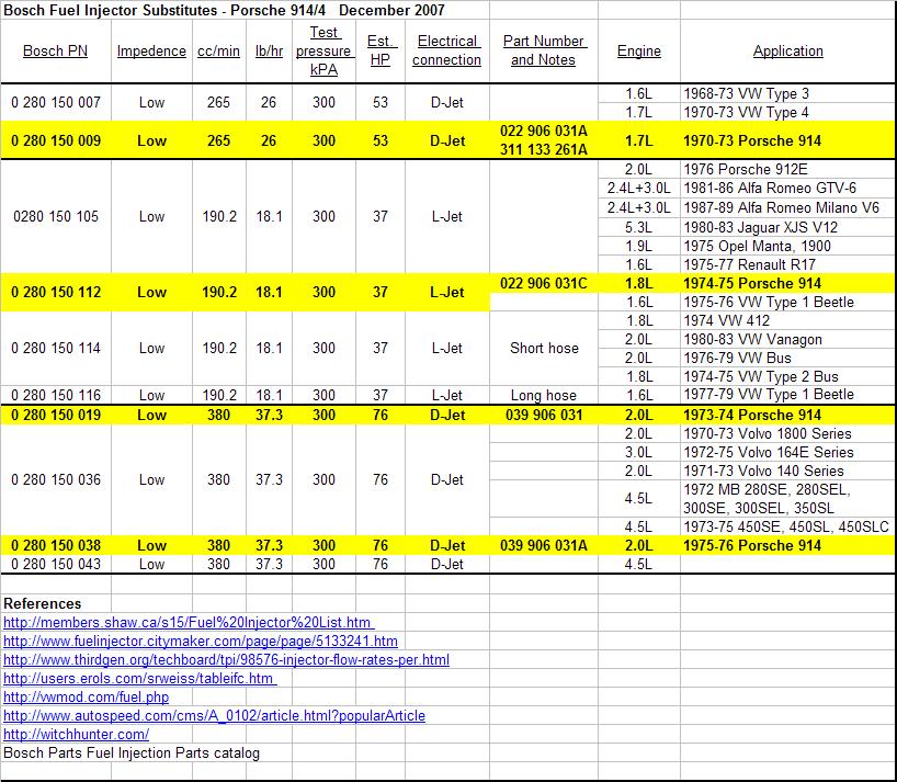

I have 73 1.7 engine that had green injectors installed incorrectly several years ago.
The green injectors are for a 1.8 or 2.0. The green injectors also spray too much fuel.
After I replace the green with the correct yellow injectors, is there any engine adjustments I need to do?
Thank you so much in advance for your response and help.

I just went thru this with a customer's car. she said her MPG was crummy. tail pipe was sooty. swapped injectors, runs like a champ now. i went thru 10 yellow injectors to come up with 4 that sprayed nice and did not leak at the plastic to metal interface

I suggest you check the MPS for vacum and have the injectors checked cleaned and flow tested by a reputabl vendor like Witchhunter or others listed here. When they rebuild the pintile caps they don't always use the same color. I had mine rebuilt and the caps are black now. Most important thing is that they are injecting fuel with the correct rate and with a good pattern and NOT leaking around the base. If you haven't done this in 15 years........Time that you did.

I'll say you were running rich. 380/265 cc/min...about 35% too rich. Surprised you didnt have other issues like fuel diluted oil, I am sure you will notice a performance and MPG improvement with the correct injectors.
