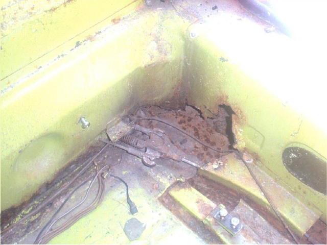

SpecialK
post Sep 12 2004, 12:53 PM
aircraft surgeon
Posts: 3,211
Joined: 15-March 04
From: Pacific, MO
Member No.: 1,797
You guys are right, better to find it now! I just hate these kinds of suprises. (IMG:style_emoticons/default/headbang.gif) Passenger's side is in the same condition, along with a couple holes in the firewall. Pedal area is LOADED with rust, I'm almost afraid to start digging around. Well, time to break out the (IMG:style_emoticons/default/welder.gif)

Man, i feel with you (IMG:style_emoticons/default/sad.gif)
This is the way i went into the world of rust. (IMG:style_emoticons/default/barf.gif)
This is m passenger side, the driver side feels strong.
Posted in an other thread the repair of that shit.
maybe it is helpfull for you.
Fix it, it is a very good feeling to get that old cars back on the street.

Thanks, I'll do a search for the repair thread, I'm gonna need it. Pretty sinking feeling when I started pulling up the carpet. I don't even want to talk about the pedal area (IMG:style_emoticons/default/pinch.gif)
