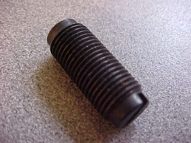

The el-cheapo method is, scew in used 10mm valve adjusting screws.
Phil
