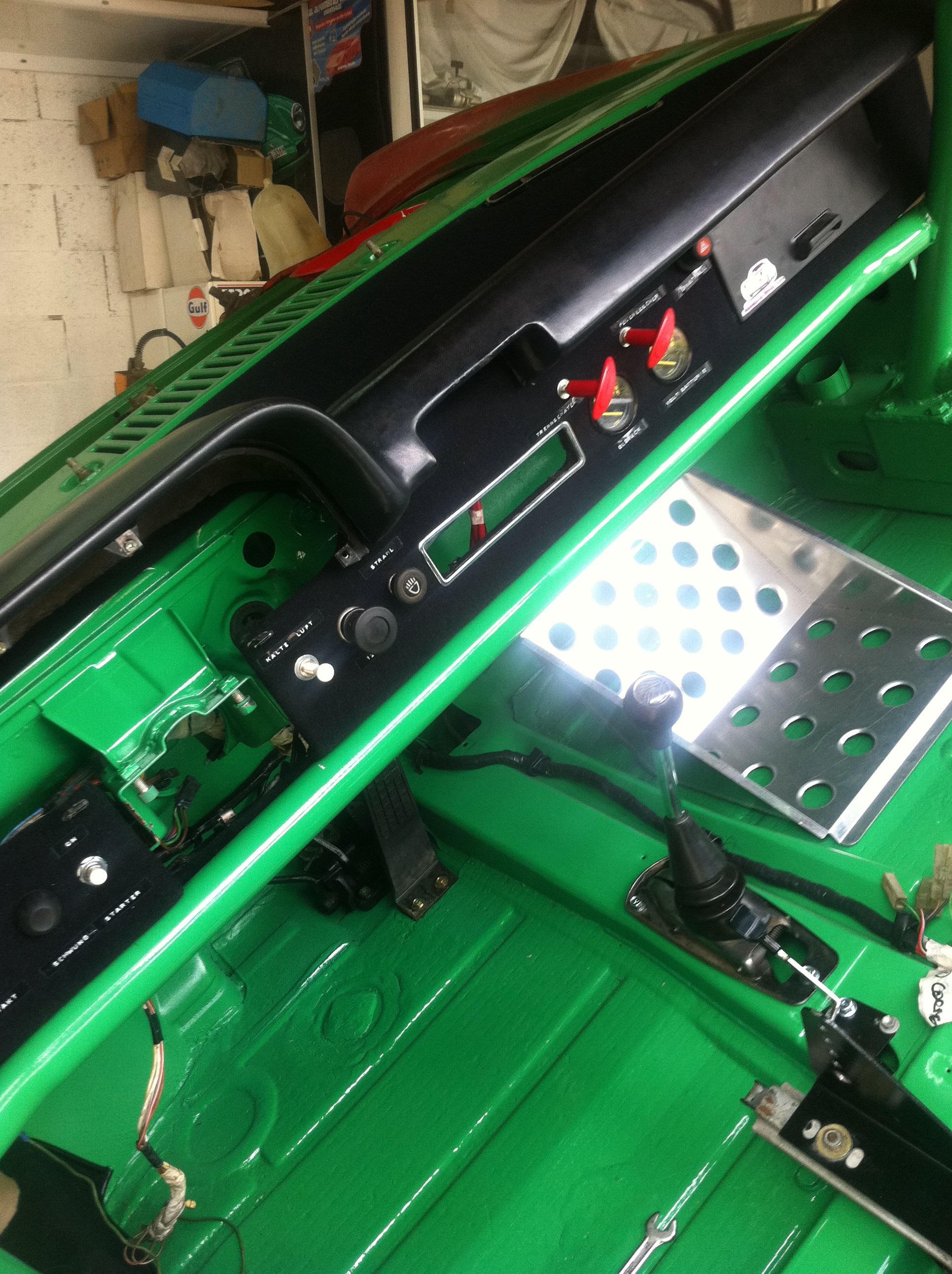

I will some have the same questions for the conversion of my 914 !!!
Finally I buy too one 911 E '73 engine !!!!! (IMG:style_emoticons/default/stirthepot.gif) (IMG:style_emoticons/default/stirthepot.gif) (IMG:style_emoticons/default/stirthepot.gif) (IMG:style_emoticons/default/stirthepot.gif)
And I think Sr. ClayPerrine is the leader on these issues (IMG:style_emoticons/default/pray.gif) (IMG:style_emoticons/default/pray.gif) (IMG:style_emoticons/default/pray.gif) (IMG:style_emoticons/default/pray.gif) (IMG:style_emoticons/default/pray.gif) (IMG:style_emoticons/default/pray.gif)
Now I work on the body of rhe car and soon I working with the engine !!!!!
And because I think the best example in the forums are the pics and
jm993rs
post Apr 14 2012, 07:17 AM
Posts: 68
Joined: 29-August 11
From: Mallorca
Member No.: 13,498
the pics of my 914 6 gt clone !!! (IMG:style_emoticons/default/driving.gif)

Our for make the conversion need your viewpoint, pics, ideas .................
Please (IMG:style_emoticons/default/drunk.gif) (IMG:style_emoticons/default/beerchug.gif)
jm993rs
post Jun 27 2012, 04:01 AM
Posts: 68
From: Mallorca
Member No.: 13,498
Please anybody can give your view point and instructoons because the body work on my car is near of the finish and I need start the work of the mount conversion to a engine 2.4 E on my 914 !!!!
Thank you guys
