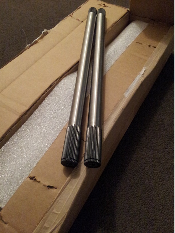

another note, people have asked me several times now why I didn’t go with 108mm CV’s. Because in a drivetrain system the CV joint also acts as a fuse, when too much force is applied, you want the CV’s to go not something in the transmission. So for people who want to error on the safer side, I figured why not let them use the 914 gear. For the high HP guys there is the 944 gear, which Britain Smith has been running without any issues on his monster… why then if those two CV’s happen to have the same spline count would I need the 108mm? How many guys are going to be running higher hp/tq numbers harder than Britain does?
here is a shot of the axles fresh out of the box from SAW
