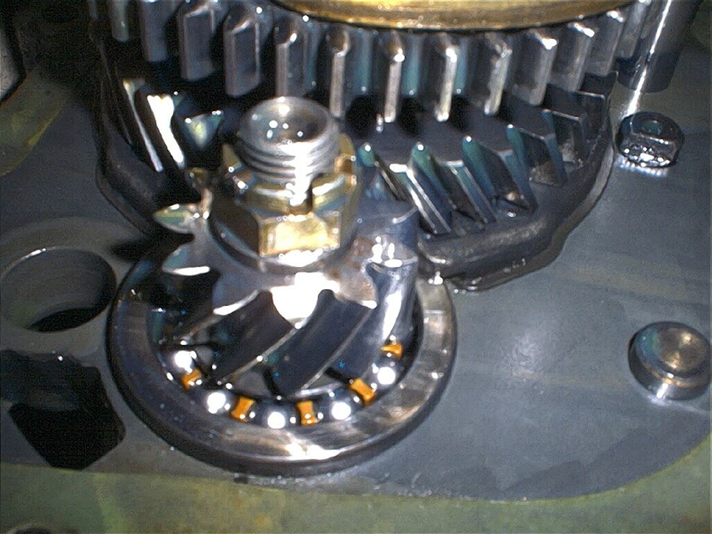

One last shot of the R/1 fork.. sorry it's fuzzy.

Before you re-assemble, I want you to look really close at the intermediateplate bearings. Take photos on both sides and try to see if the bearing cages are whole.
Before you re-install, remove the backup switch and the little pin.
You might want to spray some cleaner on the synchros and dogteeth and take shots, and I'll evaluate the condition of the tranny.

I got my new gasket set and I'm ready to reinstall. First, some last pics of the gears to make sure you can't see anything wrong.
Better shot of the R/1 fork.

Bearing.

That's the reverse and 1st, sir.
