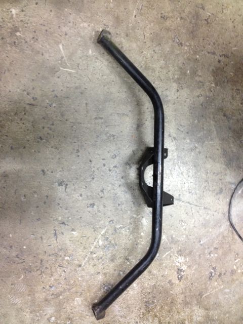

Jonathan - the original "quick six" mount was a bolt in bar that spanned from the "4" mounts and had a six connector at the front. I had one like the top picture in the post above... Broke the welds and had to re-weld it. (IMG:style_emoticons/default/sad.gif)

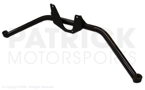

I hope that this is not what you are looking for. They had a number or issues, mainly related to weld failures. Patrick motorsports used to make them and changed to a firewall system. (See http://www.patrickmotorsports.com/part/pmp...onversion-part/ )
check that one out.

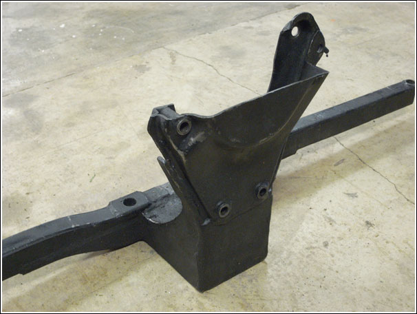

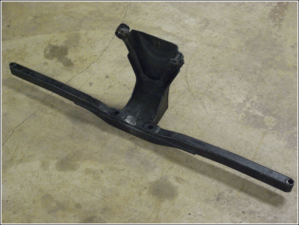

The quick six is nothing but a standard early engine mount bar with the nose piece of /6 911 mount welded to it (early = tail shift engine mount bar).
Others have been made of tube instead of the bar, but the nose piece is still welded on.
This is one on a car I had which I immediately changed to an RJ mount.
(IMG:http://www.914world.com/bbs2/uploads_offsite/i239.photobucket.com-1696-1346191348.1.jpg)
Not a true "quick six" but the same idea.

Couldn't use the side shifter setup because the torque shocks had to be at the end of the bar. If you used it in a mid '72 and up, you had to acquire the "shock" assembly of the early tailshifter engine mount bar for the ends to have any vibration isolation.

I have one of the mounts that is shown in Slits photos. I also ended up removing it when I went to a firewall mount in order to clear the heat exchangers. I cannot imagine that it could break as it is a very heavy unit. The crossbar is a solid steel bar and the mount is made of very heavy gauge steel.
If you are interested, please PM me. I don't really have a use for it and could probably let it go cheaply. Shipping would be tough, but could certainly be arraigned. I originally got it from John Williamson at Otto's in Venice, CA years ago.

I have the top bar in the photos above. It broke at a track many years ago but triangular gusset (two total) welded onto each side of the pulley enclosure fixed it. The 993 engine and many years later no problems. I wouldn't use one without those gussets. Another engine upgrade and I'll probably go to a firewall mount.

There are no motor mounts on a quick six like on a mid '72 & up. You would be bolting a solid mount setup if you used the side shifter setup (bar ends). As far as the side shifter bar, I suppose you could weld the mount to it but again you would not have a rubberized motor mount.
You can use solid mounts, but I would rather have some shock absorbing capability to avoid cracking cases.
