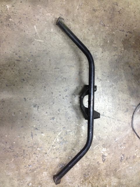

Jonathan - the original "quick six" mount was a bolt in bar that spanned from the "4" mounts and had a six connector at the front. I had one like the top picture in the post above... Broke the welds and had to re-weld it. sad.gif

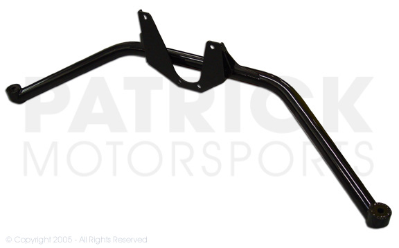

I hope that this is not what you are looking for. They had a number or issues, mainly related to weld failures. Patrick motorsports used to make them and changed to a firewall system. (See http://www.patrickmotorsports.com/part/pmp...onversion-part/ )
check that one out.

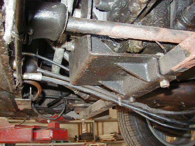

The quick six is nothing but a standard early engine mount bar with the nose piece of /6 911 mount welded to it (early = tail shift engine mount bar).
Others have been made of tube instead of the bar, but the nose piece is still welded on.
This is one on a car I had which I immediately changed to an RJ mount.
IPB Image
Not a true "quick six" but the same idea.

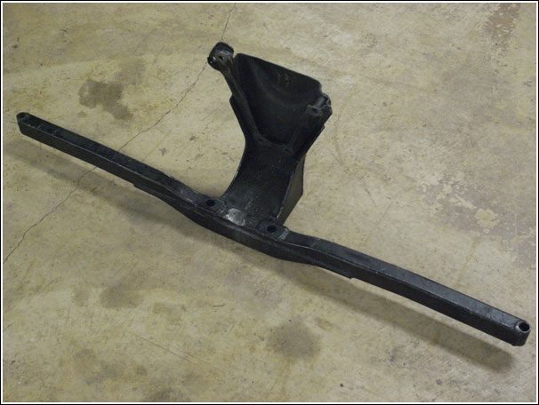

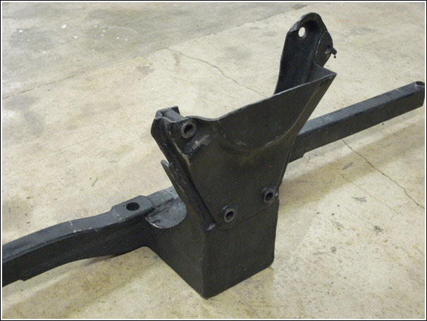

I have one of the mounts that is shown in Slits photos. I also ended up removing it when I went to a firewall mount in order to clear the heat exchangers. I cannot imagine that it could break as it is a very heavy unit. The crossbar is a solid steel bar and the mount is made of very heavy gauge steel.
If you are interested, please PM me. I don't really have a use for it and could probably let it go cheaply. Shipping would be tough, but could certainly be arraigned. I originally got it from John Williamson at Otto's in Venice, CA years ago.

I have the top bar in the photos above. It broke at a track many years ago but triangular gusset (two total) welded onto each side of the pulley enclosure fixed it. The 993 engine and many years later no problems. I wouldn't use one without those gussets. Another engine upgrade and I'll probably go to a firewall mount.
