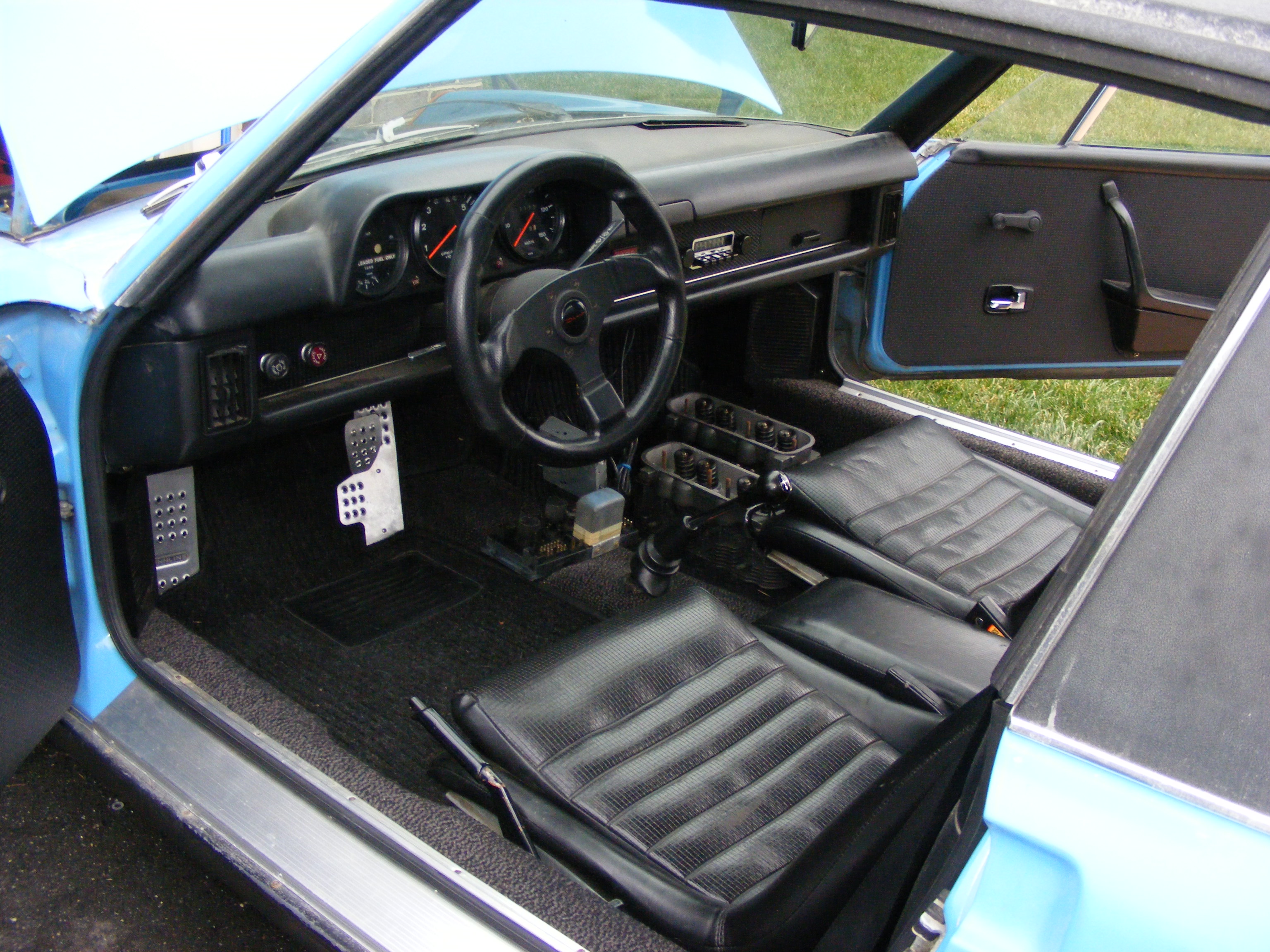

Oh I found another gem, still haven't gotten a settlement from Uncle Sam yet, but i found a fine roller that has been sitting in a garage for the last eight years. Very rust free car brought in years ago from Idaho. Interior is mint! Laguna Blue which I don't care for, so hopefully Scotty can make it Venice Mett. Blue for me , if things proceed as planned. The motor I have been asking about comes with it, my engine and trans from the car above can go right in for time being. Pics to follow soon. I found one problem on the cowling on drivers side, that I have a small concern about, but everything else checked out.

We share a sickness don't we Bill, and the wife was not happy when i told her either. Scotty, need estimate for a complete paint. Inside and out.
Do i really want to restore another one? How do i find these things?
Pulled front hood seal and the rain channels were good, slight surface rust in rear trunk in a small area. Solid everywhere else, rockers, hell holes, jack points. We will see.

interior pics of 75 2.0
