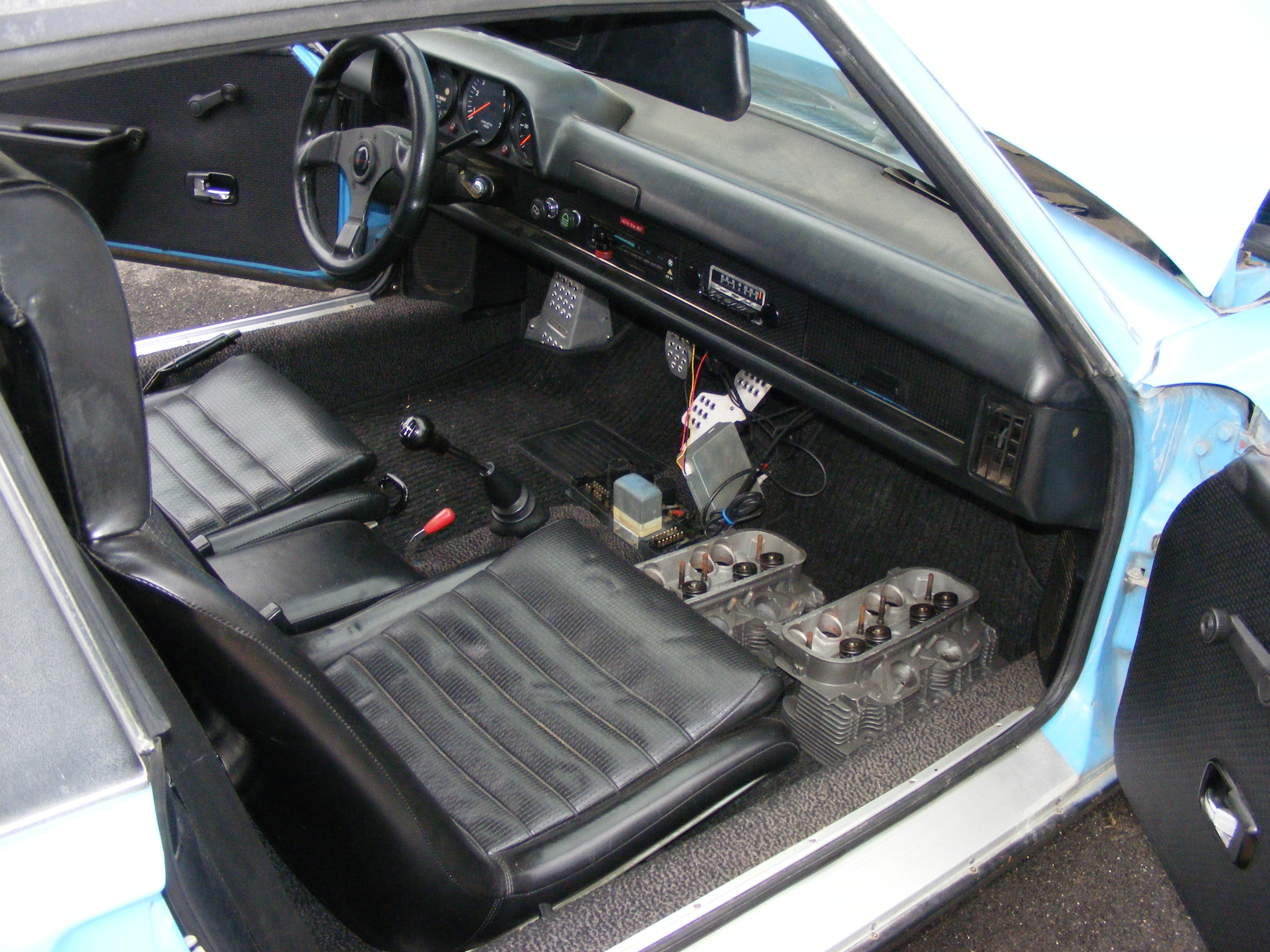

Dec 18 2012, 03:28 PM
Valy
Dec 18 2012, 05:59 PM
QUOTE(SUNAB914 @ Dec 18 2012, 01:28 PM)
Those are not 2L heads , and are not in the right position too
Nice car!
Woody
Dec 18 2012, 09:04 PM
QUOTE(Valy @ Dec 18 2012, 05:59 PM)
Nice car!
I think they go in the back somewhere.
