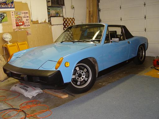

The Replacement 914.Attached Image

You sure you don't want to sell that to me and move on to one that has the color you like?

We share a sickness don't we Bill, and the wife was not happy when i told her either. Scotty, need estimate for a complete paint. Inside and out.
Do i really want to restore another one? How do i find these things?
Pulled front hood seal and the rain channels were good, slight surface rust in rear trunk in a small area. Solid everywhere else, rockers, hell holes, jack points. We will see.

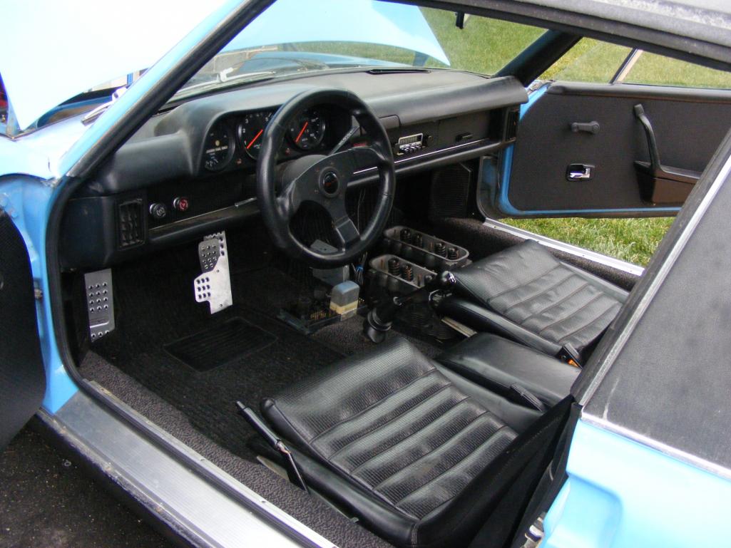

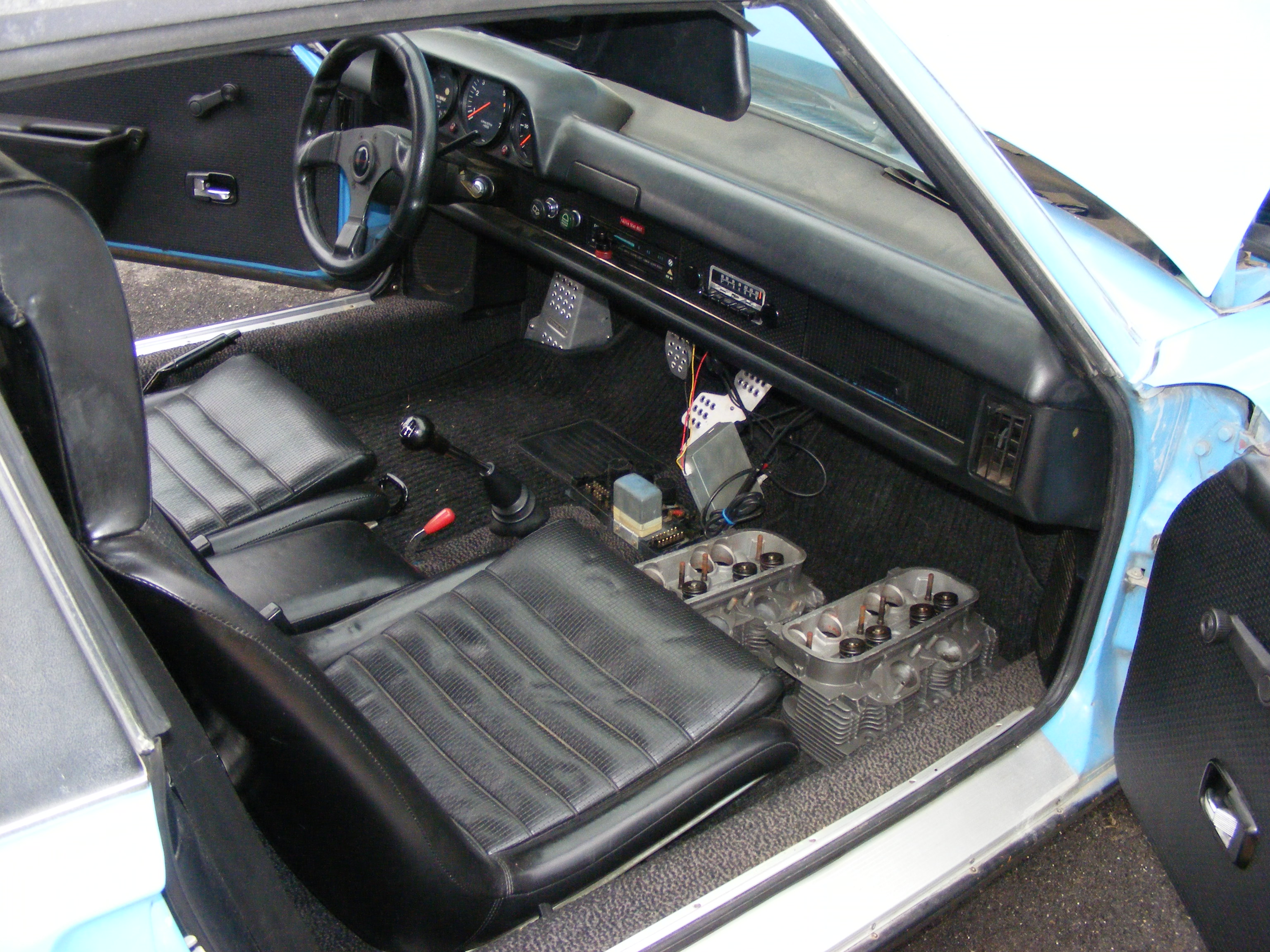

interior pics of 75 2.0
Attached ImageAttached Image
