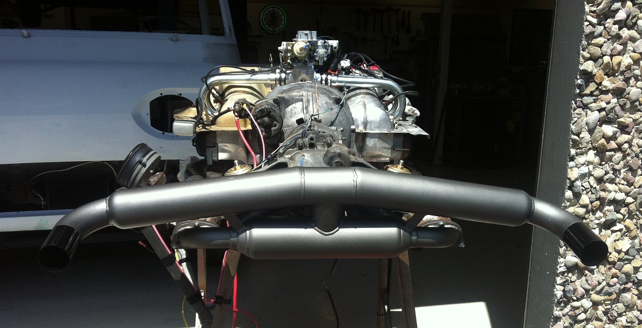

I went with the Triad and love it (IMG:style_emoticons/default/aktion035.gif)

QUOTE(johnpierre @ Feb 8 2013, 11:10 AM) *
QUOTE(LotusJoe @ Feb 8 2013, 10:42 AM) *
hey lotusJoe. i will be buying a new exhaust soon. i was gong to go with a bursh, but am open to other systems. what about this one do you like so much? cost, exhaust note, better performance, etc. jp
For me it was the sound. It eliminates that VW sound. Performance wise (IMG:style_emoticons/default/confused24.gif) hard to say. The quality of the build is really good. I think the cost was reasonable considering he makes each one to order.

I swapped out my Triad for a while with a stock muffler on my carb'd 2056 with SSIs. We were heading for Atomic Ramble and I didn't want a lot of exhaust noise. It sounded good on acceleration, very quiet on decel. I came to find out that my Triad wasn't any louder at highway speeds, so it went back on. Love the Triad. They have a very low, somewhat louder exhaust note, but there is no drone at all. Best sounding 914/4 muffler out there IMO.
