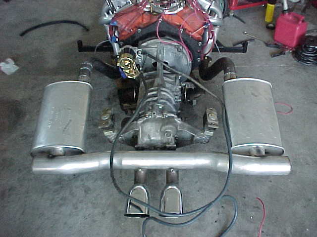

Look at the rear mounts on mine. The "brick" colored piece is a relocation bracket. It moves the tranny rearward 1.25". The factory rubber mount (that you have) gets removed and replaced with the solid bar stock of the semi solid mount. The poly block is mounted between the relocating bracket and the bar stock.
You have a piece of pipe for a lowering spacer. This should not be there...
Although not a good pic, here you can see part of the front mount. It is straight across with a round end that bolts into the stock location. Again the factory mount is removed and replaced with a solid bracket of steel.
