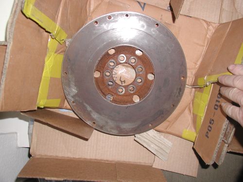

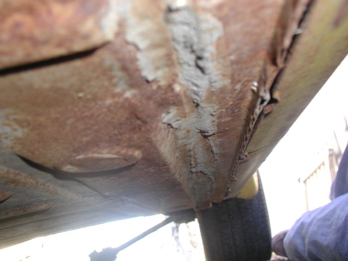

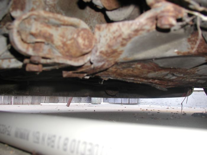

Just a quick update on this car. It may not get the 928 motor. It might go in the Nuclear Banana instead I will know after I get it up on jacks. It may have floor pan problems and if so PLAN 9 would be a go for the v8. The flywheel made it on the second try now Ill box it up with the one form the 1.7 and ship them to Rick so he can do his thing to them. I will go see him the end of Jan and take the trans to cut it dowk and do the engine mount mod. I hope I remember how to dress for northern winters its been since 1984 that I lived in centeral Wis. Note to self put block heater in the Jetta. Nay way this is the flywheel I needed and some shots of the floor of the Banana

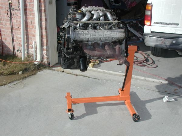

Jan 17 2005 I figure its time to bring this up to date. I have the engine out of the 928 I got from Scott out in Cal back at Thanksgiving time I am having to pull the heads off and take to a shop because some of the exhaust studs are broken off.

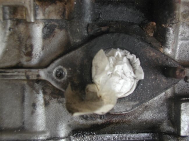

This is one of the bad studs

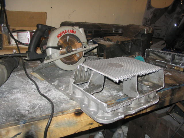

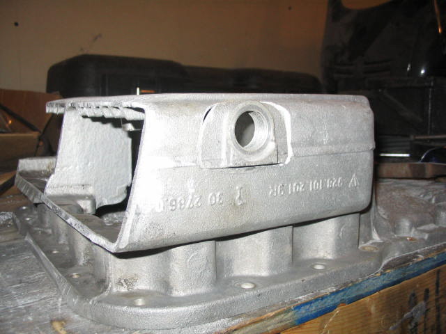

Rick is hard at work making the needed parts up on his end Here is what he is doing to the oil pan. There is NO WAY I could do this swap with out HIS help and guidance (IMG:http://www.914world.com/bbs2/html/emoticons/smilie_pokal.gif) THANKS Rick

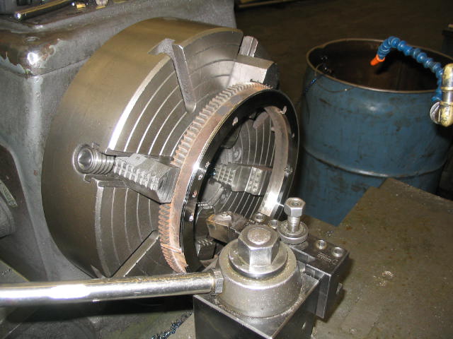

some of the work being done to the flywheel
