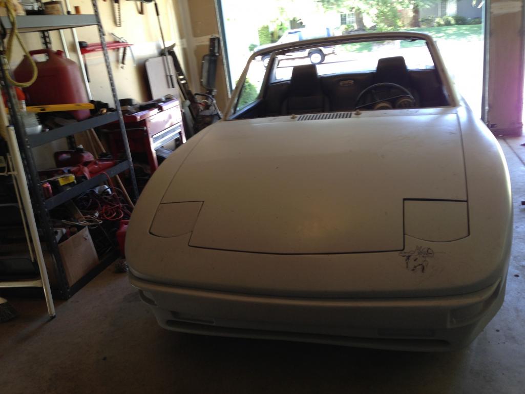

Hello 914 world and welcome to my thread ....I'm in the process of a conversion with a ez30r I have been collecting parts since december of 2012 its going to be a long road ahead but I see the promise land ahead
Here she is one long search 10 hour drive and a trade later she is mine (IMG:style_emoticons/default/biggrin.gif) bodywork was all done prior and anti rust agent was done by last owner

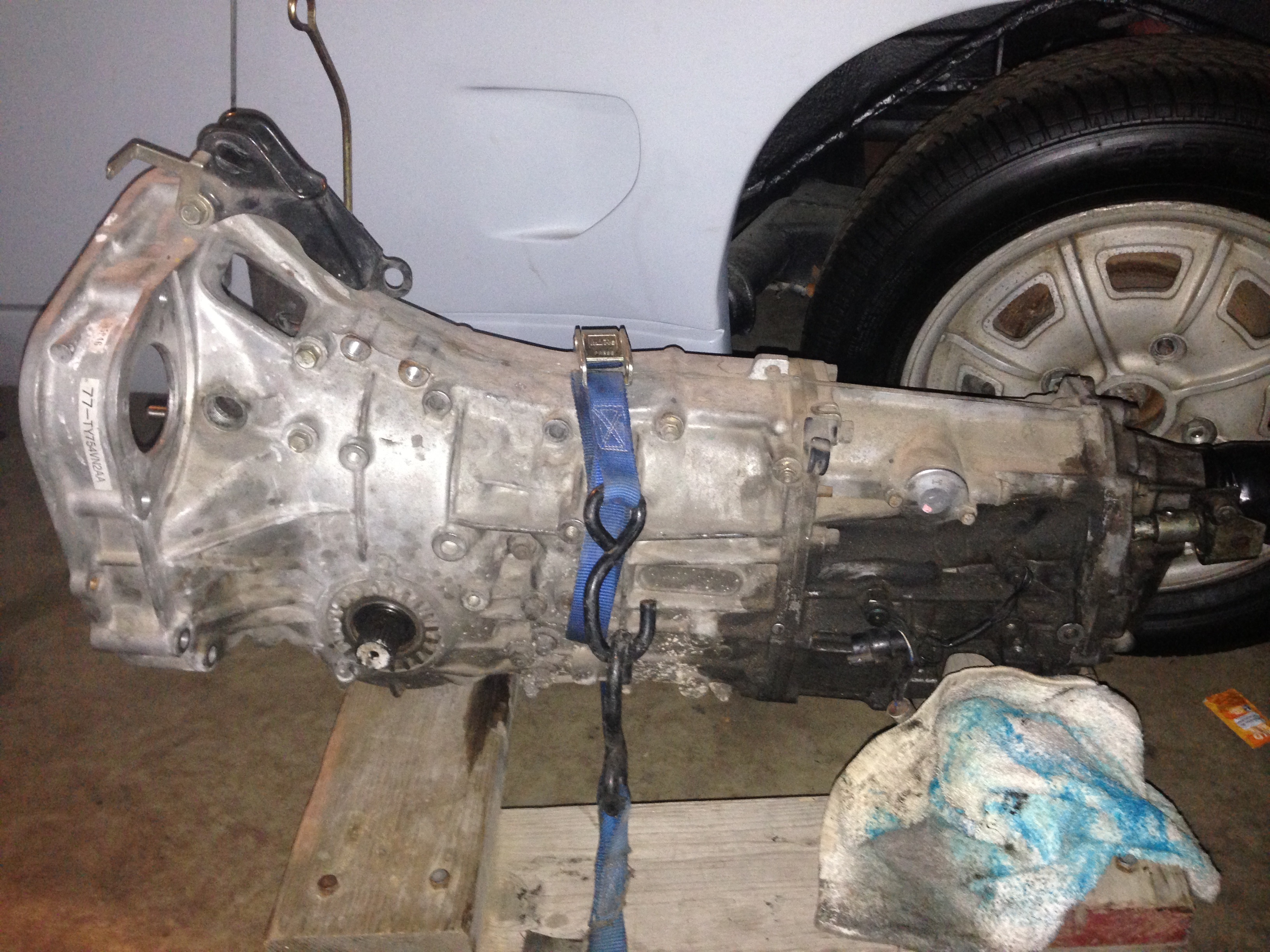

Here is the 03 Wrx 5 speed I will be using that I picked up for $50 in Lancaster CA the guy said there was no 2nd gear we will find out

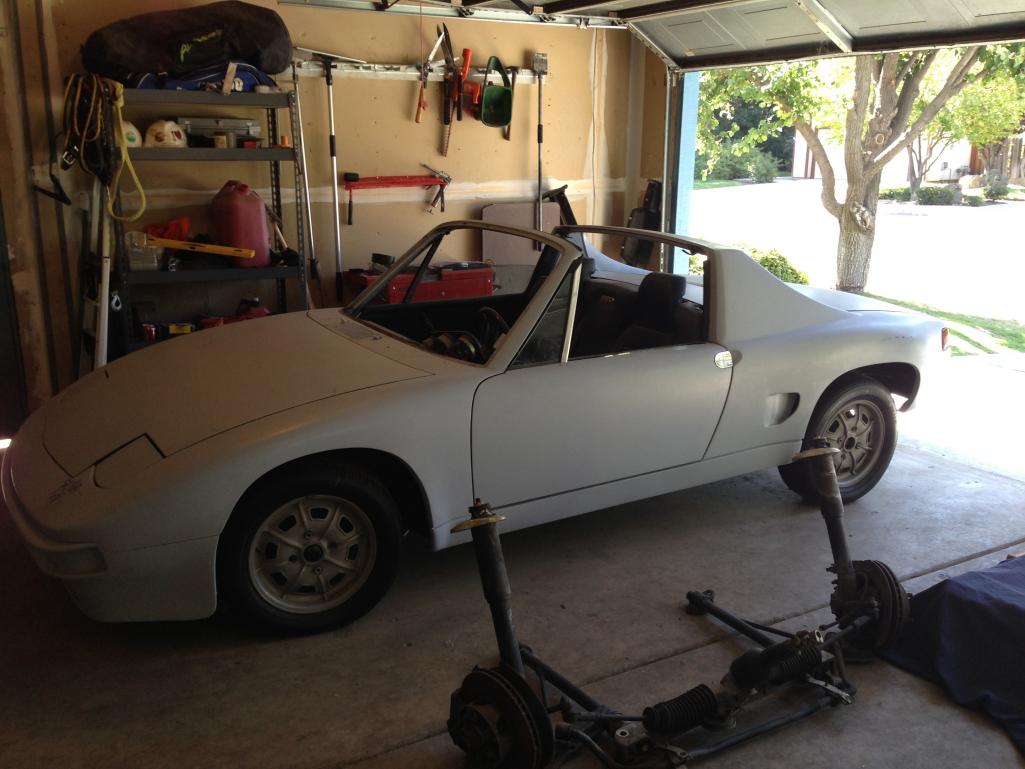

At the same time that day of picking up the trans I had a family member pickup a 1989 sc 911 complete front suspension for $500 in sac for me THANKS for good family now for some wheels soon I hope lol

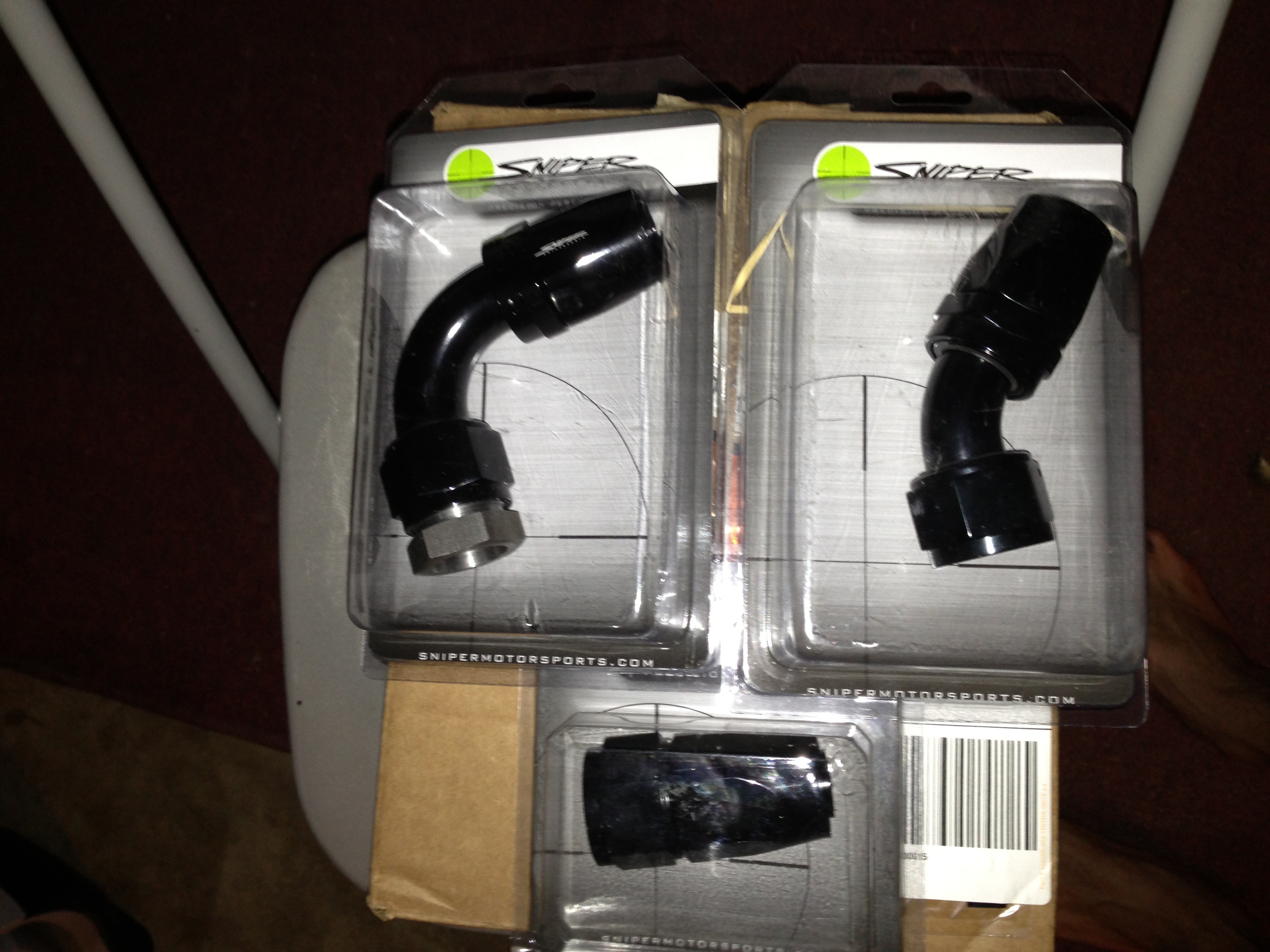

So after some long research and calling and asking questions on radiators I decided to go with one I found that's duel core duel pass 24x9 with an-16 bungs on it i will have to make my own shroud well using dual 8 inch spal fansI picked up all my fittings from jegs and sniper motorsports with high gloss finish with pro-flo 350 light weight racing hose this includes my water fuel and oil I have a lot more fitting just didn't get them in the picture

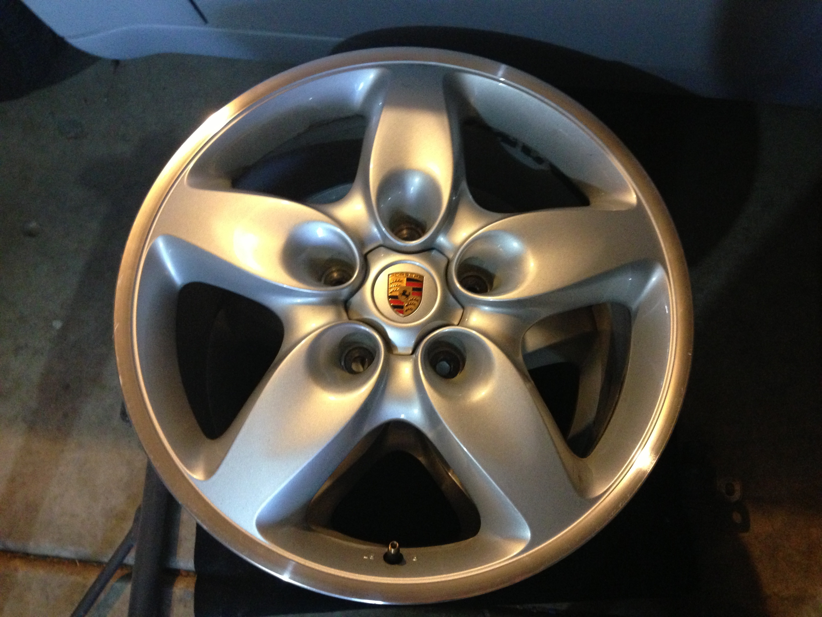

So I wake up this morning to a gift from the lovable girlfriend thanks babe... I found them on Craigslist
Not bad of a look we will see what they look like after the matte black power coat

Get some longer studs. The offset on those won't be right. I'm going to guess you'll need 1" to 1"1/2 up front. Then 1"1/2-2 1/2" in back. I'll hope I am wrong there but I looked at a set once. Much deeper offset
Andyrew
post Jul 27 2013, 11:24 PM
Spooling.... Please wait
Posts: 13,381
Joined: 20-January 03
From: Riverbank, Ca
Member No.: 172
More like 1.5 front and 2.5-3 back.

Just install the 100mm studs on the 911 hubs then you can cut off the excess down the road after everything has been fitted.

QUOTE(Porscharu73 @ Jul 16 2013, 11:25 AM) *
Just a heads up on that light weight hose. I used it up front with my oil cooler and all it needs is one little thread cut or tear (just rubbing somewhere) and it will fail shortly after. What happens is that the thread unravels a bit from where ever it is
cut or torn, then that spot isn't protected against pressure and it blows the hose. I I had mine fail at an autox and it dumped 2 quarts of oil so fast you wouldn't believe it.
So use the stainless steel wrapped stuff, or you'll be retrofitting like I had to do. (IMG:style_emoticons/default/biggrin.gif)

This is the radiator I'm using its for Hondas it's a tucked radiator for the Hondas running big turbos or in need of extra room I call them and talk to them they said it should be able to do just fine for what I'm using it for look a perrins build and many other ez30r conversions even when they turbo charge the motor they still us the stock ez30 radiator
As far as the hose im was thinking of using that hose shield don't really know what it is called ...and I'm will be metal piping with -16an bungs welded to it for under the car but completely understand where your coming from
As far as the 100mm studs thanks I will be looking into them will spacers be necessary

Yes spacers will be needed for those wheels.

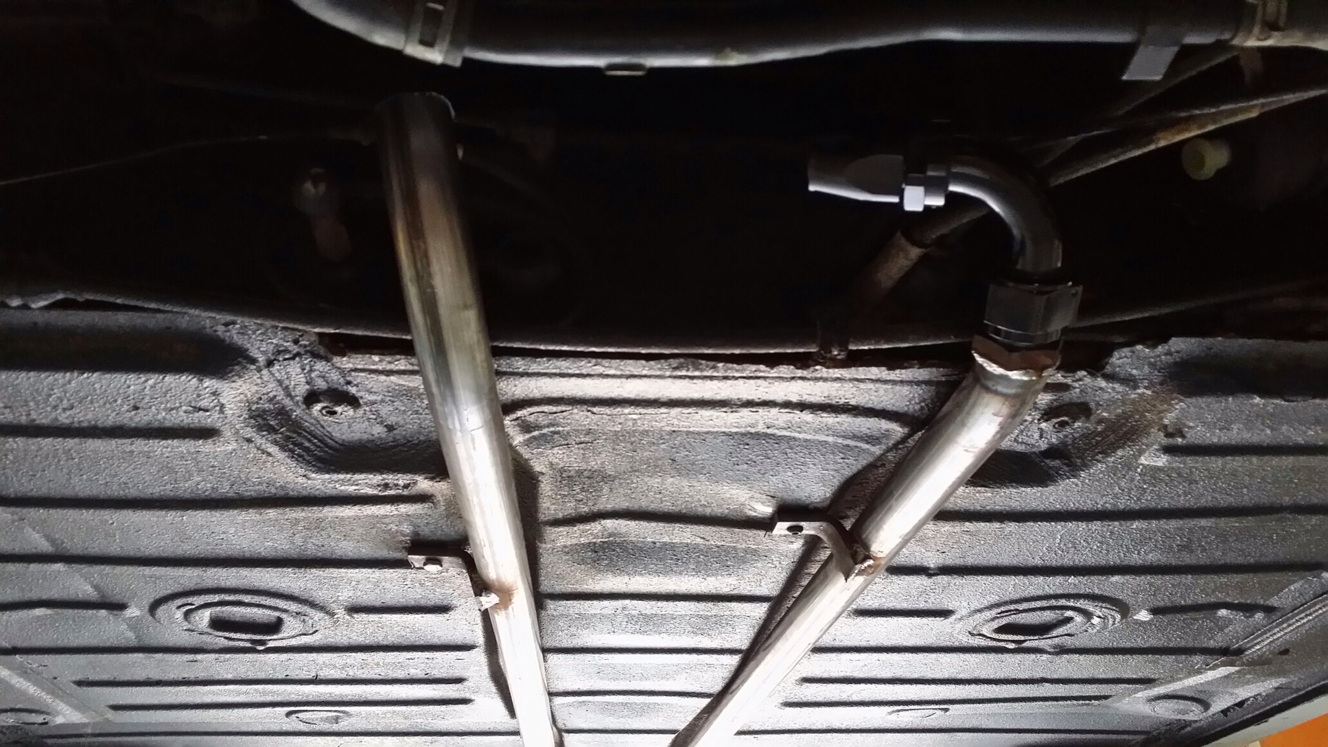

Just a few -16 fittings with one steel bung attached to it

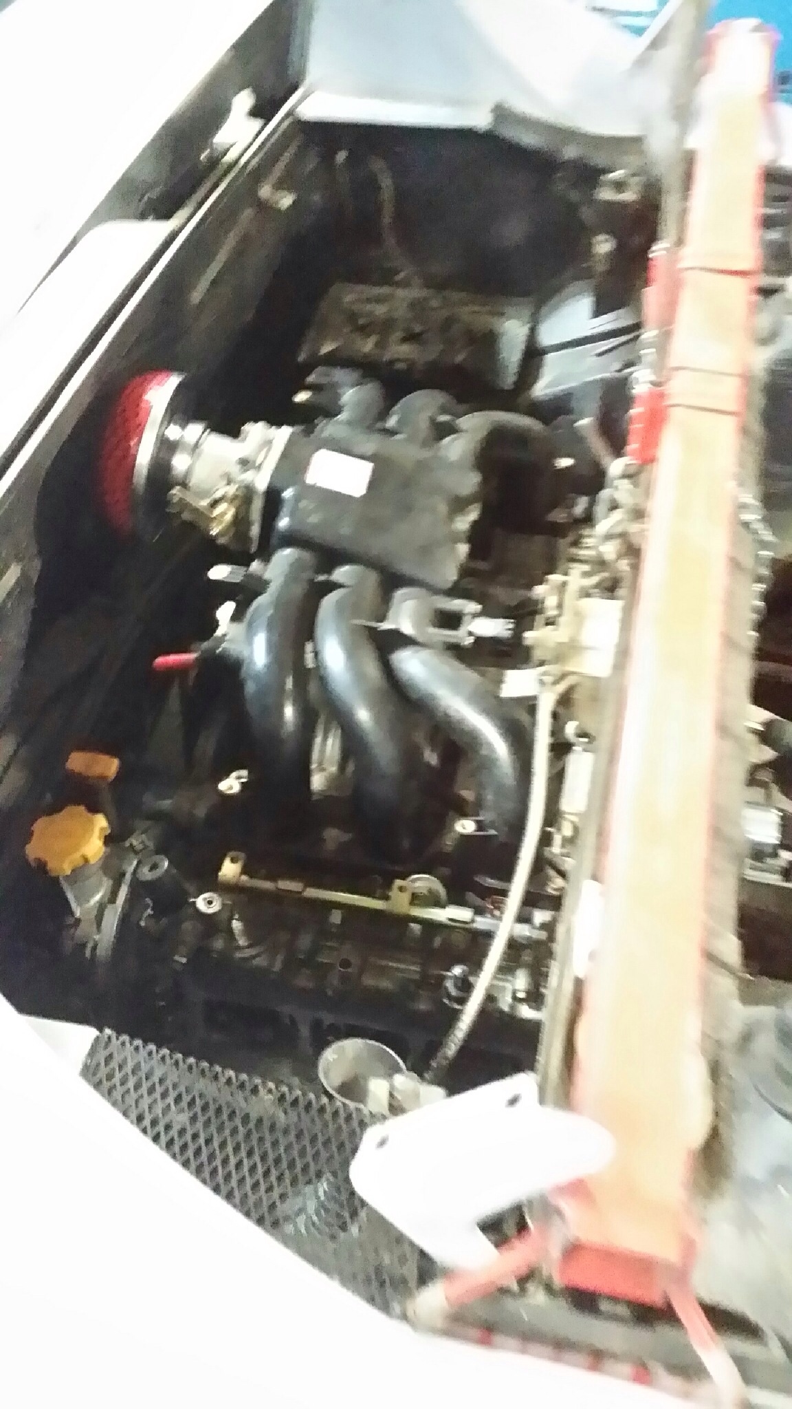

The motor nicely tucked away in it's new home fuel lines fuel pump water reservoir still have not decided. Where to put the ecu
Attached ImageAttached ImageAttached Image

Your coolant lines look nice. You better raise your car up high! You will rip the lines open after a few speed bumps. I've lost count on how many times my rubber lines have hit bumps...
You could fab skid plates to protect the lines. (IMG:style_emoticons/default/idea.gif)
Looks like a cool build... (IMG:style_emoticons/default/smile.gif)

QUOTE(Mike Bellis @ Feb 22 2014, 11:19 AM) *
That is the nice thing with the gates greens tripe hose. Tough enough can just flex with a bump. so even if it's smashed by a bump. Typically it is just temporary. That does look nice & clean. Can't wait to see you fire that up (IMG:style_emoticons/default/piratenanner.gif) . Keep up the good work

I have still been looking into axles and shifter then came across these rims when I had to pick them up just completes the look very happy how it came out
