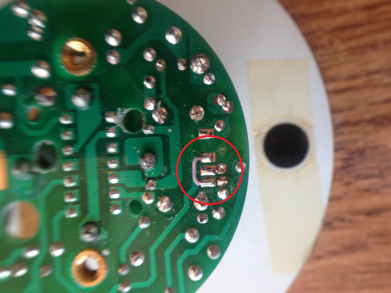

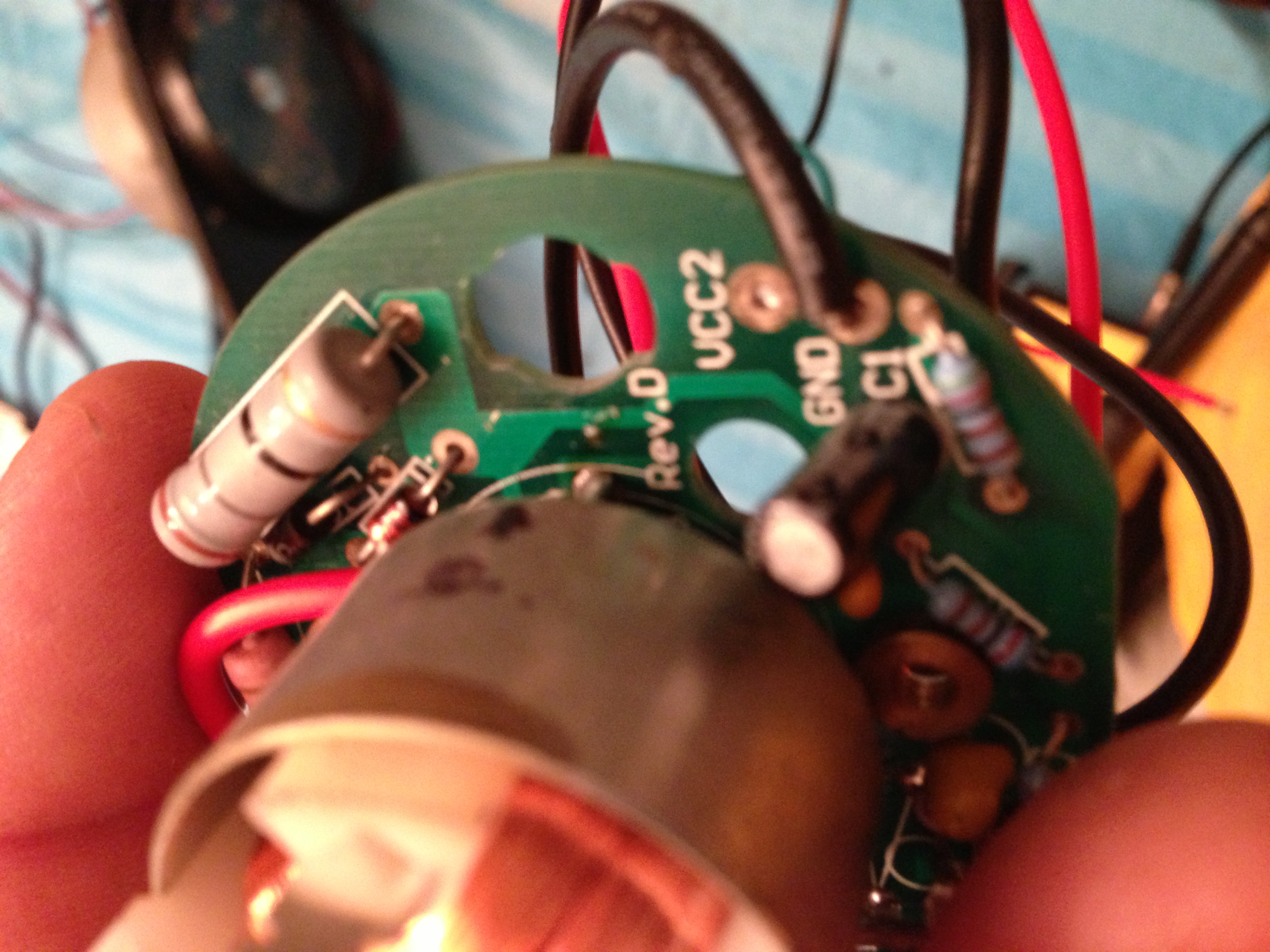

After buying this tach, go ahead and disassemble it. On the circuit board you will need to look for a revision letter. We are looking for revision letter D, if it's not a D go ahead and reassemble the tach and trade it in for another. Rev A has some problems, and is actually quite different than the D. The shaft size for the needle is smaller than rev D and the electronic layout seems to be dramatically different as well. The picture below shows the revision letter on the circuit board.
Next, we will need to remove the selector switch on the back of the circuit board. This selector switch, switches from 4 to 6 to 8 cylinders. This switch will be in the way and hits the back of the gauge can. You can either de-solder this switch, or you can use diagonal cutters to snip the leads.
After you have removed the selector switch, you will need to solder in a jumper wire as shown in the picture below.

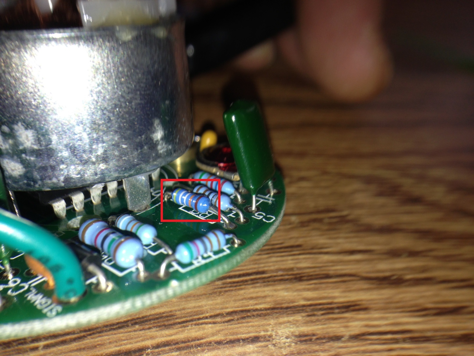

After the jumper has been soldered, we need to change out a resistor (R9). R9 is shown in the picture below.
So remove the current resistor in this location and replace it with a 499k ohm resistor. The reason why this must be done, you will notice that our VDO tach face has the tic marks at certain RPM's and different degree marks than the 30 dollar tach. The VDO face dial is 4 some inches in diameter, and the sunpro tach has a tiny 1.5 inch dial face. The numbers for each RPM simply don't line up, so changing the resistor will fix the gain on the needle sweep and correct with the corresponding angle.
This resistor has been carefully calculated for solving this problem at no extra charge to you! (IMG:style_emoticons/default/biggrin.gif) However tips are appreciated! (IMG:style_emoticons/default/slap.gif)
Edit: R9 resistor values:
499k ohm for a 4 cylinder
340k ohm for a 6 cylinder
243k ohm for a 8 cylinder

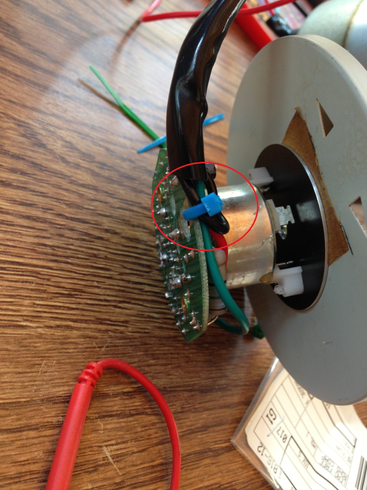

Now go ahead and cut the white wire near the circuit board. This wire is used for lighting, which you will not need for this project. You will also need to pull all the other wires so they come thru the top of the circuit board. If you leave the wires where they are at, the circuit board will stick too far out from the back of the gauge can.
It should look something like this when you are done. Go ahead and zip tie the wires to the hole in the circuit board. This will be a good strain relief for the mice that might be pulling on the wires under your dash.
The electrical portion of this build is now complete. The backside of the circuit board is very clean with no wires in the way. The circuit board should sit nicely inside the gauge can.

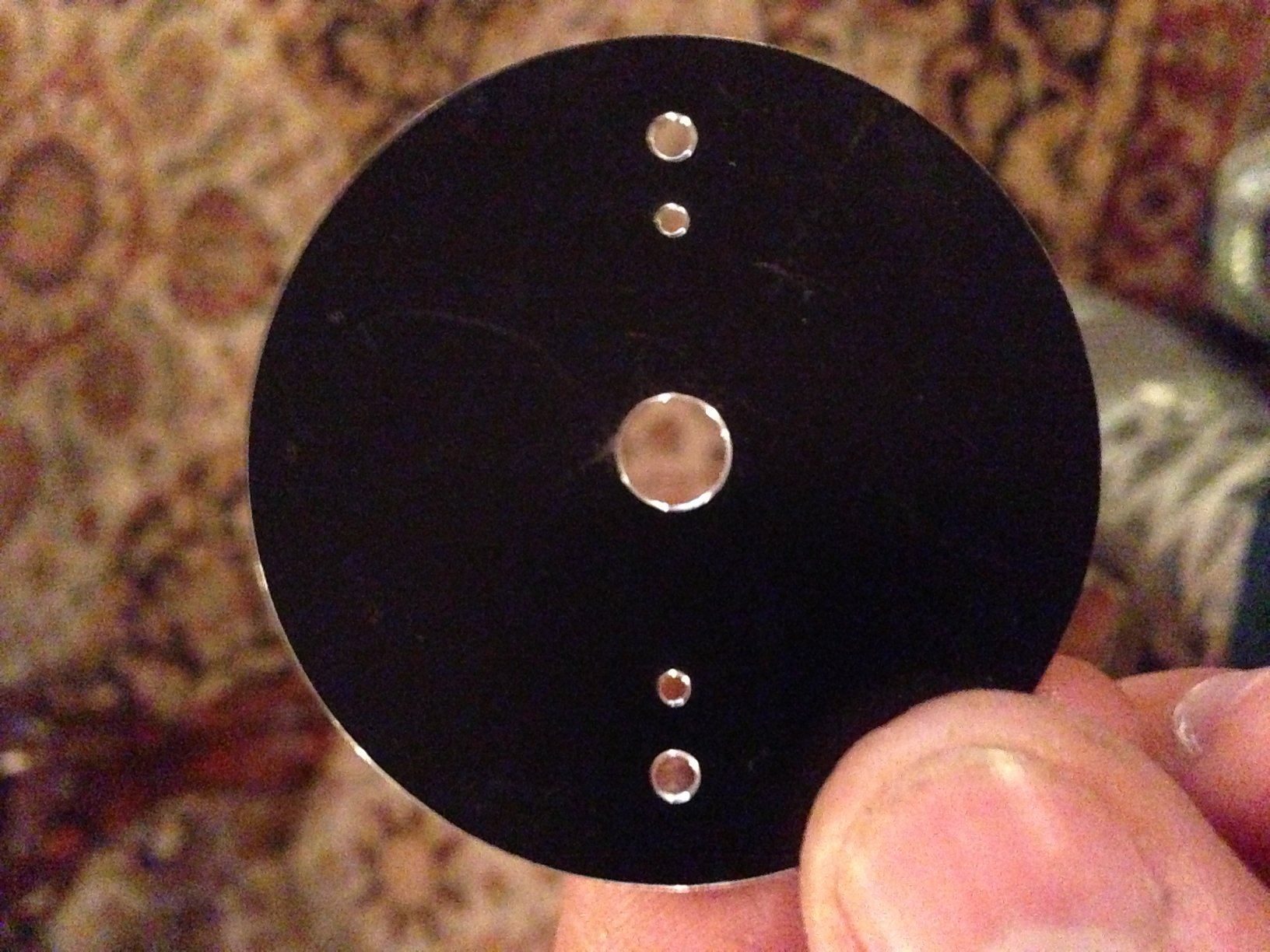

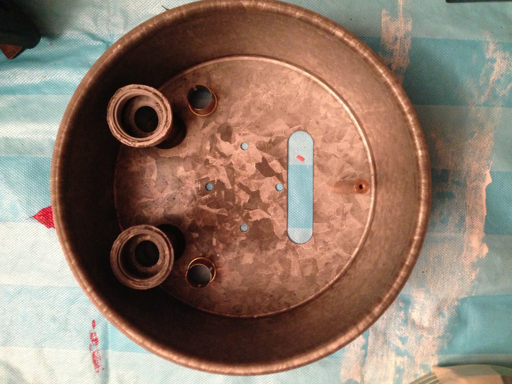

Now the machining part. Go ahead and remove the gauge bezel ring with a small screwdriver. Carefully uncrimp the lip that holds the bezel ring in place. After this ring has been removed, go ahead and remove the glass and the inner bezel ring. Next you'll need to remove the 4 small screws on the back of the can. Next, remove the tach from the can. It should look like this after you are done.
Carefully put aside the tach assembly that you just removed from the can. We will come back to this later.
Now obtain a 9/64" drill bit. You will need to enlarge these 2 holes.
With the holes slightly bigger, you can now use the same screws that came with the 30 dollar tachometer to secure the circuit board inside the VDO can.

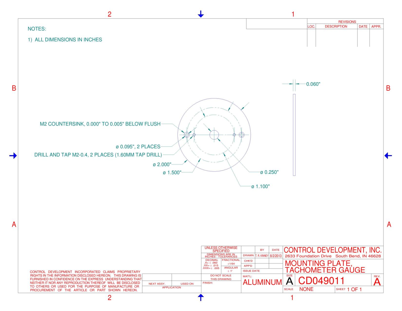

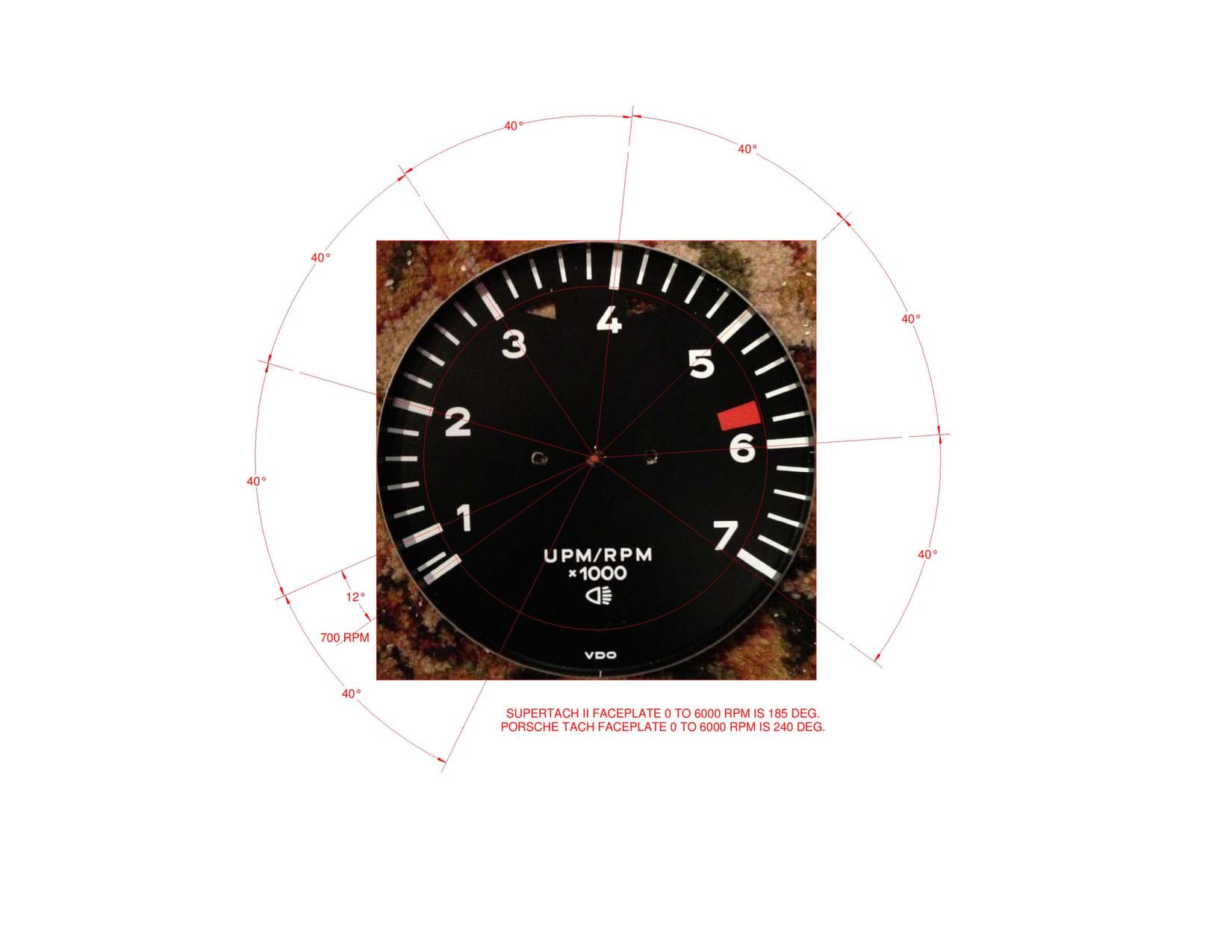

Now the fun stuff. You will need one of these.
This is a adapter bracket that will mount to the modern circuit board, but will also allow you to mount the 914 face dial to it.
Below is the specs for this bracket. Take this drawing to any machine shop, they should have no problem making you one.
I am very fortunate to have a family member that happens to own a machine shop. This particular bracket was made via a waterjet machine.

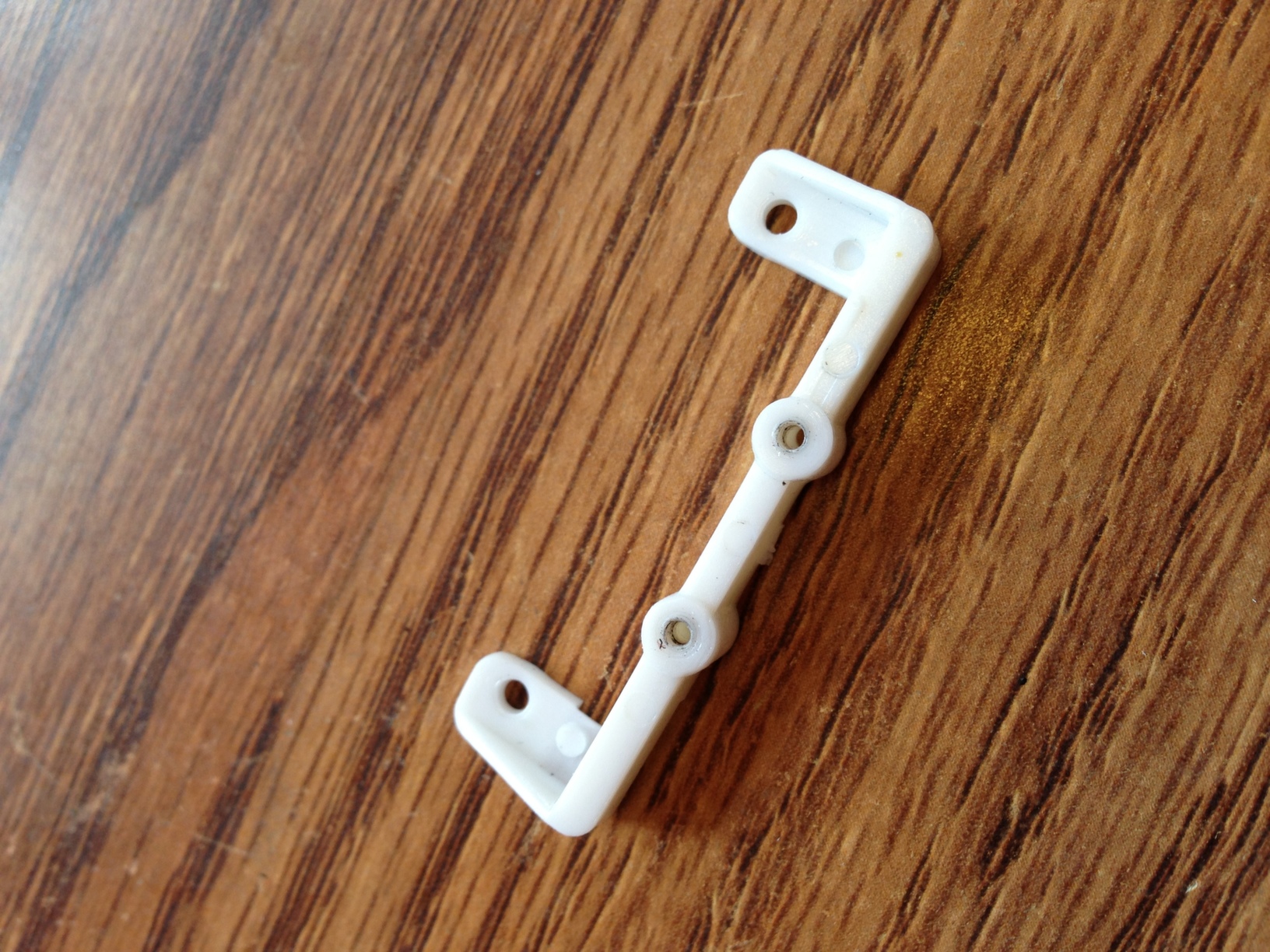

After you have obtained said bracket, you will need to remove the plastic bracket on the sunpro's motor. See picture below. Remove this bracket and discard of it.
Now grab the old tachometer that you pulled apart earlier. Carefully, (can't stress this enough) pull the needle straight up. Some force might be involved to remove this needle. Next, remove the 2 screws (some have 3) that are on the 914's face dial. With the face dial removed, go ahead and wipe it off and remove any oily finger prints. The sunpro tachometer will need to have its threads re-tapped to accommodate the new screws for the mounting bracket.
Use this tap on the sunpro's motor plastic bracket: 8305A77 Metric high speed steel hand tap 2x.4mm, D3 pitch diameter, 3 flute After these 2 holes are re-tapped go ahead and counter sink the 2 holes with this counter sinking bit: 2846A124 Single-Flute high speed steel countersink 90 degree angle, 3/8" body diameter, 1/4" shank diameter.

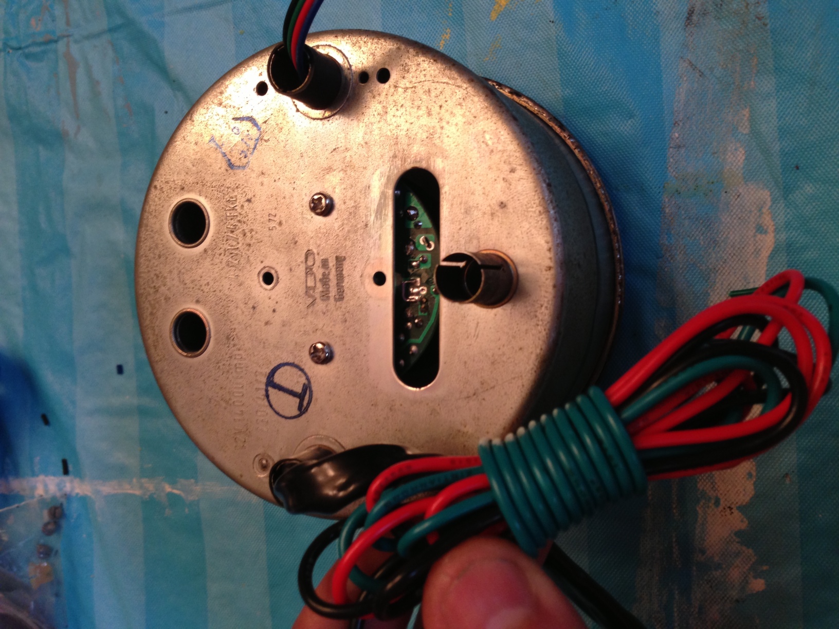

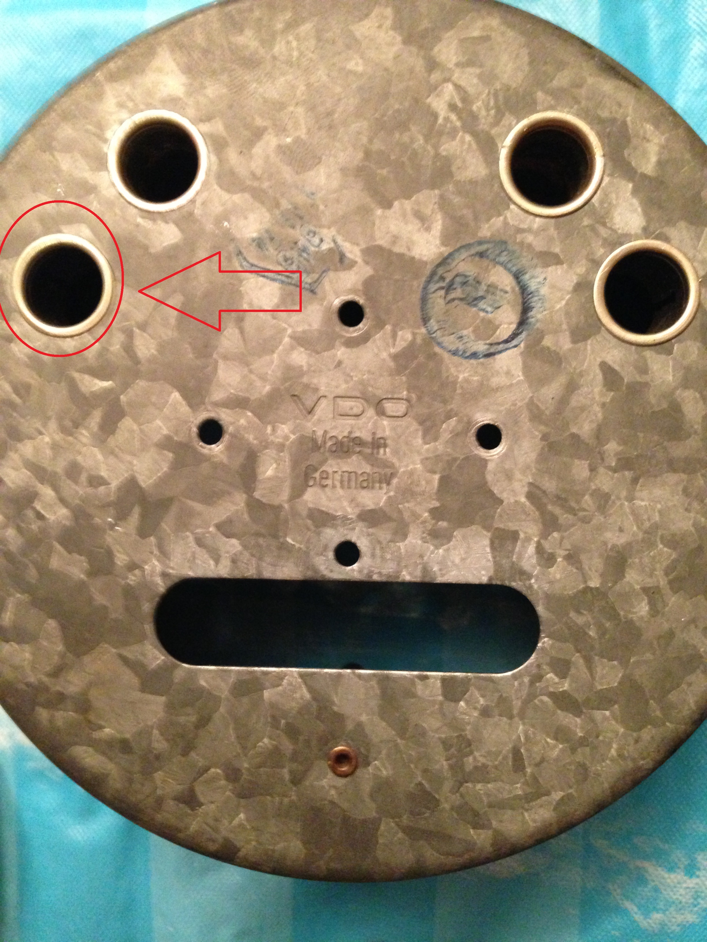

So now we need to assemble this back into the can. Use this hole to loom the wires thru the back of the can.
This mod was intended to re-use holes and doesn't require you to drill new ones which will ruin your gauge can. If you use this hole, you will lose one light port for your tach. This is a great time to upgrade to LED lighting. See my topic "custom gauge backlighting" for further explanation.
This is a picture with the wires running thru the back of the gauge can

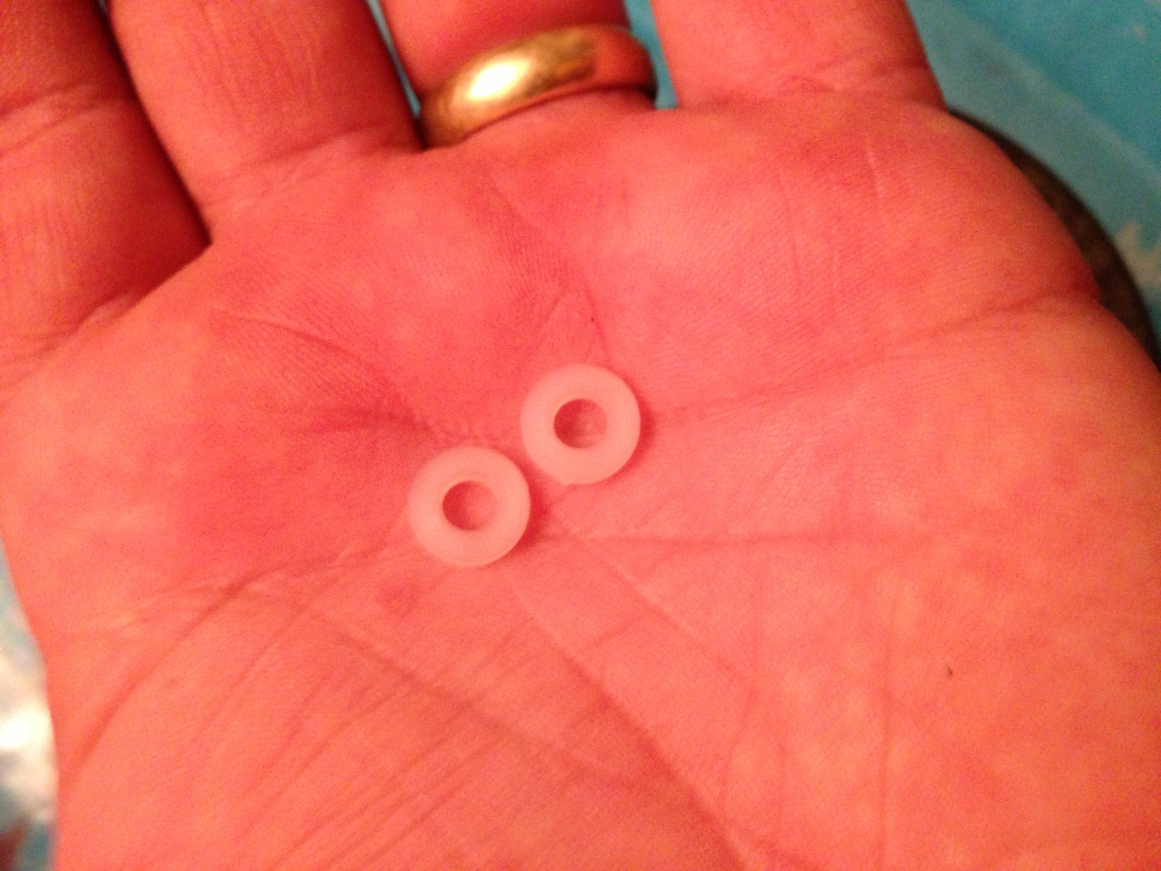

Put a couple nylon washers between the back of the gauge can and the circuit board. This spaces the circuit board, so nothing shorts out. I ended up using 2 nylon washers per screw.

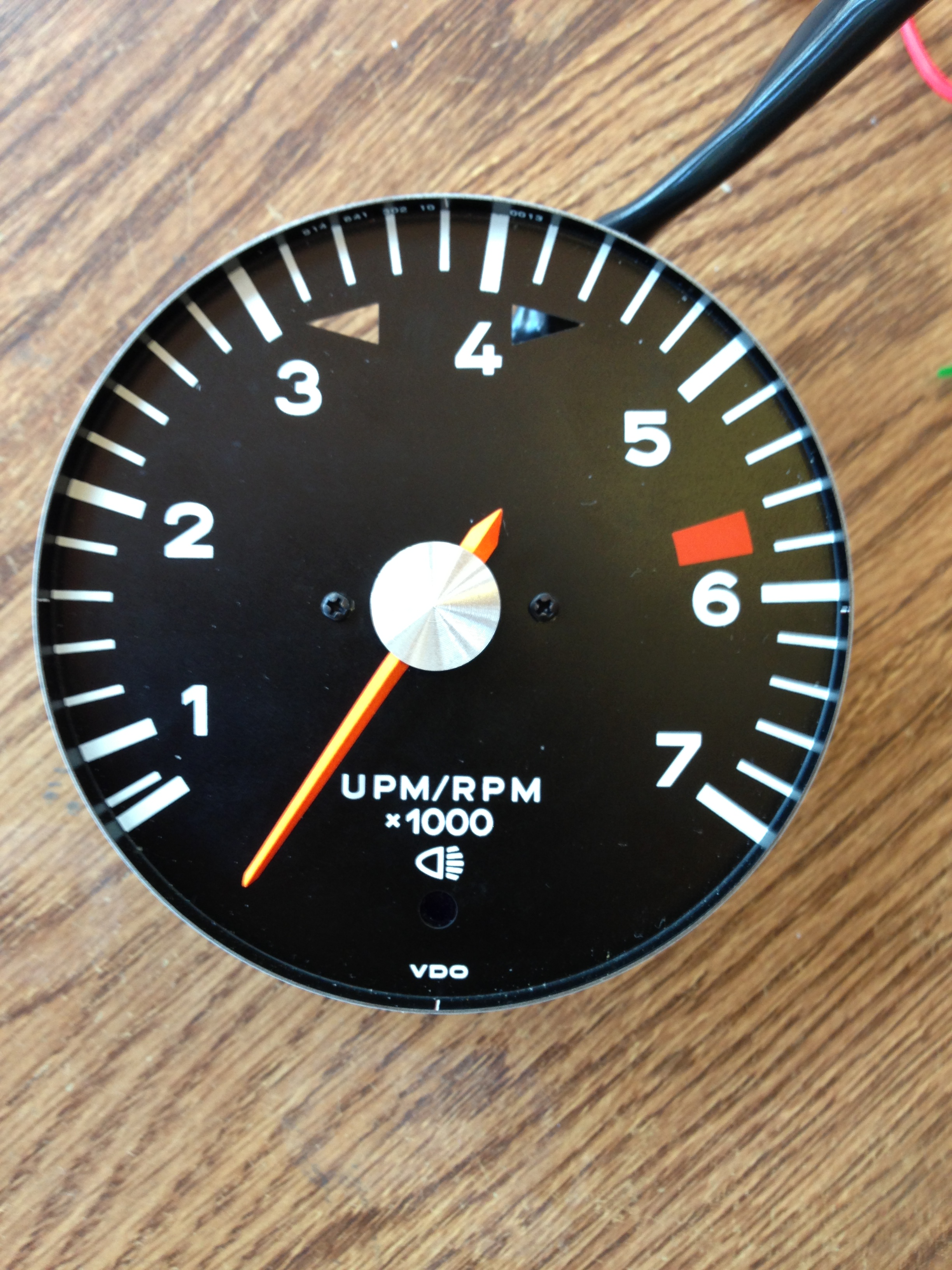

Now we need to apply power to this. The red and black wire goes to the battery. The green wire goes to the black/purple striped wire. This will be a very crude calibration technique, but if you don't have access to a function generator this will do.
Applying power will zero the shaft, this is why powering up is so essential. Now pay close attention to the picture below.
Put the needle back onto the shaft at this same spot. This should get you very close to correct.
Reinstall the glass and bezel ring and enjoy! (IMG:style_emoticons/default/beerchug.gif)
