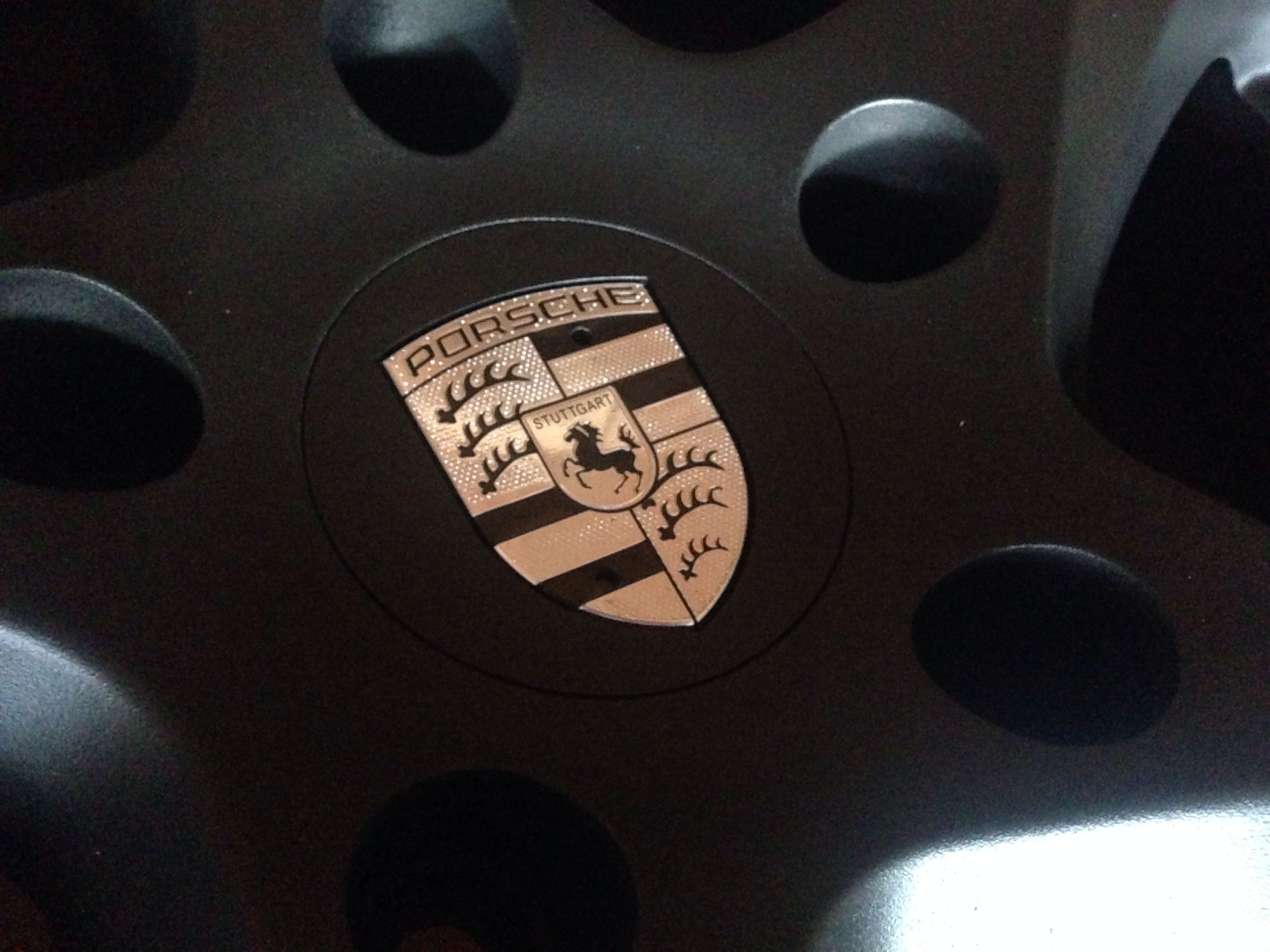

Just the regular PlastiDip Spray you buy from Home Depoti have the Glossifier spray too, and I'll put a coat of that on tomorrow.
My caps came in today...so I sprayed one to see what it looks like.
