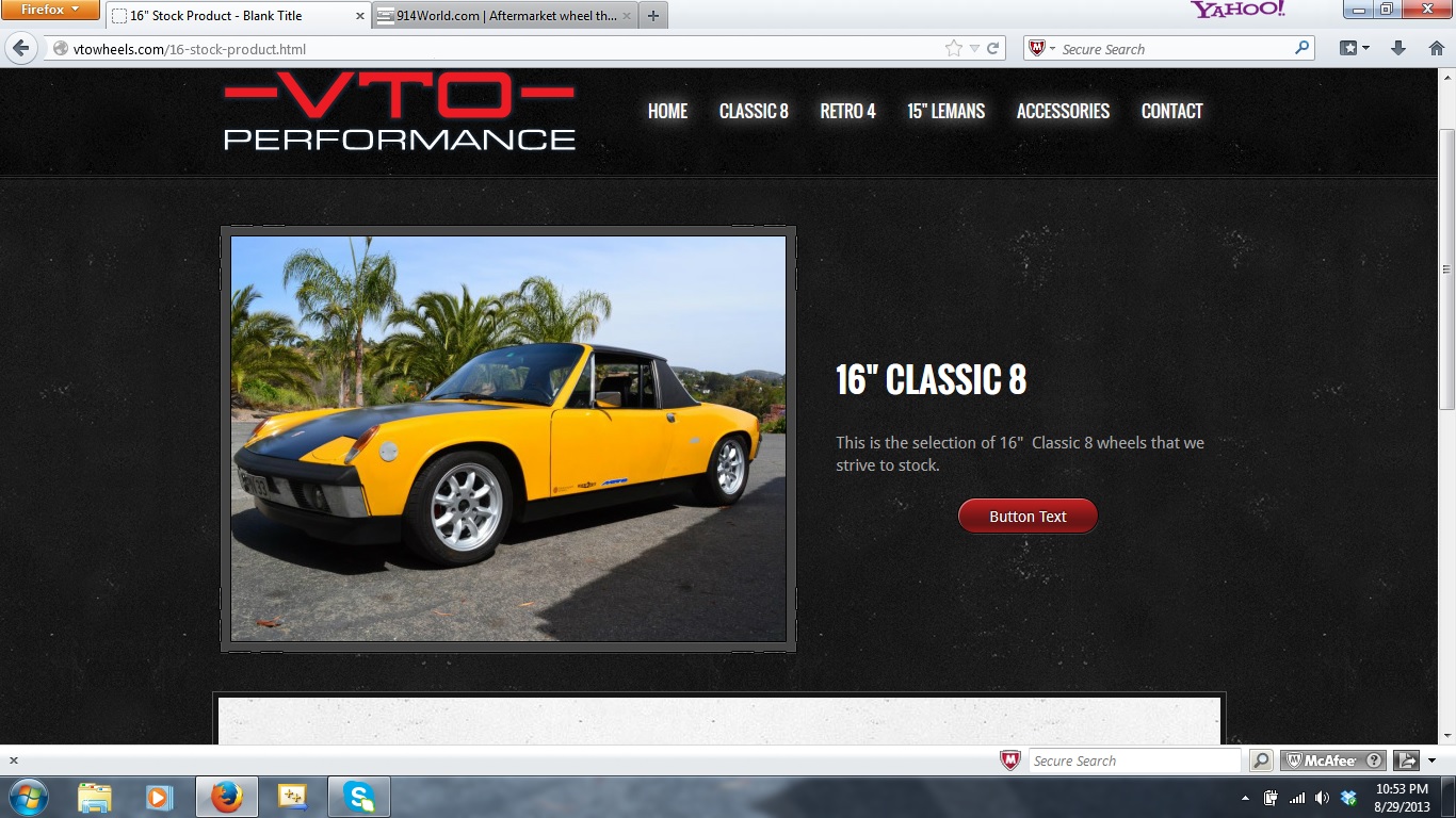

While they're not as light as some other wheels on the market, or fuchs, I really am in love with them on my car.. Even made it on to the VTO website (IMG:style_emoticons/default/biggrin.gif)
(IMG:http://www.914world.com/bbs2/uploads_offsite/i260.photobucket.com-9714-1379434950.1.jpg)

Not bad looking. I sold some 4-bolt Panasports to a member here. Love that look and it always hurts to see how good they look on his car. Key word being "his" car.
These look so much like the Panasports, or that Superlight copy, do you know if there's any common pedigree?
There aren't any weights on the website, do you remember them offhand, or do I have to call? And those are 7x16's, right? It looks like they go under narrow bodied rear fenders pretty well, better than 7x16 Fuchs. Any drama getting them to fit? And what tire is that, size and model?
Well done making their website, your car looks good, and looks like it belongs there.

I can't say much about the weights of the wheels, but here's the scoop on the wheels/tires combo.
They're actually 15x7 on all 4 corners, they just used my car on their 16" page. The tires are 205-50-15 on the front and 225-50-15 on the rear, with a 1/4 inch spacer on the rear. My rear fenders are pulled, so I can't directly speak for the fitment on a narrow rear fender.
The only nuance I found was the issue of the wheels not being hubcentric to a 5 bolt hub.. It's VERY close, but not quite perfect. I ended up having to buy hubcentric adapter rings that were probably $20 for a set of 4. The measurements are 73.1-71.6mm adapters. Most custom wheel and tire shops will sell them.
I think they are low pressure cast wheels, like both SuperLite and Minilite brand wheels, and the backside of the wheels look identical to that of a true vintage minilite
