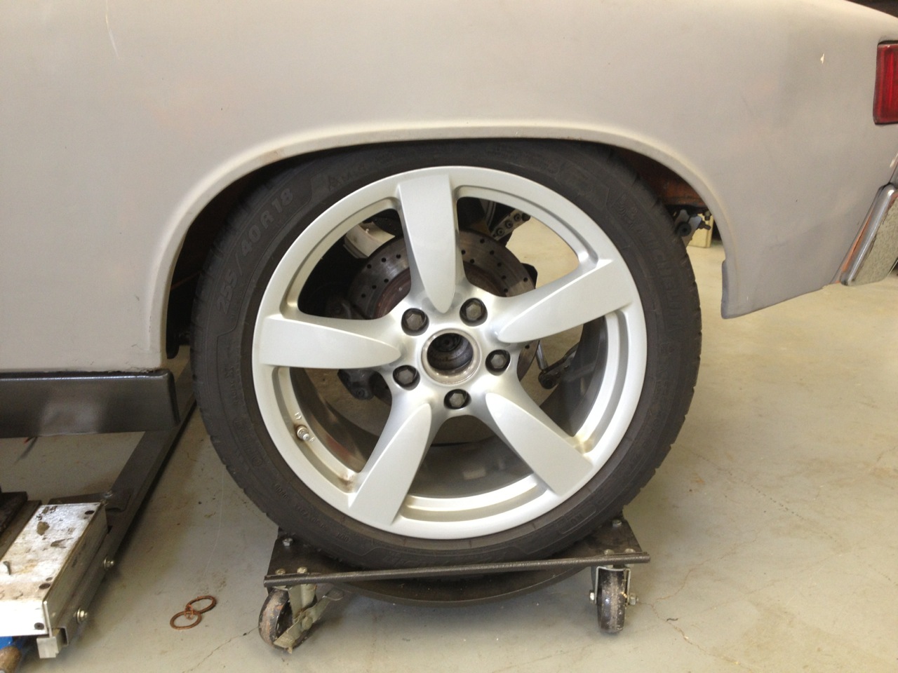

This weekend I pulled the torsion bar adjuster off the drivers side front. Added my hub centric spacer, and longer wheels studs.
I had to make this tool, I could not get the dust caps off. So a piece of DOM drilled and taped to accept these three bolts. Tighten them down, to get some grip on the indent of the dust cap. Tap and rotate the hub, and finally got the caps off with out damaging them.
Here is the final result.
Full droop off the lift.
And Full Compression
And yes I have issues.
Tires rub at full lock at the rears. It hits the LE spoiler on its way by, and at full compression I can only go in a straight line. I have ordered John Kelly's DVD on how to do flares. (IMG:style_emoticons/default/smash.gif) (IMG:style_emoticons/default/sawzall-smiley.gif) (IMG:style_emoticons/default/welder.gif) This should be a good learning experience.

The rears fair much better. As I already did flares back there, you just don't think they should support this big of tire. 255/40R18
And heres the car on the ground.
Much taller than it was, its still 2 inches short than my -6. But I can now get the lift under the car with out having to jack it up first or put it in the dollies.
