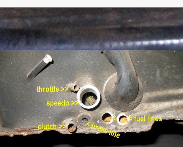

From all the pictures I could find it looks like it enters under the battery tray. Does is come through the engine sheet metal or the shelf surrounds.
Anyone have a picture you can post ideally feeding dual webbers?
Thanks
John

pic

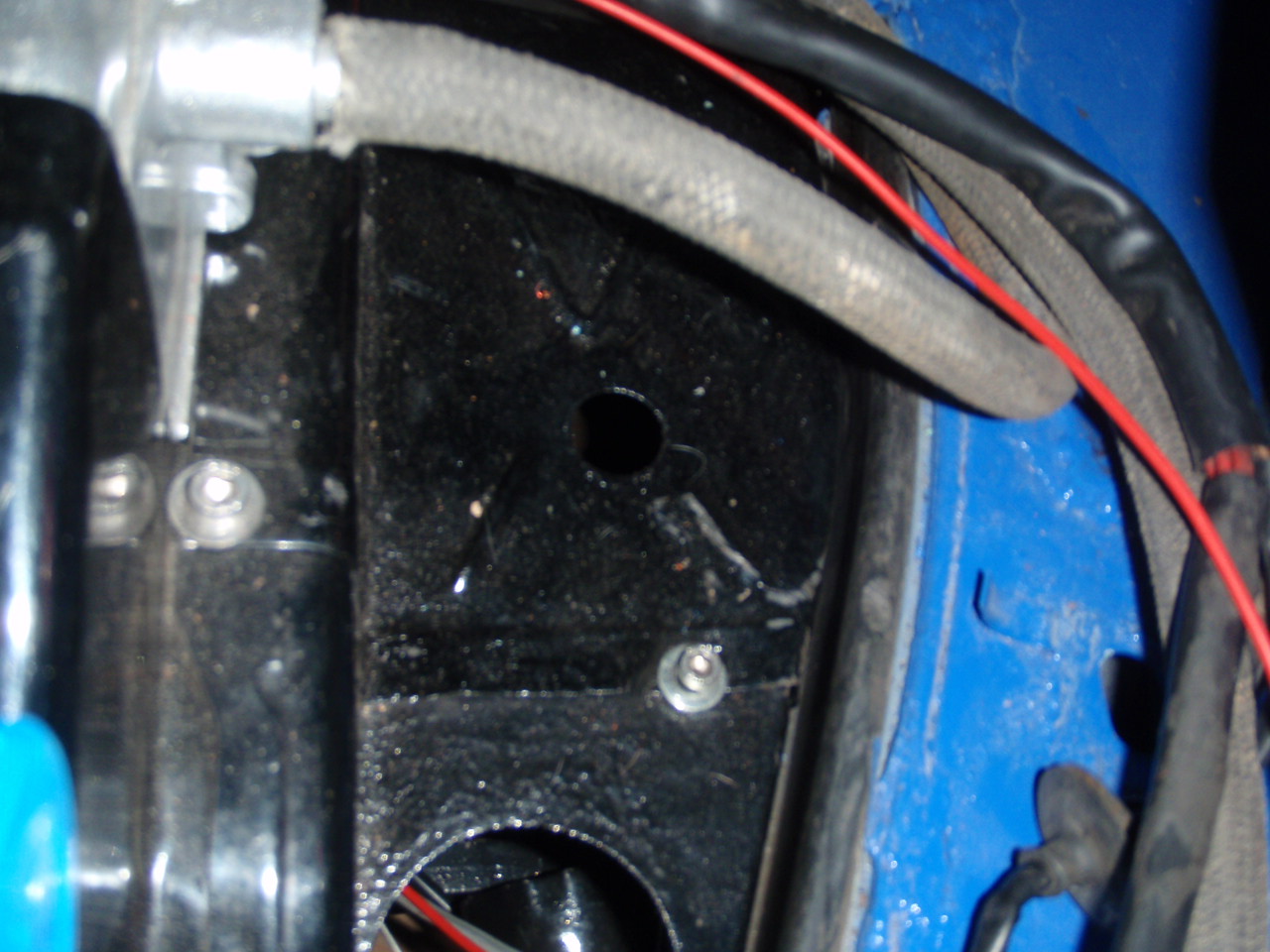

Must be here?
Thanks Rich
r_towle
post Oct 14 2013, 01:44 PM
Custom Member
Posts: 24,705
Joined: 9-January 03
From: Taxachusetts
Member No.: 124
X marks the spot....
