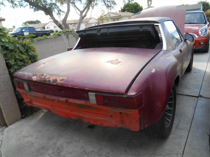

Some of you may have seen the few threads Ive been posting about picking up the 74 roller from Noel (ndfrigi). We've come to an agreement and tomorrow I will be making it official!
Here are some pics I took when I went and saw the car a few weeks ago. He purchased it and removed the interior and some other parts. I will be getting it as a rolling chassis, which is exactly what I was looking for.
This is where it currently sits. The other 914 in the background is his.
(IMG:http://www.914world.com/bbs2/uploads_offsite/img.photobucket.com-16644-1387400844.1.jpeg)

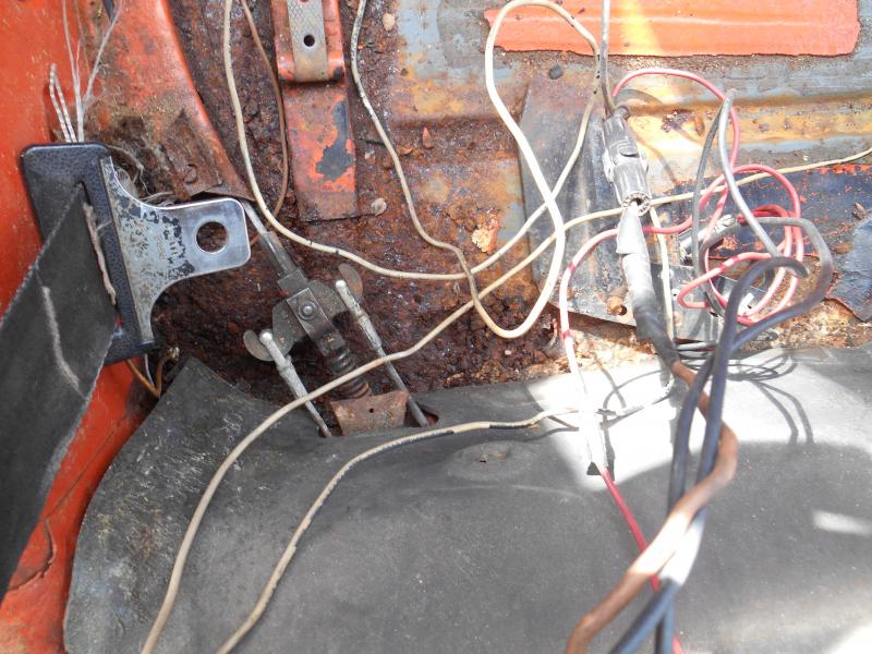

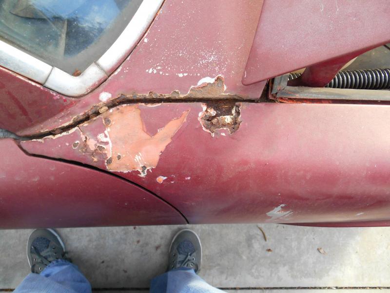

These pics show all the bad stuff. I believe the car sat for a while outside, but since this is SoCal, it shouldnt be too much work to fix the rust.
(IMG:http://www.914world.com/bbs2/uploads_offsite/img.photobucket.com-16644-1387400844.2.jpg)
(IMG:http://www.914world.com/bbs2/uploads_offsite/img.photobucket.com-16644-1387400845.3.jpg)
I plan on adding some GT style front fenders to match the rears, not sure about metal or fiberglass yet. We'll see...

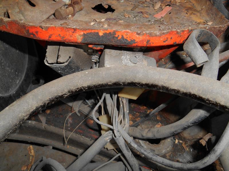

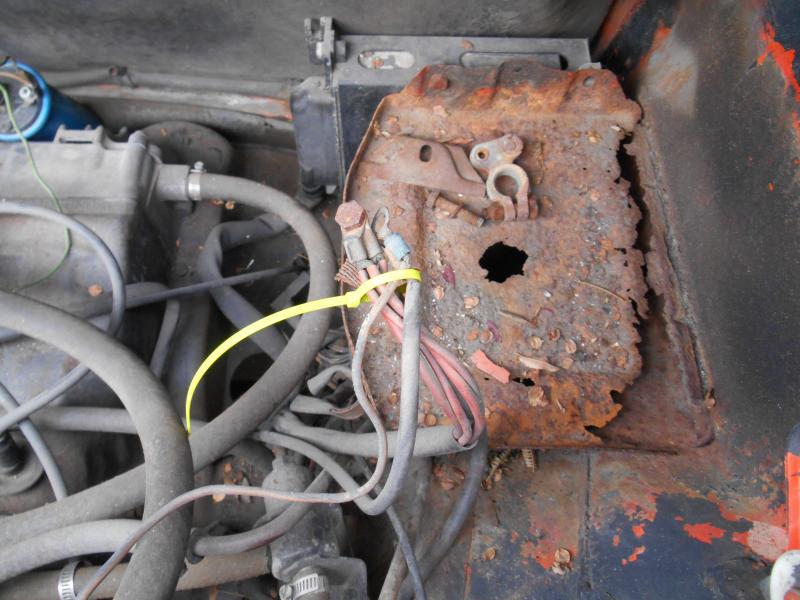

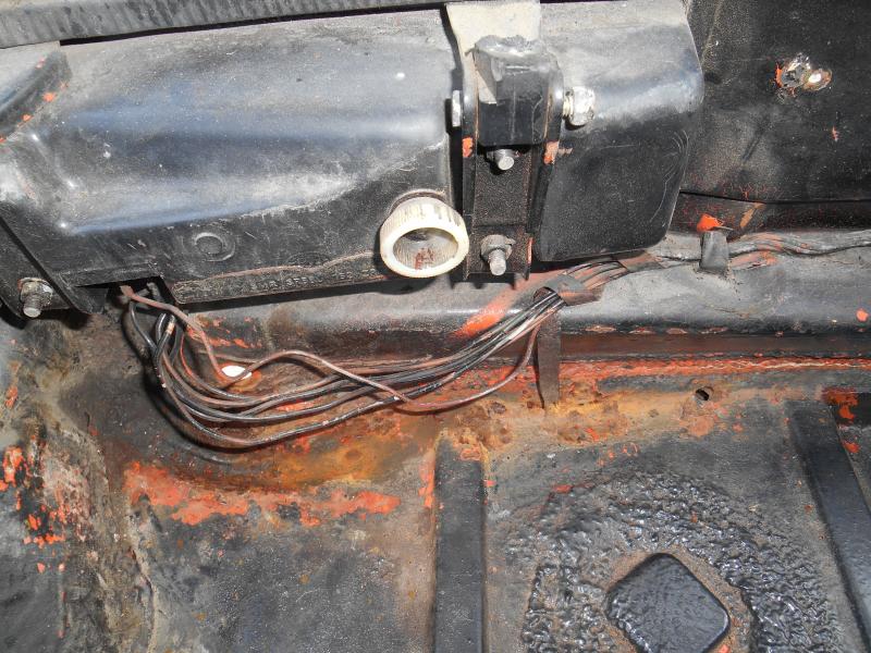

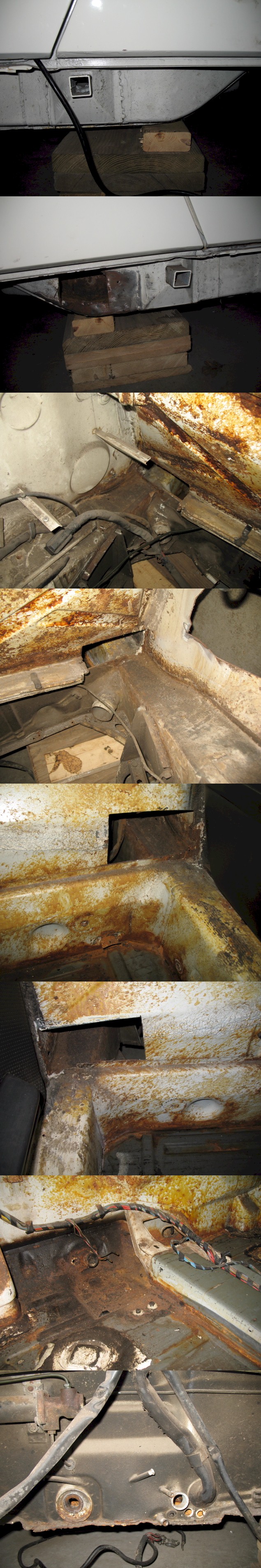

These are the best pics I could get of the battery tray and hell hole, overall it doesnt look too intimidating, but we'll see how bad it is once the engine is out of the way
(IMG:http://www.914world.com/bbs2/uploads_offsite/img.photobucket.com-16644-1387400845.4.jpg)
(IMG:http://www.914world.com/bbs2/uploads_offsite/img.photobucket.com-16644-1387400845.5.jpg)

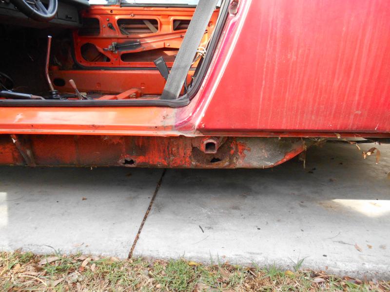

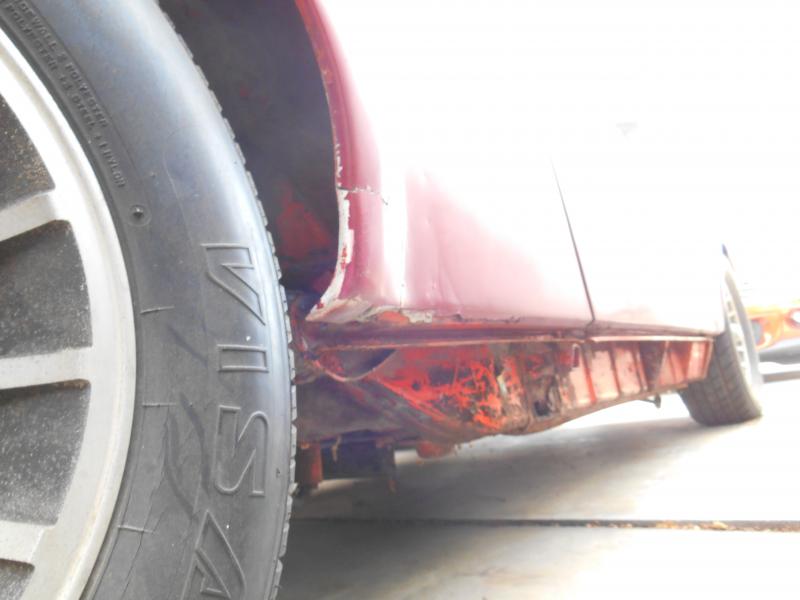

Heres the pics of the longs, couldnt get a better pic of the pass side since there was another car right next to it
(IMG:http://www.914world.com/bbs2/uploads_offsite/img.photobucket.com-16644-1387400845.6.jpg)
(IMG:http://www.914world.com/bbs2/uploads_offsite/img.photobucket.com-16644-1387400846.7.jpg)

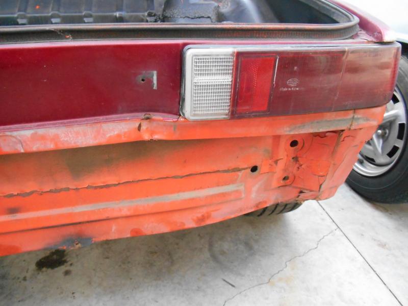

and this is the rest of the bad stuff...
(IMG:http://www.914world.com/bbs2/uploads_offsite/img.photobucket.com-16644-1387400846.8.jpg)
(IMG:http://www.914world.com/bbs2/uploads_offsite/img.photobucket.com-16644-1387400846.9.jpg)
(IMG:http://www.914world.com/bbs2/uploads_offsite/img.photobucket.com-16644-1387400846.10.jpg)
(IMG:http://www.914world.com/bbs2/uploads_offsite/img.photobucket.com-16644-1387400846.11.jpg)

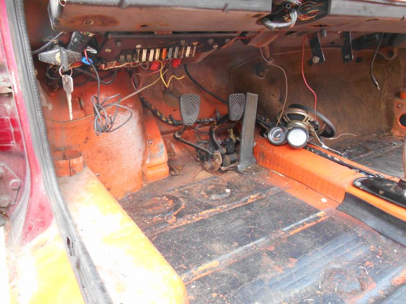

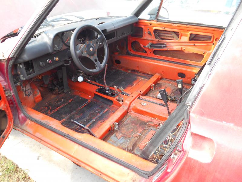

and heres the pic of the "interior"
(IMG:http://www.914world.com/bbs2/uploads_offsite/img.photobucket.com-16644-1387400846.12.jpg)
(IMG:http://www.914world.com/bbs2/uploads_offsite/img.photobucket.com-16644-1387400846.13.jpg)

So the current plan is as follows:
-fix the rust on the longs
-see what the hell hole looks like
-strip away tar on the interior floor and POR15 the rust
-knock out the rear dent and fix trunk rust
-convert to 5x130
-GT flares up front to match the rear flares
-all new rubber seals
Body will probably be primer white, engine will be a carb'd 1625cc watercooled VW engine that I've always wanted to build. Eventually it will get more, but thats the initial plan. Once you guys get to know me, you will see that my plan will change A LOT! haha

QUOTE(2mAn @ Dec 18 2013, 04:07 PM) *
......, but since this is SoCal, it shouldnt be too much work to fix the rust.
Good luck with that.... (IMG:style_emoticons/default/dry.gif)
Congratulations on the car. I hope you like to weld! (IMG:style_emoticons/default/lol-2.gif)
On a 914 rust is ALWAYS worse than it appears

Ooooooo...Deja Vu
Those fenders rot inside out and will not be easy.
But they are doable, everything is.....
I had to fab, doing it again I would do my best to find transplants!
John

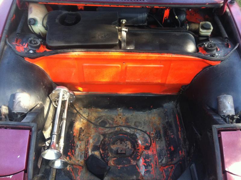

Longs are toast. Judging by the scale on the floorboards by the firewall I bet the firewall is ate up with rust. Font fenders and cowl are obvious. Hell hole is most likely rusty. Rear trunk has an obvious hole...more than likely will need a new pan. Rear trunk lid is shot. Hard to tell but looks like bubbling on the sail panels?
How is the front trunk?

wow, this is disappointing. in his thread most people said it wasnt bad, now that its mine you're saying its toast (IMG:style_emoticons/default/sad.gif)
(IMG:http://www.914world.com/bbs2/uploads_offsite/img.photobucket.com-16644-1387403604.1.jpeg)

Naaaa, it's not toast. It's rusty but not terminal as far as i can see.
All the parts you need are available from RD and if you're handy with a welder, this can be done.

once you cut out the rust, you will know better.
maybe the rust is isolated to the area closest to the jack points, if so, you'll be golden.
once you can see all typical rusty areas better, let us know how your rust compares to the rust areas in pics attached.

Holy cow. The step "-see what the hell hole looks like" should be taken before making a deal. I hope you got this heap super cheap and love metal fabrication, because you have a butt load of work to do.
I'm not raining on your parade - I would take on a project like this. I just hope you didn't pay much up front and you can dump a lot of money and work into it.

My concern is that you understand how to repair the structural parts. Fiberglass fenders will not fix what I'm worried about. Again, please don't mistake my words as negative or naysaying, but rather to please be aware of where your car is structurally weak and needs serious metal work.
The first concern is the hell hole...... The area under the battery tray and forward as it has eaten into the very important structural part of your car that you haven't yet discovered how severe it really is.
Please dig into this before starting the work on fenders.
