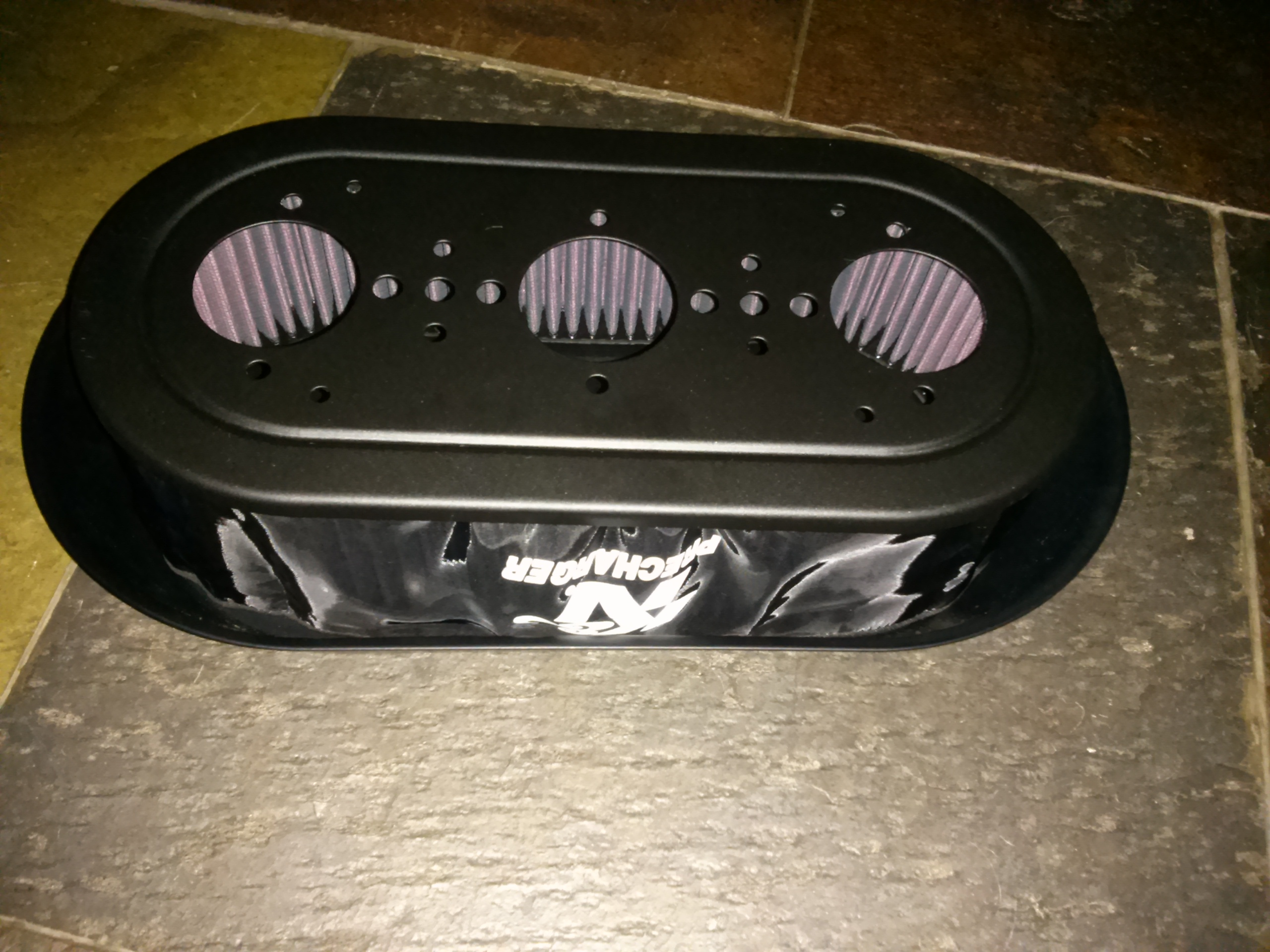

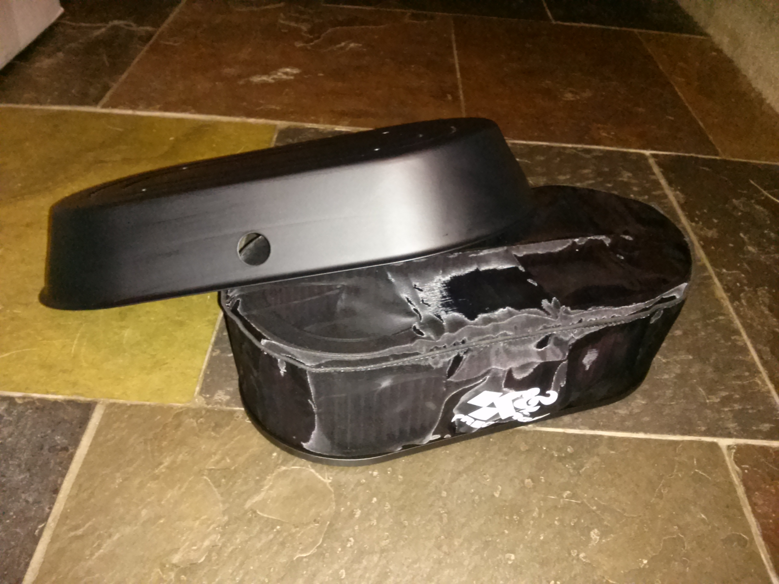

MATTYLITE
post Jan 22 2014, 10:49 PM
Posts: 104
Joined: 23-August 12
From: California
Member No.: 14,843
We built a single intake system, and a dual intake system (pictured) for this application. This system has been proven on the track with multiple Porsche Owners Club class wins and perfect for the street as well.
(IMG:http://www.914world.com/bbs2/uploads_offsite/imagizer.imageshack.us-14843-1390452573.1.jpg)
(IMG:http://www.914world.com/bbs2/uploads_offsite/imagizer.imageshack.us-14843-1390452573.2.jpg)
(IMG:http://www.914world.com/bbs2/uploads_offsite/imagizer.imageshack.us-14843-1390452573.3.jpg)
(IMG:http://www.914world.com/bbs2/uploads_offsite/imagizer.imageshack.us-14843-1390452573.4.jpg)
