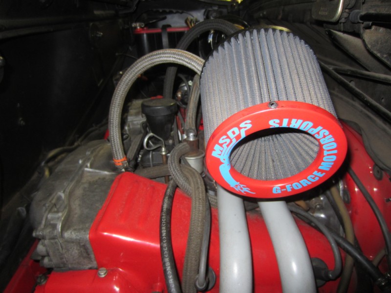

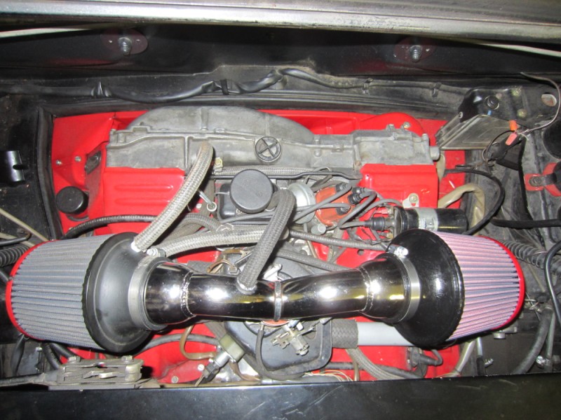

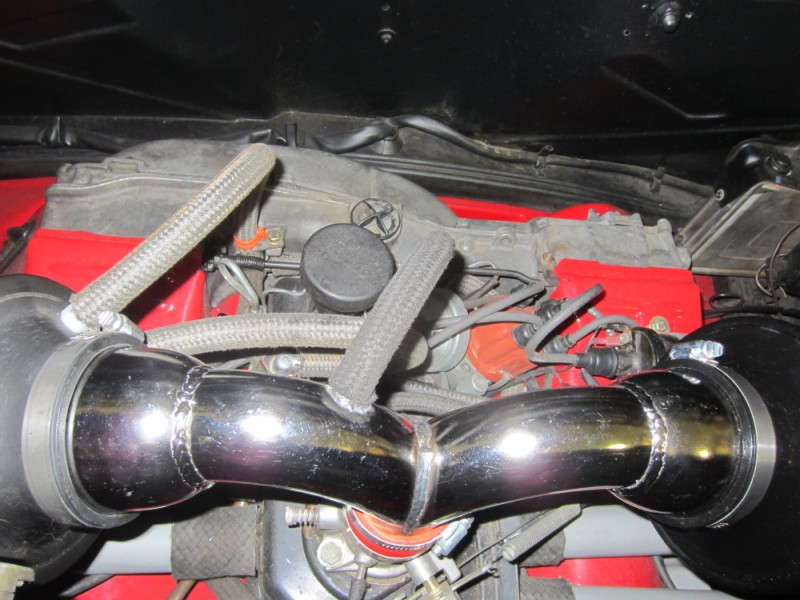

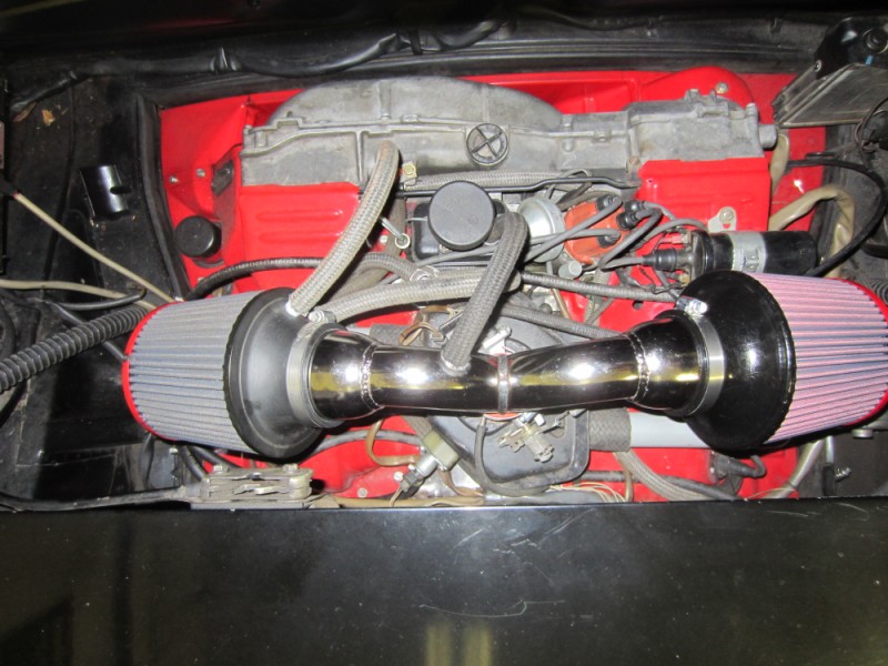

MATTYLITE
We built a single intake system, and a dual intake system (pictured) for this application. This system has been proven on the track with multiple Porsche Owners Club class wins and perfect for the street as well.
