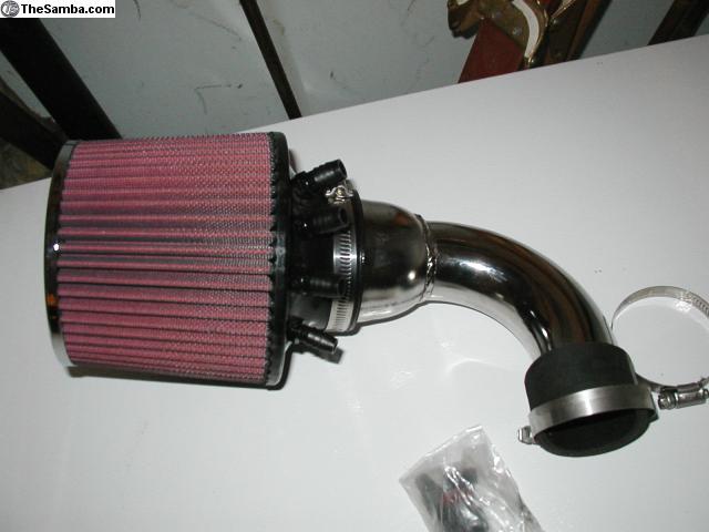

Will these affect the performance of a stock FI 2.0L engine negatively in any way?
Regards'
Jon

Jon,
Any of the lines forward of the throttle body are not vacuum - they're open to atmosphere. They should not affect FI performance. The only lines that can are those after the throttle valve.

QUOTE(Jon H. @ Jan 22 2014, 05:44 PM) *
I'm more or less questioning the vacuum line hook ups and vacuum effecting FI performance.
The FI doesn't really care exactly where its lines are hooked up. It just needs specific hoses to either be hooked to manifold vacuum, or to ambient-pressure (filtered) air. So as long as you hook up the hoses that used to go to the air cleaner to something "upstream" of the throttle body, you're fine.
(The exceptions to only manifold vacuum or ambient air are the lines from the throttle body to the distributor dashpot. But those don't enter into this discussion anyway.)

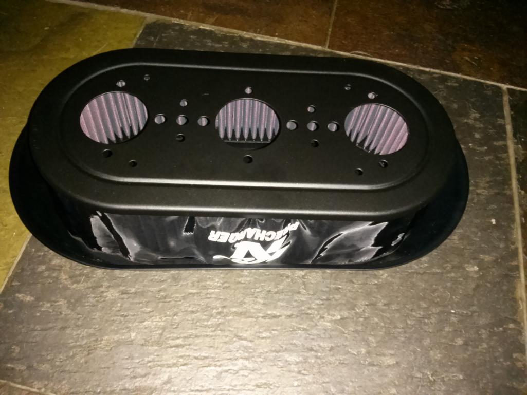

I ran K&N's on my 72 with 44 Webers and had a lot of issues with clogged idle jets so I added the K&N pre-chargers and that solved my issues. I'm going the same route for my -6
