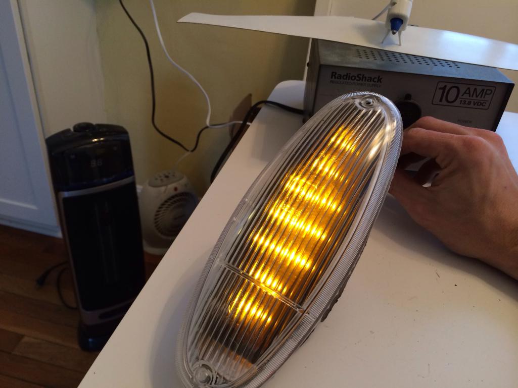

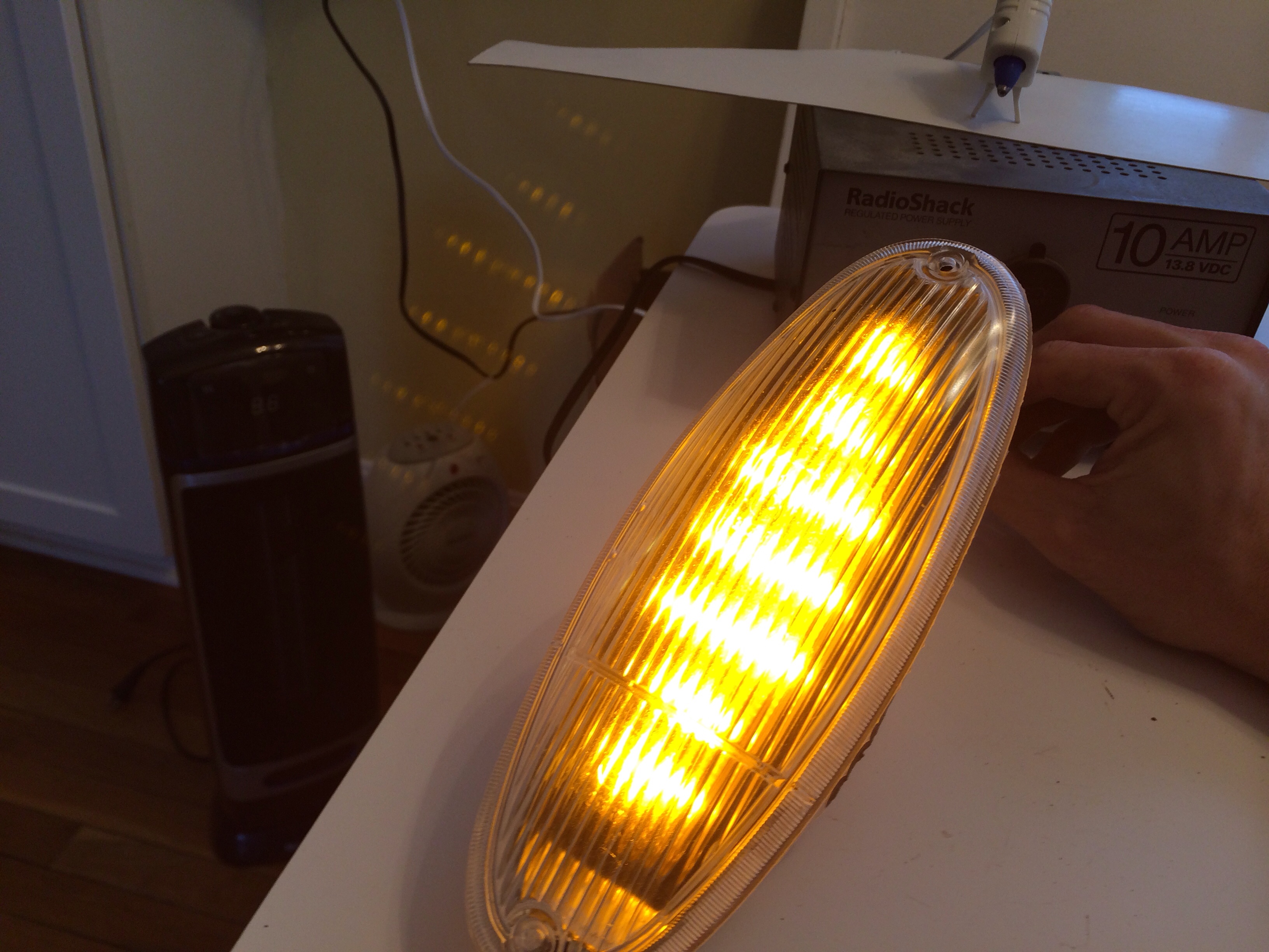

Because the screw holes on the mount go all the way through, you can just screw it back on to the back side. The whole thing mounts up perfectly.
Eventually, I'll also re-incorporate the stock electrical hookups. But that's a "nice to have" and I'm sure some enterprising chap will start making up kits for something like this pretty soon, but really we're only talking about 15min of work here. (I left my soldering iron at the office, and need to break this all down anyways...so I didn't take it too far.)
CptTripps
post Jan 25 2014, 01:42 PM
:: Punch and Pie ::
Posts: 3,585
Joined: 26-December 04
Member No.: 3,342
And here's what it looks like with power. You can tell the difference between the running and flasher. Very visible at any angle. More so than the stock bulb I believe.
In the end, I think I have $25 into this project. That's pretty cool of you ask me.

Question...(edited so it made sense) I was looking at both the amber lens and clear lens LED setups on e-bay as Dan pointed out...both have amber LEDs...does it actually matter which we use with an amber stock 914 outer lens (IMG:style_emoticons/default/confused24.gif) ? Thought it was best for the LEDs to be the same color underneath the outer lens... Paging Spoke...
CptTripps
post Jan 25 2014, 07:52 PM
:: Punch and Pie ::
Posts: 3,585
Member No.: 3,342
I've still got my amber lenses. I'll throw them on tomorrow and take another vid to compare.
