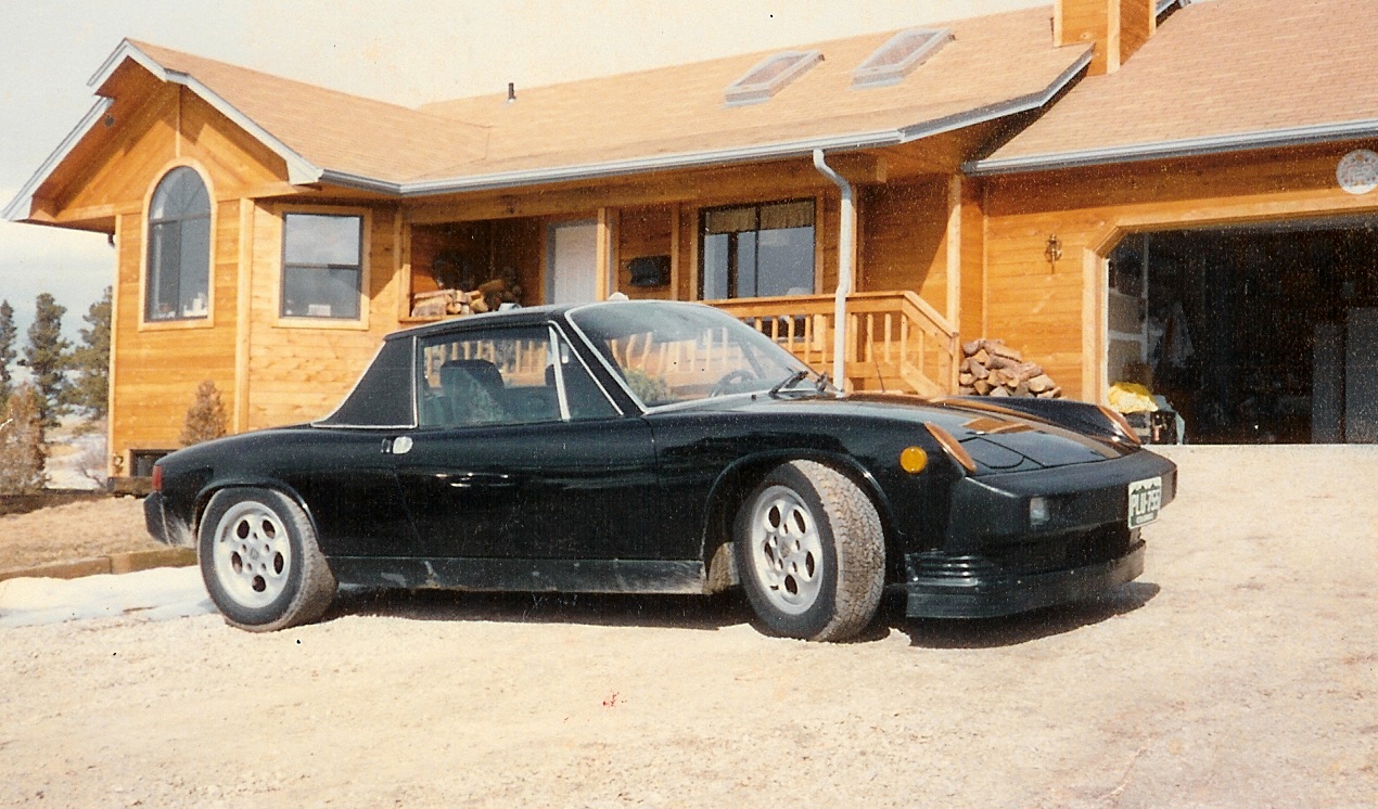

(IMG:http://www.914world.com/bbs2/uploads_offsite/fbcdn-sphotos-e-a.akamaihd.net-1110-1405559348.1.jpg)
(IMG:http://www.914world.com/bbs2/uploads_offsite/scontent-b-sjc.xx.fbcdn.net-1110-1405559349.2.jpg)

I ran 215's on 8's but I had spacers and flares. I know what you mean about "the look" That vintage stance. tires with sidewalls that are tall enough to look tucked without removing all the suspension travel.
I had tires from the tire rack. I put them on Sandy's 14 and didn't like them. I went back to the tire rack the next day to order another set. Instead of making me eat them they took them back. dis-mounted them ands mounted a taller set no charge.
I mention this because if you ask ahead they my do that for you as a test fit. It's worth a shot.
